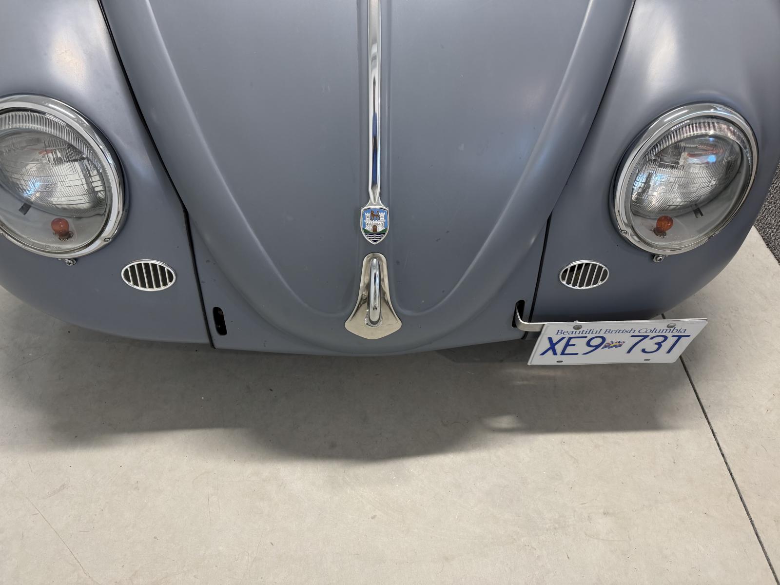

My car does not have the holes for the overrider bows and I am undecided on which bumpers to go with. Has anyone mounted the overrider style without the upper supports. Will they sag is the lower bracket enough to keep them in place. I like the option of being able to change bumpers down the road and not having the holes.

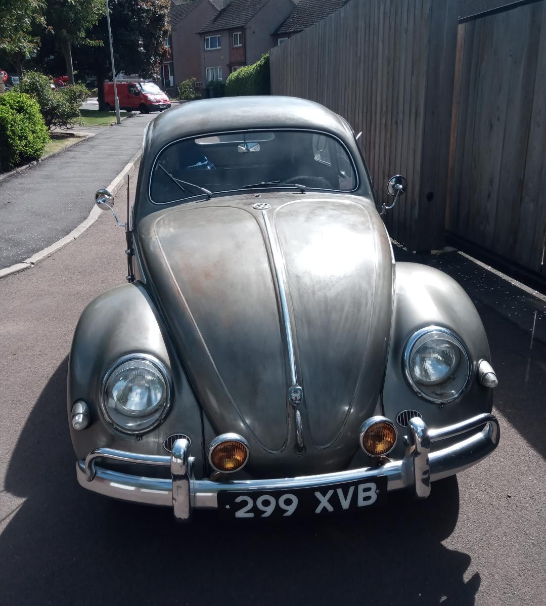

you should be ok mounting a towel rail set-up without the extra bracing through the valence. I've had a couple of cars like this (in uk) so provided the main bumper mounts are solid it's fine. the upper supports are there to take the shunt force during a parking prang.
this is a hybrid set-up on the oval I had
