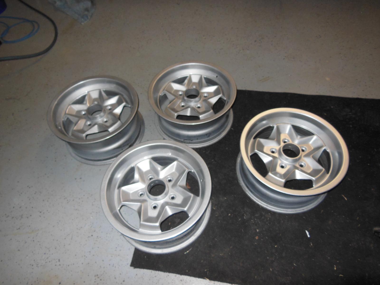

I also spent about 40 hours cleaning he wheels. It didn't look like anyone had touched them since I sold the car 23 years ago. Here is a before and after.
And After
the camera wouldn't focus on the shinny wheel but you get the idea.
Here they are installed.

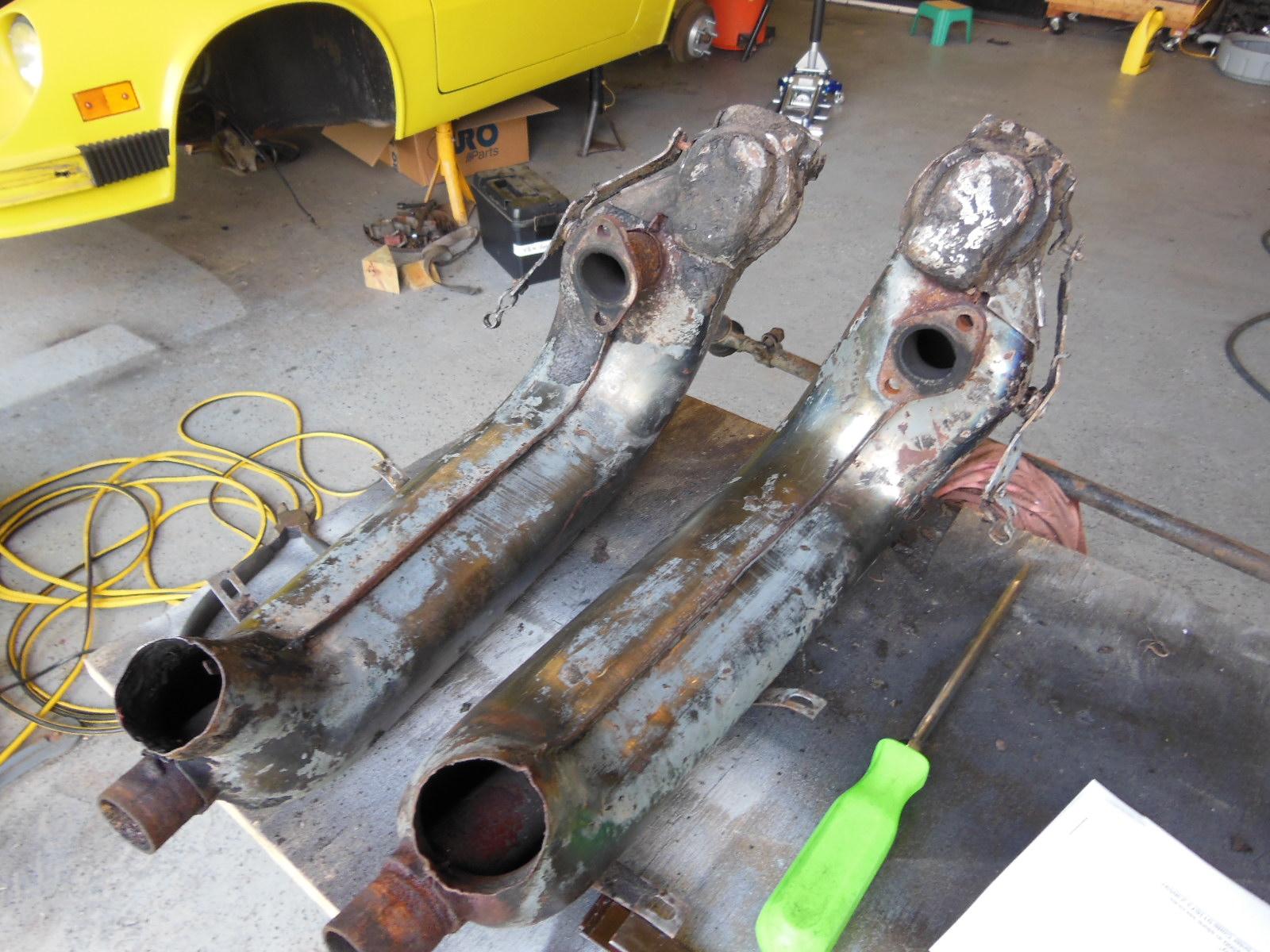

I had to pull the front rubber strip off to get the front beam out and this is what I found.

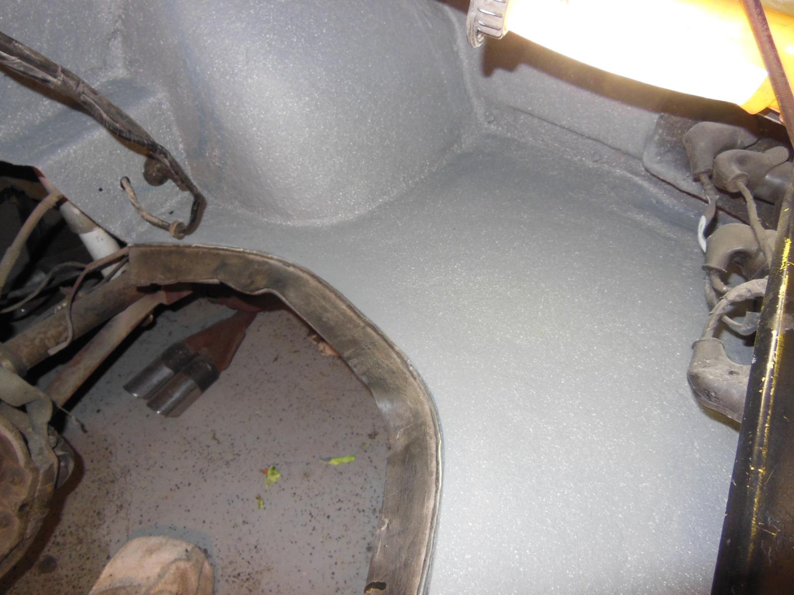

Spend the whole day working on the Puma. Things are starting to go back together now. I have the trunk and engine bays painted, the front beam is back together waiting to go back in maybe tomorrow Very Happy , and the engine is taking shape with all the tin back on ready to go back into the car.
I decided to change the engine bay and trunk color from black to gray with the speckle finish. The black made them both seam like caves.
Here is the front beam ready to go back in.
