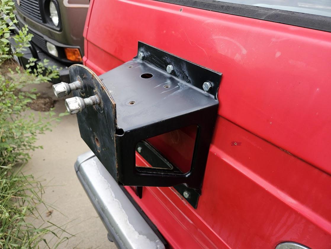

On my red van, the previous owner bolted a Smittybuilt jeep spare tire bracket on the rear hatch.
It bent and dented the sheet metal and ripped some of it away from the internal bracing.
You can see some of the denting here:
I would advise against it, but if you do it make sure you have some kind of internal backing plate. Although that's no guarantee against destroying the panel.

No bueno without significant bracing inside the liftgate.

This is exactly what I was looking for. I’m sorry about your van but I appreciate the response!
