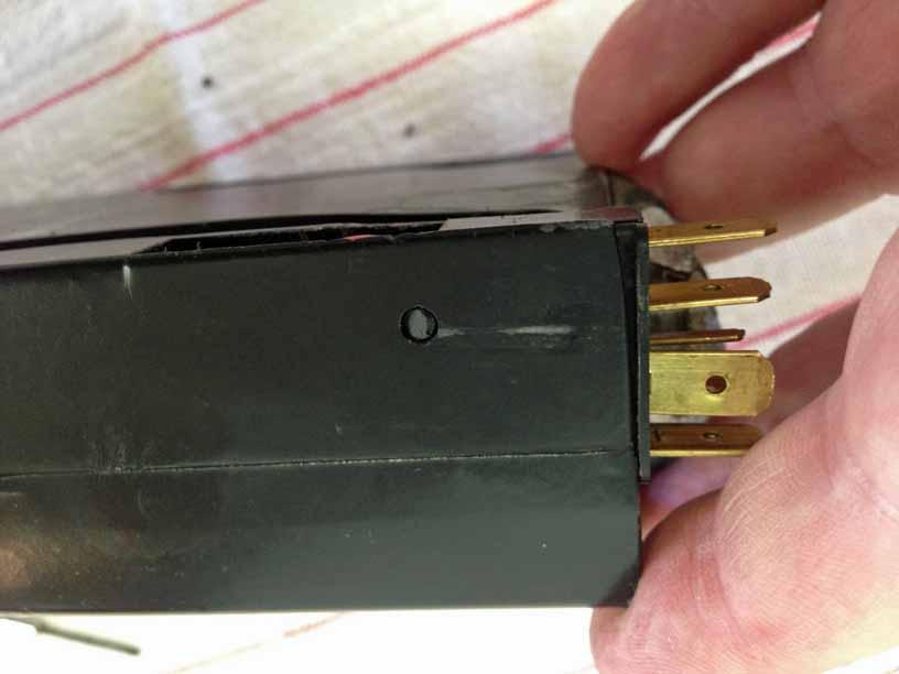

8) Remove the two Phillips screws holding the plastic cover over the bottom of the housing. Next remove the two hex-head cap screws holding the housing to the body of the car. There is one more capscrew holding a built-in clamp of the housing to the steering column; loosen or remove it. At this point you should be able to yank the whole column assembly back and off the steering shaft. Here’s the part number if this also-1971-only part(!):
Don’t be surprised if your clamp portion is cracked or even broken free of the main column housing. Fixing that, or the shear assembly, is beyond the scope of this thread, but may be covered later separately.
9) Now on the workbench, inspect the housing, and note the MPC holding the ignition wires at the bottom corner of the housing:
Look carefully at the little circle below.
It is part of the MPC plastic housing and this holds it in place, so you don’t want to break it off!

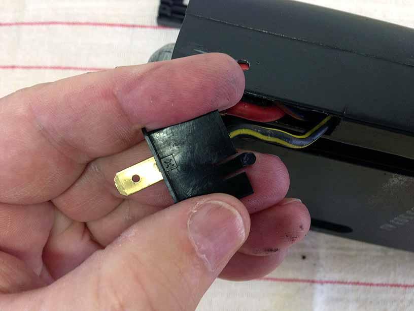

10) Now you have to remove the plastic housing of the MPC and take it apart. Press the little circle and slide the MPC to the side (NOT straight back—it wont go that way). It may separate into two pieces like this one did.
11) Pull the two halves apart like so:
Note the wire colors while the wires are still in the little slots of the plastic MPC housing. Check my pictures carefully and be sure they match.
12) The X-terminal will be engaged in one half:
This is removed by inserting a small jewelers screwdriver as follows, while then tugging on the tab to unstick it, then push it inward towards the wire end and slide it out of the plastic holder.
By the way, this general removal process is used several places in the car for ‘captive push on terminals” such as in the headlamp socket and the FI connectors.
The other wires can now fall out of the slots in the other half.

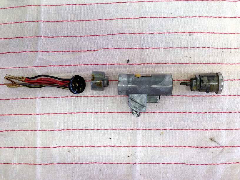

13) Pop off the little plastic caps over the screws holding the little retainer for the ignition mechanical switch. Remove the screws, and remove the holder piece.
14) Now you use the Bentley procedure and insert the ignition key and slightly turn it, which will soon allow you to pull out the switch assembly towards the key end. Press a jewelers screwdriver into the little hole in the housing, grab the key and pull back. With all those wires, you may need to push on the wire end as you pull on the key end. Eventually it should all be drawn out of the column housing.
15) …if you are lucky, that is. If you are unlucky like I was, this now breaks the electrical part of the switch, taking half of it with the mechanical switch, and leaving the other half inside the column housing. No matter, we are replacing it anyway.
Here are the removed parts of mine, laid out on the bench. You can see the two parts of the broken electrical switch at left.
Get all the pieces out the key end, then remove the tiny screw that holds the electrical part to the mechanical part.

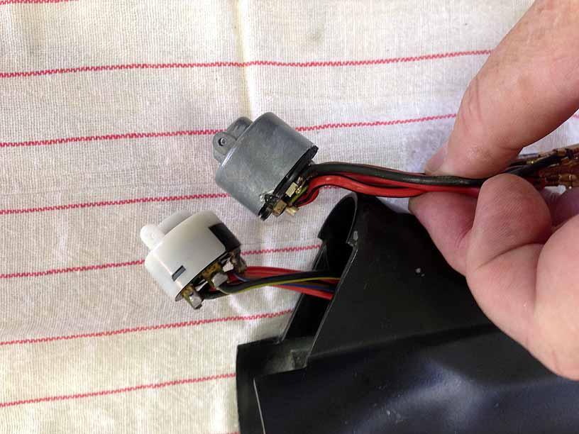

16) So here are the old and new switches together:
Here are the wires:
If you choose to make it stock, you will be cutting these wires, crimping on OEM-style locking connectors, and futzing with the two tiny ones. I salvaged the little male tabs using a knife blade and tiny screwdrivers to open them up and manually crimp them onto the new switch wires.
If this scares you, then skip all the steps below about the MPC and just run the wires to the various connections the body (female) half of the MPC leads to.
17) After you cut and crimp all the wires, you assemble the mechanical and electrical pieces together, lining up the tiny little hole on the mechanical part with the threaded tab on the electrical part. Insert the special stepped screw, and tighten it very carefully. Now insert the whole assembly, wires first, into the column housing. A little lube will help. Electrical tape holding the wires together may help keep the spade ends from catching on the guts of the column housing.
18) Now that the wires are accessible again out the back end of the housing, set them into the two halves of the MPC housing like so:
It takes some twisting and bending of wires to get them to stay in place in the one half, and you push the X-terminal tab through the other half. It matters if you have them twisted 180 degrees out of correct; you won’t get the MPC back together if you get it wrong.

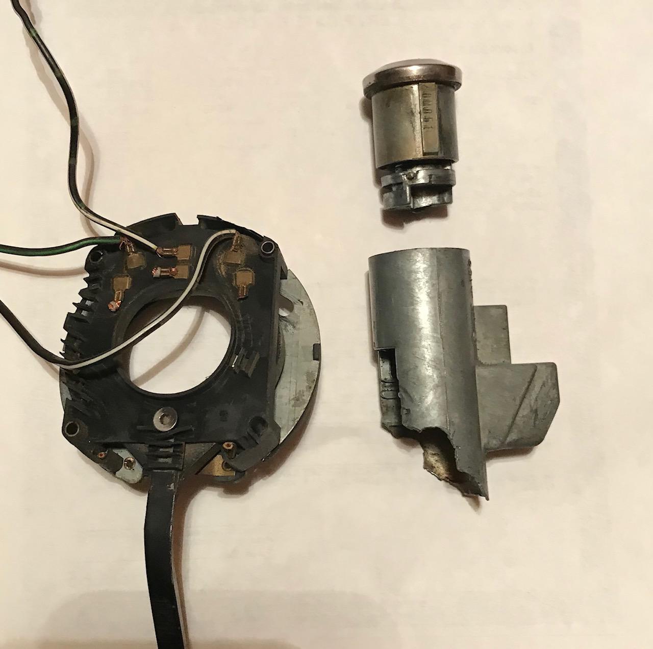

These are the pics of the turn signal/headlight dimmer switch and the ignition switch (or what is left of each). As you can see, the wires have been cut on the back of the turn signal switch, and the housing for the ignition switch has been broken off at the end. The ignition key switch is missing the tab needed for the ignition wires, and someone put a penny over the key hole. There are no wire connectors of any kind left. The part number on the housing is 111 905 851 L. I'm not even sure this is the right one for my car. The steering lock (which is also missing) is round in this one and looks square in the pics in the post above.
Where can I find the correct housing for the ignition switch?
KTPhil Premium Member
Joined: April 06, 2006
Posts: 35832
Location: Conejo Valley, CA
KTPhil is offline
PostPosted: Fri Sep 28, 2018 9:13 am    Post subject: Re: Replacing 1971 ignition electrical switch Reply with quote
Wow, that has really been hacked. You may have better luck changing out the whole column assembly intact, rather than piecemealing almost everything.
Lately I've seen a few '71 only turn signal switches from the classifieds, maybe $150 or so, but I'm not seeing them now. But you need the column, too, so that's just the beginning.
