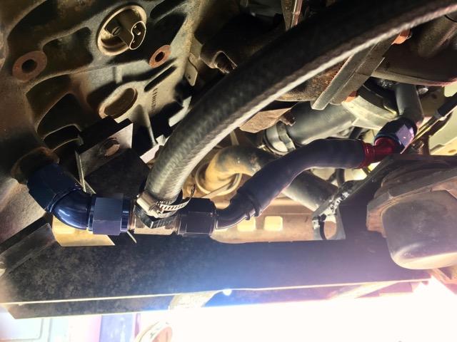

Posted: Thu Nov 14, 2019 6:27 pm Post subject: Nice turbo! |
Okay, I recently put this on my mTDI build (AHU, DLC764 nozzles, 12mm pump from Karl)
I built adaptors for the trapezpoid and plan to build some for the triangle which allows for not modifying the turbo (warranty) or manifold.
Previously I was running a K14 turbo, which this GT2052 spools WAY quicker! It spools around 5psi below 2k, but doesn't wake up till after 2k RPM.
I'm currently pushing 20lbs out of it with lower EGTs than before. I can't seem to get more than 20lbs which makes me think I need to upgrade my airbox for more air or adv the timing some. I'm at 1.05 currently.
The last test I did today was a 6% incline on a highway between Lake Havasu City and Kingman, AZ on the I-40. I was going 20lbs up it around 80mph with EGTs around 1100F.
This is my fourth drive and tweak of tuning. I am hoping to reduce the EGTs a tad more at 20lbs. Then do my airbox upgrade idea then adv the timing. Shooting for mid 20s boost.

The oil return off the engine looks like this. The hose off the tee is the Mann Provent 200 with the check-valve installed.
