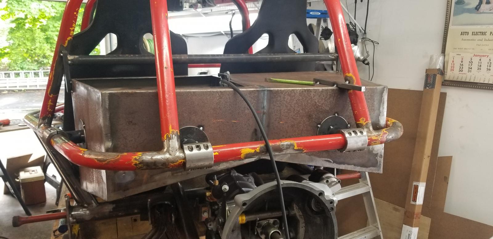

Got my fuel tank/Trunk mounted

I finally got my fuel tank/trunk combination mounted in the rail. Next step is to start mounting the electronics and getting everything wired. I forgot to take pics after the final welding. I did have to cheat and cut the very bottom corners off the tank to be able to get it out. I probably only lost a few table spoons of capacity so I should still be around 12 gallons for each side. The passenger side is the fuel tank and the drive side is the trunk. I need a name for this thing. Like if you have a front trunk you call it a frunk. Maybe a funk, fuel trunk.
