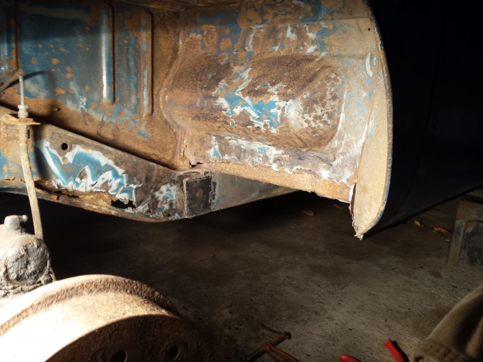

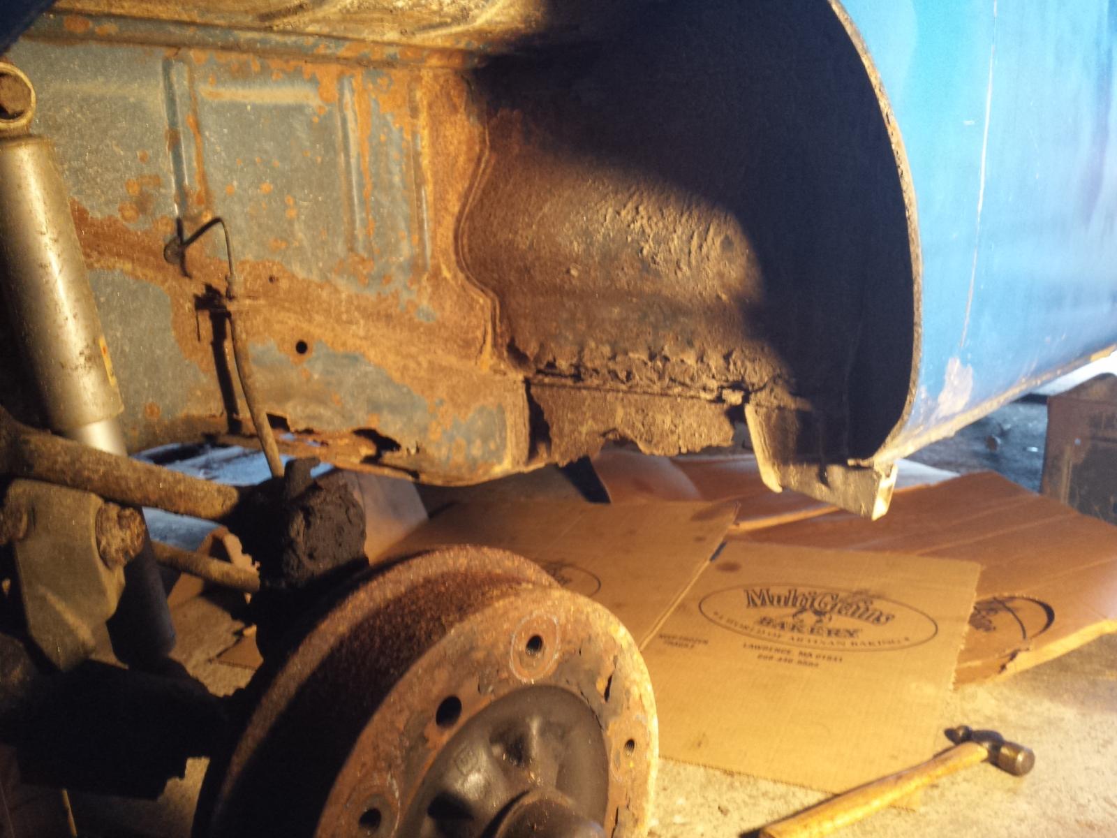

Very cool bus. What are your plans to repair the frame in front of the beam mount? I can see it's bad in this pic
I have been looking on here for that piece to buy but they seem hard to come by. I'll try patching it with new sheet metal first. There isn't anything that's it over the top gut wrenching on this bus. Just some nasty stuff.

PostPosted: Tue Jan 20, 2015 3:56 pm    Post subject: Reply with quote
The frame peice is out there both new and used. I just did mine with used outside and new tractor supply metal for the inside. I do know of a used frame around here cheap if you need one.....

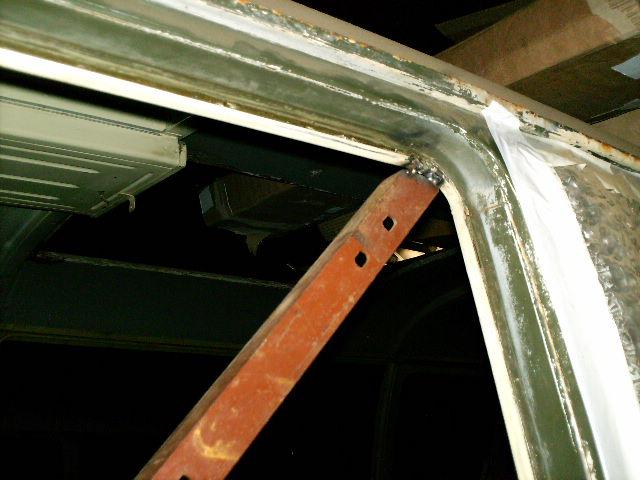

Here are a couple pics of the frame rail area on my bus I replaced
You may want to brace at least the driver's side cab like this:
Stagger the cut on the inner and outter sections so they are not in line with each other for strength. I also used a notched cut and fit the rail together like a puzzle piece for extra strength. I have a pic of that somewhere.

PostPosted: Tue Jan 20, 2015 6:10 pm    Post subject: Reply with quote
Clay, I'll let you know how my patch metal from home depot comes out. If its not lining up good or is too many pieces I'll give you a call. I appreciate your help.

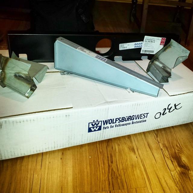

shipment number one has arrived.
Waiting on word to figure out what to do about the frame.
I agree with all of this^^
This is how I notched the frame replacement on my daughters 66

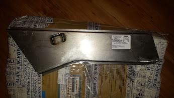

received this chassis part for Allan Scholfield INC in the UK to fix my chassis.
Excited to get out in the cold today to get it ready.

PostPosted: Mon Feb 09, 2015 5:27 pm    Post subject: Reply with quote

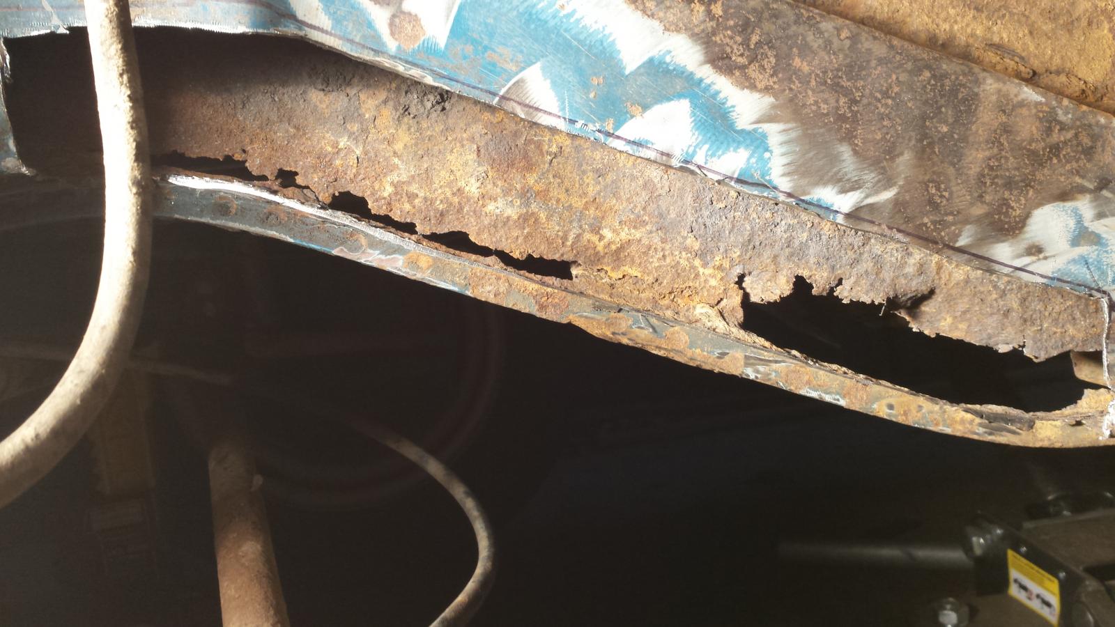

some removal of rust was done today and some test fitting.
Cleaned up a bit.
metal from A.H. Scholfield
Placed up to draw a line for removal of metal
what needs to be cut
What the cut out looks like
still need to do some grinding but the cold was getting to me today.
