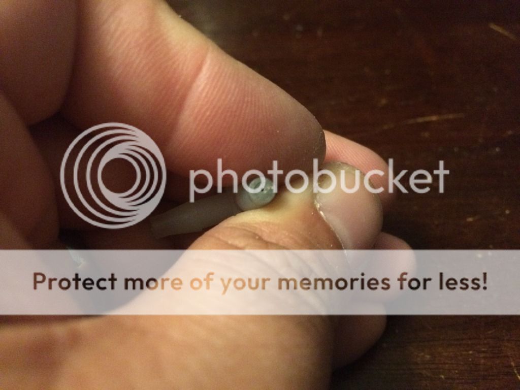

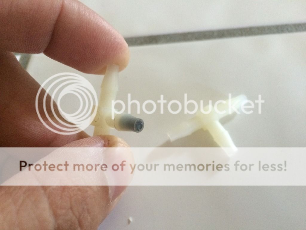

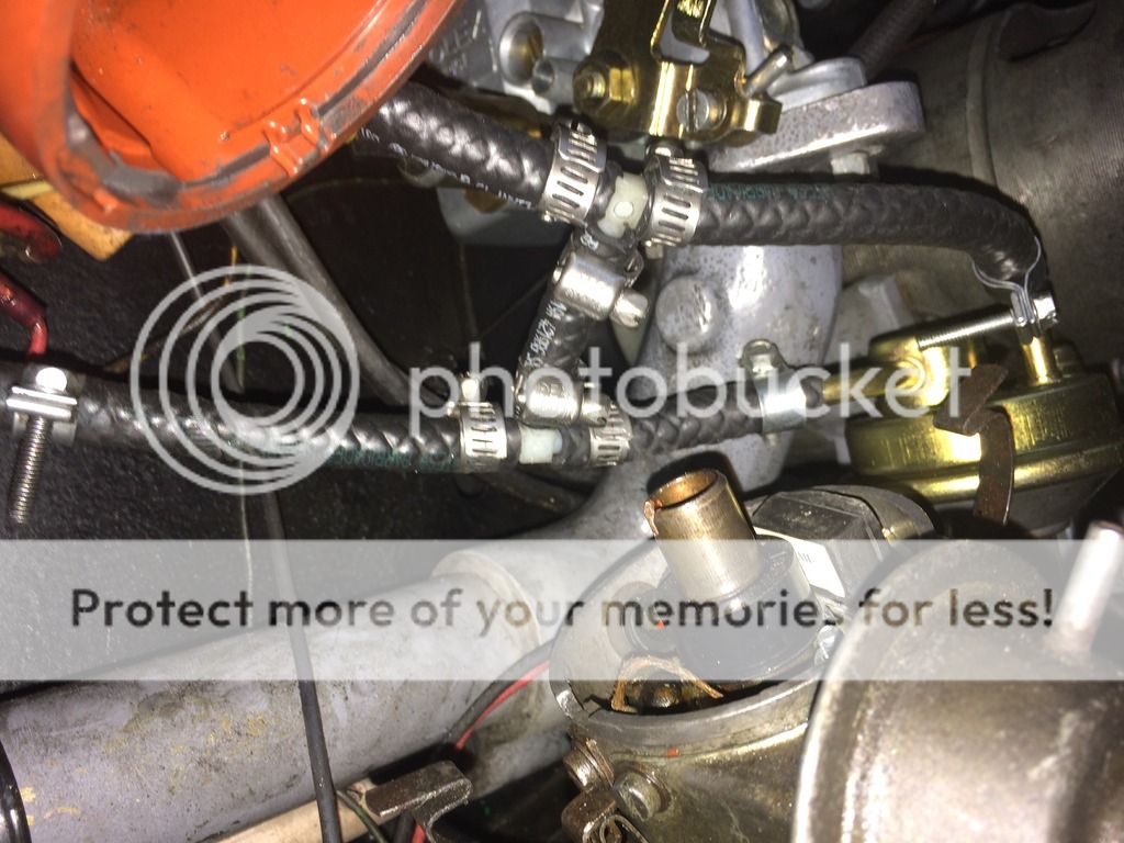

PostPosted: Wed Mar 18, 2015 11:07 pm    Post subject: Reply with quote
Ok, I've reached my boiling point... This needs to be solved.
Here is my first experiment.
A tee before the pump and after the pump. The tee after the pump has the return end filled with JB weld and I have drilled a #76 (0.5mm)hole through it to releve pressure back to the tank line. If it works I will have to make it more elegant. Right now it looks like a hose clamp bomb. And is a fire hazard...
I will report the results.

PostPosted: Wed Mar 18, 2015 11:16 pm    Post subject: Reply with quote
Oooooh far out. I dig it. Let us know how it does!
The original VW one on this page looks like it is a fuel pressure regulator, that just sends back any excess pressure. Is that in the right direction?

PostPosted: Wed Mar 18, 2015 11:25 pm    Post subject: Reply with quote
Although the installation looks similar, I'm going in a different direction than the original valve.
This was part of the inspiration.
http://www.thesamba.com/vw/forum/viewtopic.php?t=389630
I just want to bleed off the pressure that builds in the line after the pump after the engine is shut off.
69 Westy

PostPosted: Wed Mar 18, 2015 11:34 pm    Post subject: Reply with quote
Ahh I see the similarities. But I think as our fuels boil and increase pressure, the stock valve would have the same effect, through a different method. Yours would bleed 100% of the excess pressure off, while the stock would only bleed off anything over a set value (probably close the the 3psi of a good pump.)
