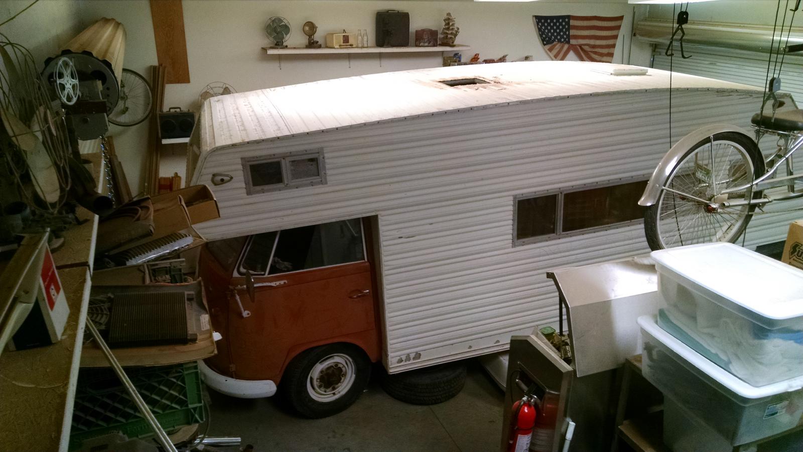

The date was Sept. 14 2002. I was attending my first Jerome Jamboree in Jerome Az. and I stumbled upon this bus. I instantly fell in love and only had the ability to take a picture. Here he is...

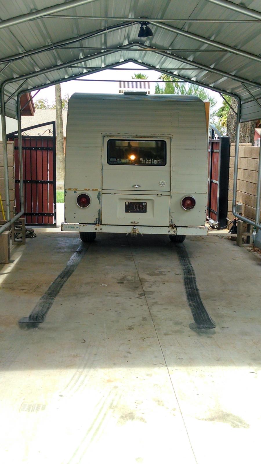

Long story short, 4 years later Im working for a guy and I get invited over to hang out and lone and behold here sits Fubar (his previous name) Sitting among some of the coolest VWs Ive ever seen. Fubar has a Rancho built trans with RGB's and a 2275 motoring this beast down the road. After 11 years of asking my persistance paid off and Fubar gets a new home. My 2 girls and I have been camping in the Baywindow i bought in highschool for years, we do a lot of camping and this ol boy will provide us some much needed room and we will provide years of love and attention.
Here he is on his way home.

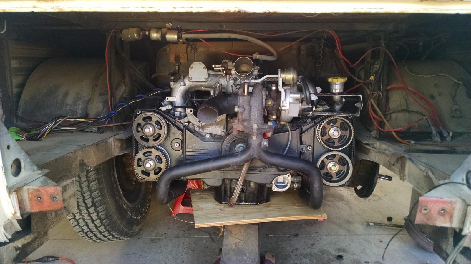

Did you do the Suby conversion or was it done already? People hate it, make fun of it, but it's the best of both worlds... power to push a bus, cooling to drive under all circumstances and did I already say power? I'm looking for more information on the mod.

The Original 2275 stayed with the PO, it was ready for some internal maintenance and I wanted to travel down a different road and throw some wild conversion in it.
So I found a JDM 2.0 Turbo with Links ECM

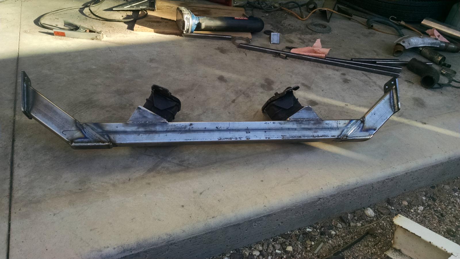

After the Trans was back in I started the fab work needed for the conversion. First order of business was the cross member. I used factory Subie mounts and build the cross member out of 14ga 2x3 steel.
With the subie weighing in at 40 Lbs more than an VW i wasn't worried about static weight but rather the twisting on the trans. Rubber isolation for vibration but held in with plenty of support.

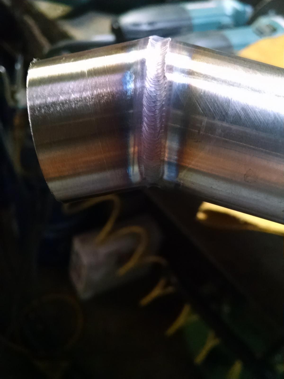

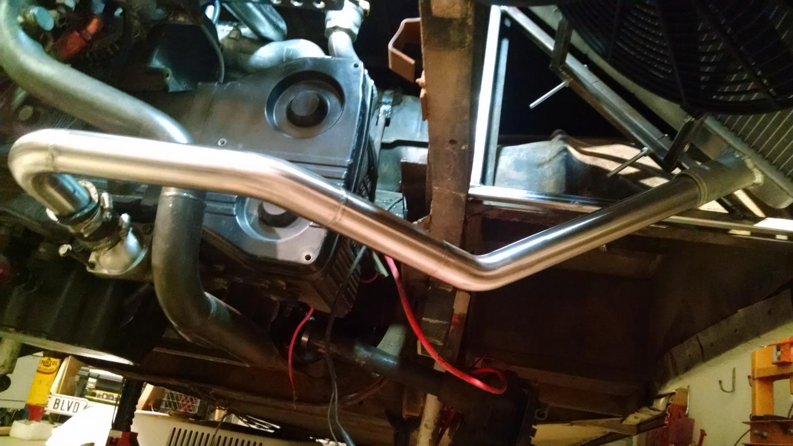

next up came the plumbing. All boost and radiator plumbing is 304 Stainless Steel .065 wall polished in and out. I had to get used to walking the cup on a purged line. I quickly realized the dig was from working to slow. After some practice I got it down pretty good.
Here you can see the "dig" or "undercut"
After some practice.....
here is the inside... This was my first purge weld. I got better as time went on Everything was argon purged with a diffuser

Upper Boost tube
Lower radiator line
Upper radiator connection, I had to get creative on the hose. Spent a lot of time in the narrow isle at Autozone scouring through hoses.
Intercooler for.... well you know, Oil cooler sitting there will have a fan and thermostat. I think thats the VW in me always thinking about oil.
Plumbed
