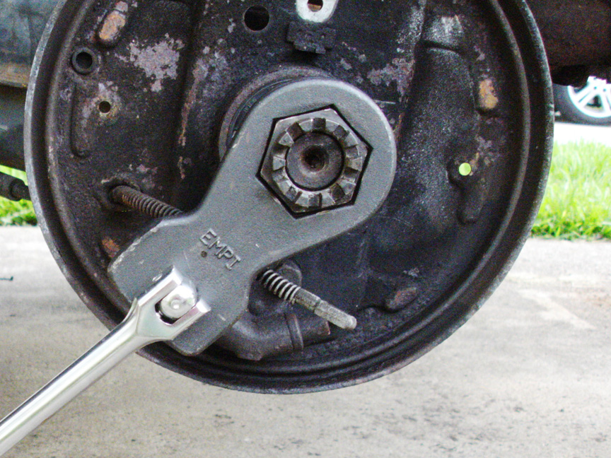

I use the Empi axle nut tool and a maul. Works great but you have to watch out for the paint on the wheel and the fender.

Empi style tool. We broke a 1" breakerbar without one trying to get one of ours off. The problem is that you need a shear force spike to start it and only something that you can keep pressure on and at the same time put a good blow from a hammer into works.

That Empi tool or one like it is the only way I know to get a really strong whack into the nut.
