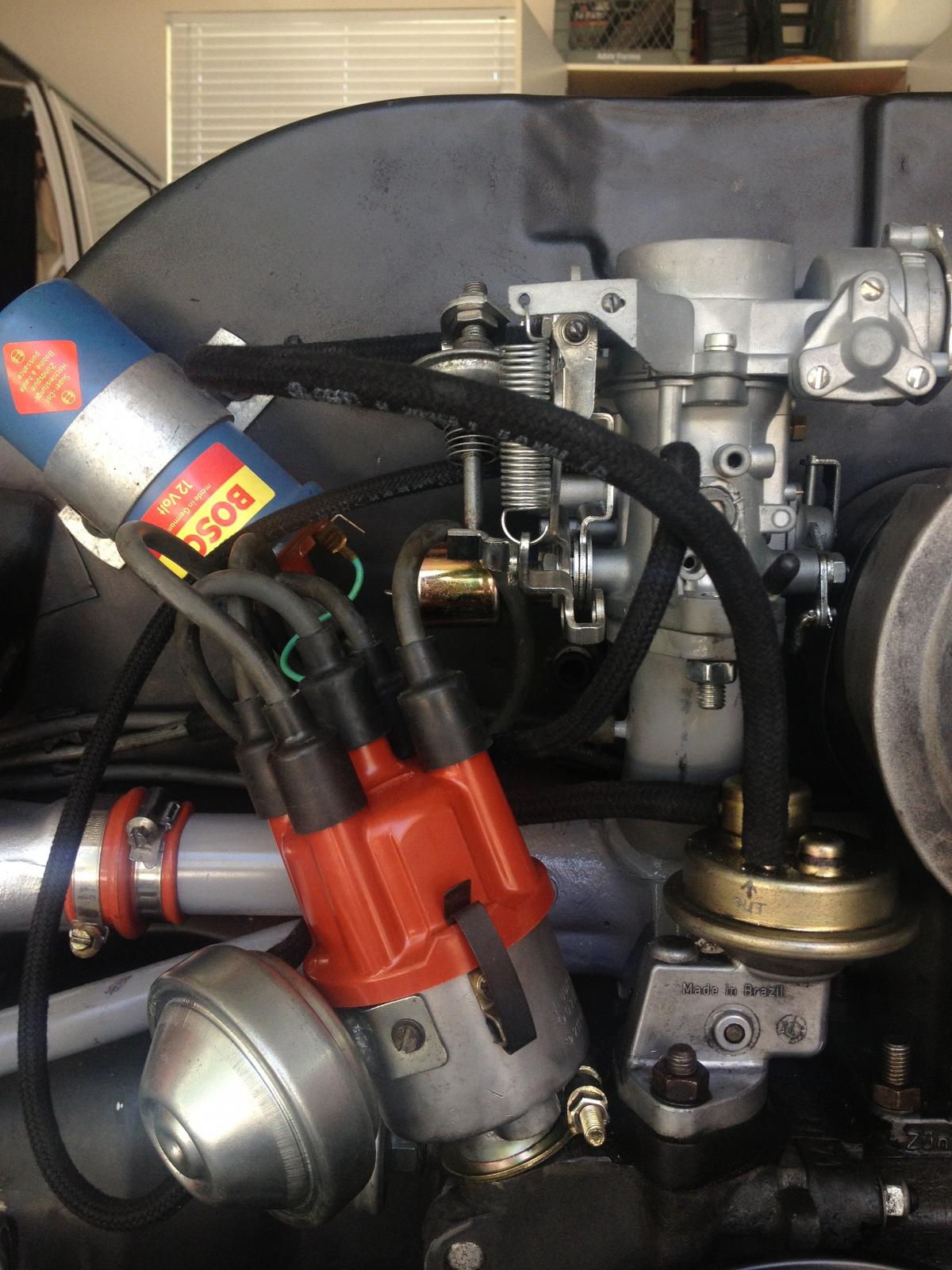

Here is my top end a few years ago; it's the only clear picture I have of the fuel lines. Note, the distributor advance line should be a metal pipe with a droop in it, and I have a vacuum retard line as well. The fuel line does not touch ANYTHING so it does not chafe. Just like the heater hose, I leave a little extra length so there's a little inherent spring in the line. This relieves some of the tension on the carb fitting, which on mine is threaded into the carb and flanged so the line can't pop off. No engine fires for me.

Robbie
