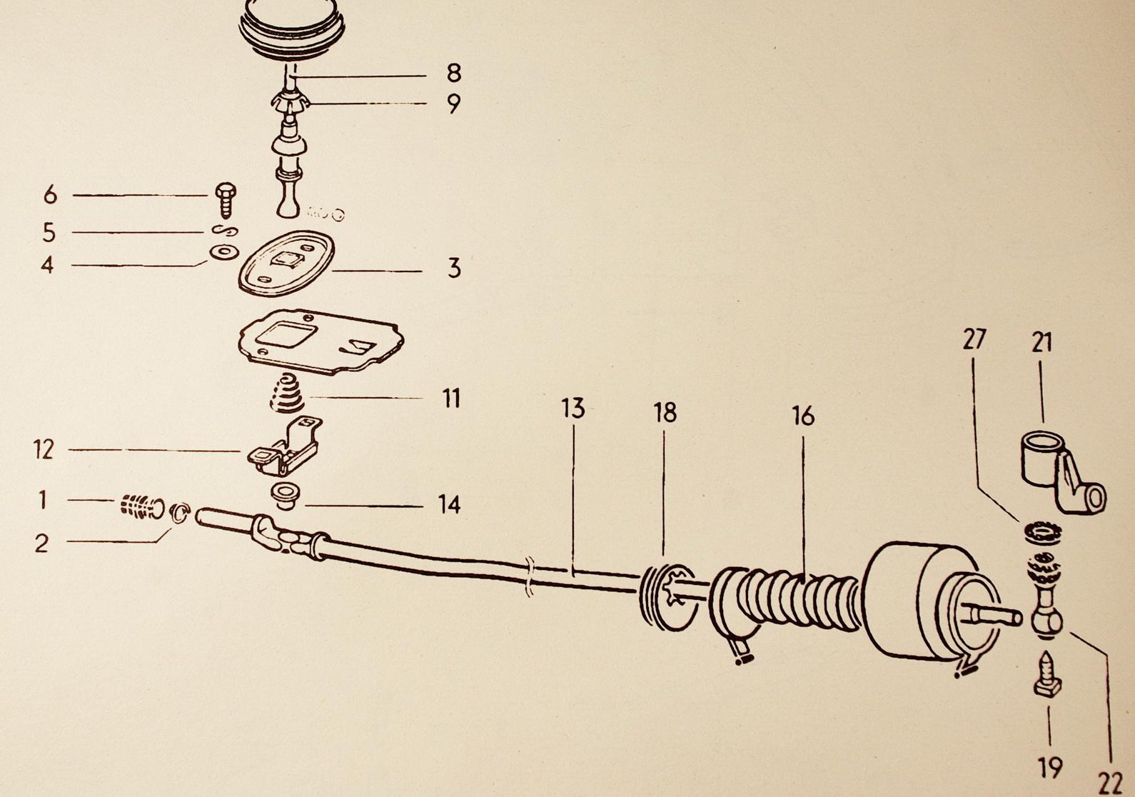

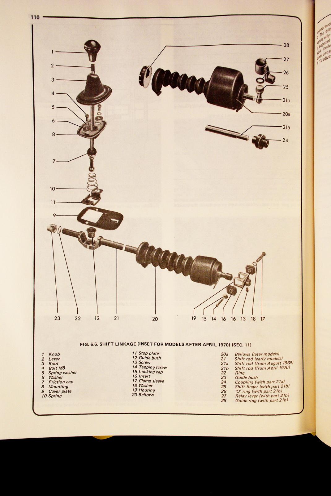

This is all three of the shift couplings laid out together. This is NOT the complete shift linkage….just the fore and aft linkage couplings.
This detail shows the very earliest 1968/69 linkage. It looks just like type 1 but required a solid rear cross member mount for the transmission tail cone very similar to the bus.
This shows both of the later shift rod arrangements. The straight through one with the cylindrical coupling parts # 24 and shaft # 21a are the April 1970 model parts. They still had problems with driveline realignment and putting tension on the shift coupling….which wore out other parts of the linkage.

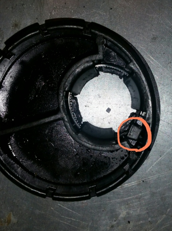

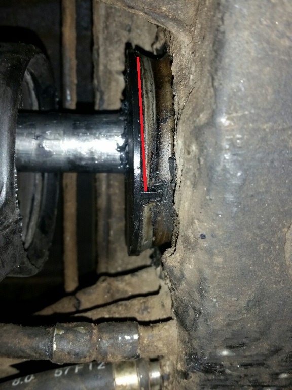

This plastic disc/plug….is the rear bushing for holding the rod travel in one plane and not allowing any X and Y movement.
The body tunnel plug/bushing is item # 28 in this picture

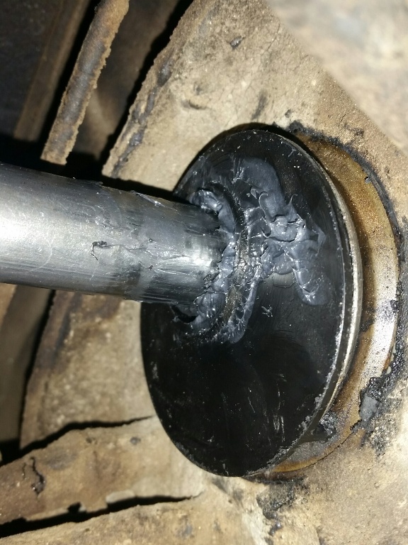

If the tunnel plug/plate is cracked, heavily worn or missing…..the tube section of the slip joint in this picture slips downward on the ball. The tube section is attached to the forward shift rod and the ball stud on the right is attached to the transmission “hockey stick”/shift rod.
SERIOUS NOTE: In this picture, look to the left and notice that the plastic Tunnel Disc is MISSING…and in the picture the tubular section of the joint is far too low on the ball stud. The car in the Haynes manual will grind going into every gear every other time. This is the importance of this tunnel plug/bushing disc.

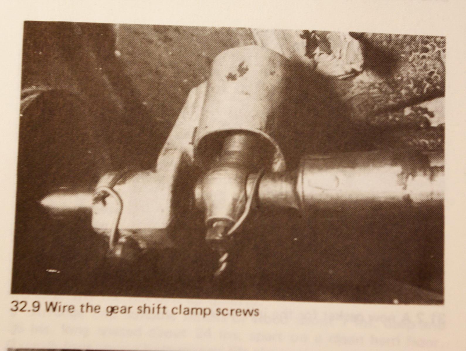

The 2nd section is the shift rod coupling unit itself. It must be tightly gripped on the shaft(s) and safety wired on. It uses two 8mm pointed end grub screws. The coupler sleeve from the forward side must not be bent or crushed or misshapen in any way. The ball stud should have a nylon ball cap and a rubber bumper O-ring around the middle groove on it.
Items that cause these two parts to malfunction are a worn or bent tube coupling…usually from owners getting poor shifting and beating on this part. If you look inside of the tube coupler and it has heavy wear indentations in it…..if you can measure how deep they are you can gently squeeze the sides of the tube coupler to bring it back into just exact contact with the ball stud.
The tube coupler is “squarish”. The fore and aft sides and the left and aft sides of the coupler should make gentle contact with the rubber O-ring around the mid-section of the ball stud.
The ball stud is item #25 in the picture and the O-ring is item #26.
Next point with that in mind, typically the rubber O-ring around the mid-section gets rotted by grease and grime. You can replace it with a flat washer cut from rubber inner tube if you cannot find an O-ring that fits into the groove.
NOTE: If you have the very early or April 1970 on, as long as your shift coupler and forward segment bushings are intact…you have nothing to worry about in segment #2.

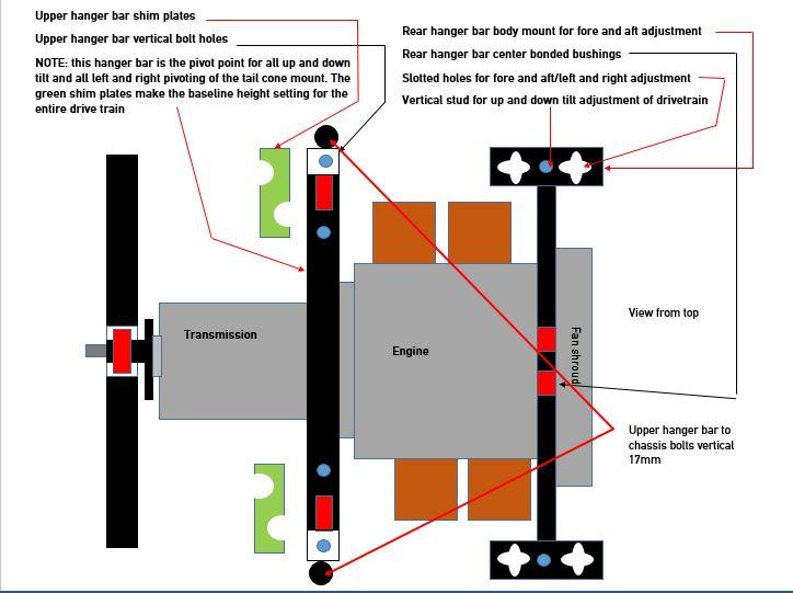

VW put in plenty of adjusters for this. Let me outline them for you. From most forward to the rear of the car.

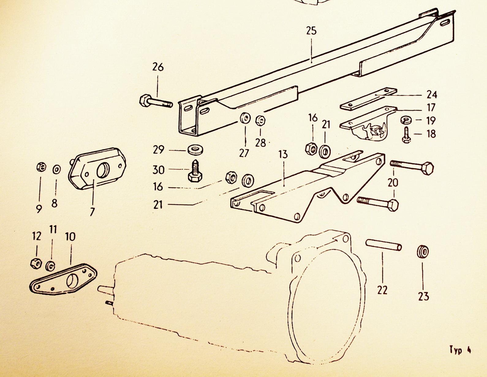

This are what we will be calling the upper transmission support cross member. This carries 90-100% of the weight load of the engine and transmission. Notice part # 24.
These shims are on both sides, about 2-4 per side. They adjust the up and down level position of the drive train and the centering of the tailcone bushing in the socket in the rear cross member.
Notice part # 26….the bolt and the slotted holes it fits into in part #25. This allows you …along with the rear hanger bar outer support brackets (we will get to in a moment) to slide the whole drivetrain package to the left or right by a small amount.
Notice vertical bolt #30 (two of them one each side)and vertical bolts #18 (four of them two each side) Loosening these while working on the rear hanger bar mounts allow a small amount of fore and aft driveline movement without putting side load on the rubber hanger bushings
This is the rear hanger bar diagram. Notice part #14. This bracket bolts into the body at each end. Notice that it has fore and aft slotted holes. The nuts that this bracket bolts into are captive in cages in the body.
The slots in the bracket allow fore and aft adjustment of the entire drivetrain package along with loosening the bolts mentioned in the previous diagram. The captive nuts also allow these plates to slide any direction for side to side fine centering adjustment as well.
Notice the single vertical stud attached to part #14 and the two 8mm nuts part #’s 15. This vertical stud has the sole responsibility of “tilting” the entire drivetrain…pivoting it about the center transmission hanger bar. This is so you can make fine leveling alignment to the attitude of the tailcone bushing and shift rod.
Notice part #’s 16 and 6. These are two horizontal 8mm bolts and their locking plates. Their purpose is to do the actual high strength weight holding and locking of the vertical adjustment to the rear hanger bar. They are in oval holes. There are two at each end of the bar. The vertical stud does the adjusting, the horizontal studs do the holding.
This is a detail shot from below the car of the rear hanger bar mount adjustments. At the top right of the drawing you can see the 13mm head of one of the vertical 8mm bolts that are in slots on the plate that lock into captive nuts on the chassis.
In the left side of the image is the single vertical 8mm stud with the 8mm locknut and lock washer above, and the 8mm adjusting nut and lock washer below. In the center you can see the two horizontal 8mm holding bolts in the top of their oval slots.
NOTE: The horizontal holding bolts MUST always be set to the top of their oval slots at the start of the alignment operation. This is so it affords maximum downward adjusting to affect tilt up of the tail cone bushing and overall leveling of the engine and transmission package. If it is needed to go up HIGHER than the top of the adjusting slots allow……it means that the SHIMS…part #24 two drawings back…..are of incorrect thickness. There is a section for that coming up.

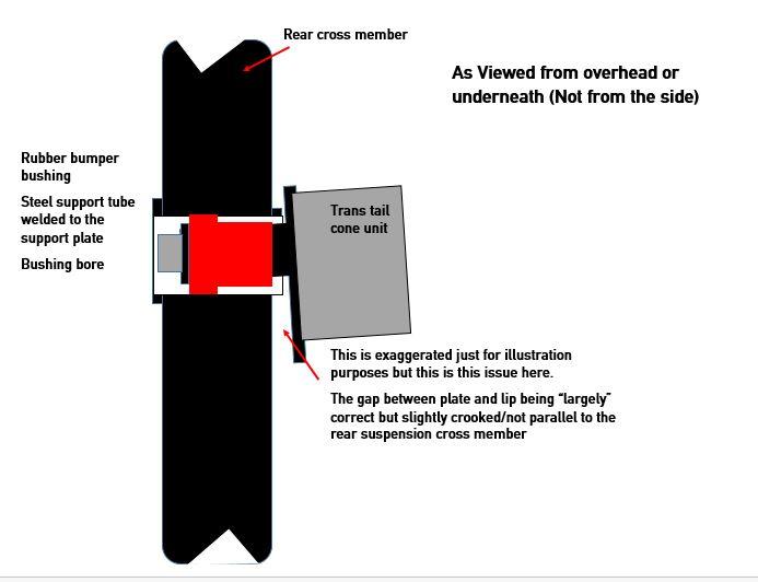

NOTE 5: See this diagram and photo. What they are speaking of is that the rear hanger bar must be centered between the engine case and the fan housing before you start.
If it’s not, it’s possible that the end support plates of the rear hanger bar have been played with and are at one extreme or another of their adjustment range. Check them from the inside of the engine compartment and correct them if need be. It can also signal that the center bushings are twisted or in bad shape.
SIDE NOTE: A lot of these sketches are crude but should get the point across. Apologies.
THIS IS IMPORTANT….it is from this plate and bushing tube assembly in the above diagram that all alignment measurements are judged/measured. It must be on as centered and correct as possible.

CORRECTIVE SCENARIO #1: the Tailcone bushing support tube is too low in the bore
1. If tailcone bushing support tube is closer to the bottom of the cross member bore…the 6:00 position…see if it’s tight in the bore. To do this, grasp the tailcone bushing support plate and wiggle it with your hand. With not much pressure the entire tail of the transmission should flex in all directions about 1/8” to 3/16” max. If it feels tight…..NEXT STEP
2. Move to the rear of the car. Remove the locking plates from the two horizontal 8mm bolts at each end of the rear hanger bar. Remove the nut from only one bolt at each end of the bar so you can observe the position of the bolt in the oval slot. It should be at the top of the slot.
3. Loosen the LOWER 13mm nut on the vertical stud at each end of the bar….the same amount for the nut on each side of the rear hanger.
NOTE: you will notice that every bit of loosening of the 13mm nut on the vertical studs causes the rear engine hanger bar to drop downward. You can see this by watching the 8mm horizontal bolts in their slots. They will move downward.
Do not loosen more than one turn on each side before you return to the tailcone support tube to measure its vertical position in the bore.
NOTE: What is happening is that as the rear hanger is dropping, the driveline package is pivoting about the center transmission hanger bar and lifting the tailcone bushing support in the bore.
NOTE: If you reach proper vertical adjustment of the tailcone bushing support tube in the bore before the four horizontal bolts in the rear hanger bar have passed 2/3 the length of their slots in the downward direction, you are fine.
Verify that the tailcone bushing support plate is still parallel to the suspension cross member and is level from side to side. If it’s not level, adjust it with the nut on the vertical 8mm stud on the end of the rear hanger bar that will lift the correct side to make the plate parallel to the rear cross member.
4. Move the top 8mm locknut on the vertical 8mm studs at the ends of the hanger bars downward and tighten them. This holds your adjustment in place
Recheck your tailcone bushing tube centering measurement and then tighten the four horizontal bolts on the rear hanger bar again.
Make sure the tailcone of the transmission now moves freely about 1/8” in each direction with very little force.
IMPORTANT NOTE! At this point you want to get a flashlight and look at the tailcone bushing support plate from either side of the car. If you have done all of the above correctly, the support pate should be parallel to the cross member and the welded on bushing support tube should be centered in the bore in the rear cross member.
NOW….make sure there is no vertical or horizontal tilt to that plate when looking at it from the side. You can also measure the gap if need be. Usually if the steel bushing support tube is centered correctly and the support plate is parallel to the cross member this will not happen.
When it does happen the gap at the top of the support plate will usually be less than the bottom. This means that the center transmission support hanger is too close to the chassis….so…NEXT STEP
IMPORTANT CORRECTIVE ADJUSTMENT! With the above problem you want to move to the center transmission hanger and get your ratchet, 13mm short socket and 24” extension bars.
Loosen the four vertical mounting bolts on each side of the bonded rubber bushings EQUALLY to keep the drive train level from side to side….½ turn at a time ONLY. Each ½ turn of loosening, stop and inspect the tailcone bushing support plate to see if the tilt is correcting itself.
When the tilt of the bushing support plate is correct, you will need to use feeler gauges to find out how much gap is between the chassis mount bar over the center hanger bar bushings. You should also find that there are between 2 and 4 plate shims under each one already.
These are pretty standard shims and are available from Saab dealers as they were used on the 900, or you can make them or go to any chassis alignment shop to get them. Pull one of yours out and look at it and take it with you. Just mark which side of teh car it came out of.
Loosen the bolts a little more, slip in the shims you need and tighten the bolts. Recheck the tilt of the tailcone bushing support plate.
5. Now recheck the vertical position of the tailcone bushing support tube. You will find it is off and will require another small adjustment of the vertical 8mm stud and the two horizontal bolts at each end of the rear hanger bar.
This adjustment should now require that the adjustment is moving upward and the horizontal bolts are moving upward in their slots.
SCENARIO #2: The tailcone support tube is too high in the bore. The tailcone bushing support plate is vertical and not tilted. This signals that the whole drivetrain unit is simply too high t the center transmission hanger bar.
1. Check that the rear hanger bar center bonded bushings are not crushed
2.
Check that the horizontal end bolts in the rear hanger are at the top of their oval holes.
IMPORTANT NOTE: If they are….adjust the vertical 8mm stud to MOVE them to the center of the oval holes. This will make the tailcone support tube adjustment worse for the moment but is in preparation for the next adjustment
NOTE: if these last two items check out….
3. Move to the center transmission hanger bar with your short 13mmm socket, ratchet and 24” extension. Loosen the four vertical 8mm bolts ½ turn at a time, equally from side to side.
4. Stop after each loosening sequence and inspect the tailcone bushing support tube in the bore.
5. Repeat this until the tailcone support bushing tube is in the proper vertical location in the rear suspension cross member bore.
6. Measure the gap between the chassis bar and the tops of the bonded rubber transmission cross member mounts with feeler gauges. Obtain correct shims to put in and tighten the bolts.
7. Recheck the tilt of the tailcone bushing support plate again. If the vertical tilt is now off…which it should be…..
You can now adjust the vertical tilt of the tailcone support plate by adjusting the 8mm nuts on the vertical stud at each end of the rear hanger bar. This is why we moved the adjustment to leave the horizontal bolts in the middle of their oval holes so we would have room to adjust for this after we reshimmed the transmission hanger bar.
You should have correct drivetrain adjustment now. You may need to make some small tweaks on individual vehicles but this is how it’s done. Torque all bolts and make sure everything has a fresh lock washer because these parts will come loose.
Check that your shift coupler tube has a close fit to the ball stud and repeat the Haynes manual shifter adjustment.
It should shift much better …but if it occasionally hangs up from 1-2 or 3-4 gear to another it is usually because of this:
The shifter forks have some wear already. You can figure out which direction the forks are moving not far enough……and slightly dish the shift coupler tube to push the ball in that direction by about a millimeter. It can also be too much gap between the ball stud (fatter O-ring) or a ball stub that is tilted or bent of one that is not tight enough on the shaft.
If it hangs up going from 2 to 3 or downshifting from the 3-4 plane to the 1-2 plane it is usually some small difference in ball stud arc or slack between forks and shift collars/sleeves.
You can fix this by finding or making a spare ball stud….and cutting the top off of one and drilling into both the head and shaft and installing an 8mm stud and locknut. This makes an adjustable length stud. By increasing or decreasing the ball stud length you shorten or lengthen the arc that it turns….making it move farther inside the transmission.
If it’s only a very small amount….you can also make the hole in the tunnel bushing plate that supports the shift rod…oval….and install an adjusting ring with a lock screw….to move the shift coupler tube higher or lower o the ball stud. I have not done this mod yet but I have simulated it with a block and a clamp so it will work.
One of the most critical problems with all of these adjustments are the center rear hanger bar bushings. Most of the replacements are either too soft or too hard. The too soft ones are the big problem with adjusting. As they wear and move they change the adjustment. The too hard ones just don’t live long and you have to repeat these adjustments every time you replace any bushings. The center transmission bushings have the same issue.

Thanks to Rays writeup I came to check the rear body tunnel plug/disc on my 412 and yes it had quite some play. I guess finding new plugs is impossible.
I managed to put a zip tie around the three lips who supports the rod and tightened a bit but not to much and after installing the play is wery much reduced.
But also the plug itself is not wery tight fixed in the tunnel hole so Im thinking of a way to fix it in its hole...

At least on the later ones....thd plug snaps on hard around the protruding lip from the tunnel.
what year is that one from? Can you post a pic of both sides? When I get back home I will post a pic of what I have.
I have been thinking that something that works well would not be too hard to make.

The plug is from a -73 and it is is all fat on the outer side.
Yes it snaps in hard in the hole but it has an axial play of about 1.5mm so it can wiggle a bit.
I just put a thin rubber O-ring in the space between the plug and the hole (where the red line is in the image) so it now sits much better.
