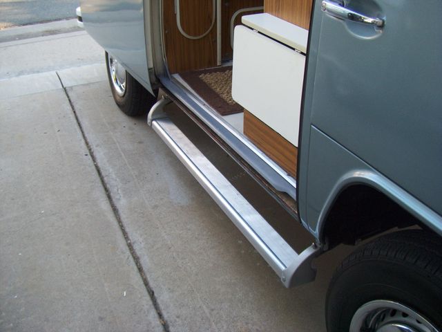

Dave you should make sidestep brackets ! Surprised
would they be strong enough?
then all we need is some aluminum siding Razz
thanks for the pic dreadnotmusic Very Happy - your bus looks sweet.
