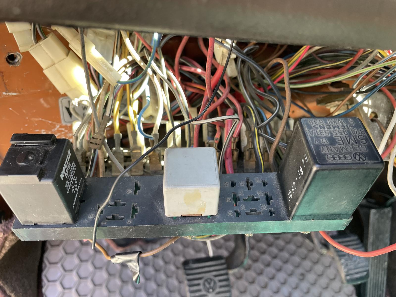

Italiancamper
Joined: July 05, 2023
Posts: 2
Location: Idaho
Italiancamper is offline
PostPosted: Sat Jul 15, 2023 5:20 pm    Post subject: Re: 81 Vanagon Fuse Panel Diagram Reply with quote
This is what the fuse panel looks like when I pulled it loose. Perhaps one of the modules is also in the wrong location. I’ve only on the van for a few weeks and I’m trying to make sense of this.
I’m just trying to figure out which color wire is supposed to go on each post of the fuse block. I’m presuming all the brown wires go to the ground tree.
pathao
Joined: November 01, 2012
Posts: 340
Location: Montreal, Canada
pathao is offline
PostPosted: Sun Jul 16, 2023 10:57 am    Post subject: Re: 81 Vanagon Fuse Panel Diagram Reply with quote
Italiancamper wrote:
... figure out which color wire is supposed to go on each post of the fuse block...
well if your setup his still "factory" the diagram in your Bentley
note that the picture of your fuse box is seen "from the front" while the empty fuse box shown upper in the thread is seen "from the back" (if you prefere, your fuse S1 is to the left will the empty one is to the right). Anyway
DO NOT trust what I'm saying : use your multimeter
It looks like
the Bentley says this
A : Fuse S3 8 AMP with a 16 AWG Y Yellow wire going to the Left Headlight low filament
B : Fuse S4 8 AMP with a 16 AWG Y/BK Yellow-with-BlacK-stripe wire going to the Right Headlight low filament
C : Fuse S5 8 AMP with a 16 AWG W White wire going to the Left Headlight HighBeam filament + a 20 AWG BL/W BLue-with-White-stripe wire going to the position 56a of the HeadLight Dimmer Flasher Switch
and your picture says this
So looks like your Bentley can help you built your head up to YOUR setup. But one thing is sure, you hasve to understand wath your doing. Their is no quick shortcut. Do NOT put your truck on fire.
