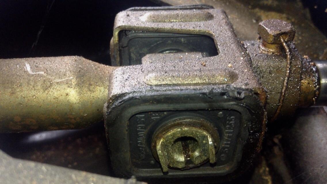

PostPosted: Wed Apr 01, 2015 1:59 pm    Post subject: Reply with quote
Here's mine, I don't exactly know what it looks like when worn - so maybe someone will be able to tell right off.

PostPosted: Wed Apr 01, 2015 2:05 pm    Post subject: Reply with quote
your "looking" for play in it. This is what transfers the shift from the shifter, down the shaft, thru coupling to the trans. No play=Good.

PostPosted: Wed Apr 01, 2015 2:41 pm    Post subject: Reply with quote
Play in the screw or play in general? Because it has a good amount of play in each gear

PostPosted: Wed Apr 01, 2015 4:03 pm    Post subject: Reply with quote
as you move the shifter it transfers movement to the shaft, travels the shaft to coupler which makes the connection to the trans/hockeystick. What you want is for the hockey stick to move as you move the shifter (all as one). If the coupler is sloppy, shifts will be sloppy.

PostPosted: Wed Apr 01, 2015 6:25 pm    Post subject: Reply with quote
I have a spair shift rod and coupler - it just needs new ruber. Can I get just the ruber, or should I just buy a whole new coupler?

PostPosted: Thu Apr 02, 2015 11:17 am    Post subject: Reply with quote
They're only about $10 bucks new. Very Happy
