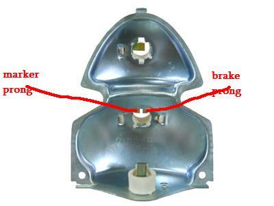

Oasis: the mexican elephants feet and (IIRC) most aftermaket replacements have one bulb that is fed from two wires-ATM i cannot remember which was which, but I think its the brake/marker light--the reds one. instead of having two bulbs with its own connector, its one bulb that has two connectors going to it..more like tabs the wires plug into.
you have to swap the entire assembly though..you cant just put the new 3 bulb lens on the old 4 bulb mounting, but you use all four of the stock wires...
this isnt the exact bulb holder, but it shows the general idea
