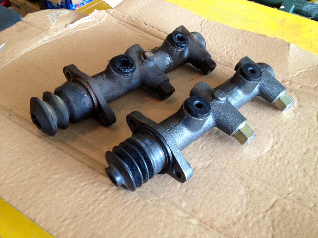

We needed a new master cylinder for the final piece of our brake system replacement and after doing some research here on the Samba, it appeared that some disliked the "cheap Chinese" version that sells for around $80 bucks in favor of the German version that's close to $300. Others posted that they'd used the cheap version with good results. There weren't any good comparison pictures, so I snapped a few.
Since our bus is a daily driver, I figured I'd use the $80 version from So Cal Imports and report back occasionally on how it performed. First however, here's a short write up with close up shots comparing it to the original German master cylinder side by side.
First off, I'm in no way associated with AC Industries or So Cal Imports, I'm just a bus enthusiast trying to share a little helpful info. I have worked in the foundry industry as well as having been a machine shop foreman so I feel comfortable reviewing this casting and it's overall finish. Having purchased other cheap Chinese castings, I'm used to seeing core shifts, porosity, and poor flask alignment. This casting however is excellent and something that would have passed QC at our foundry. The parting line shows good registration, zero porosity, and it's evident their sand and binder control is good. Even the mold cavity identifiers are sharp and well formed, no issues whatsoever with the casting.
It shipped boxed and sealed in a plastic bag with each port plugged and arrived 3 days after ordering. The order was online, $80.95 with free shipping and a $5 handling fee. There was an order confirmation email and a second email with tracking info.

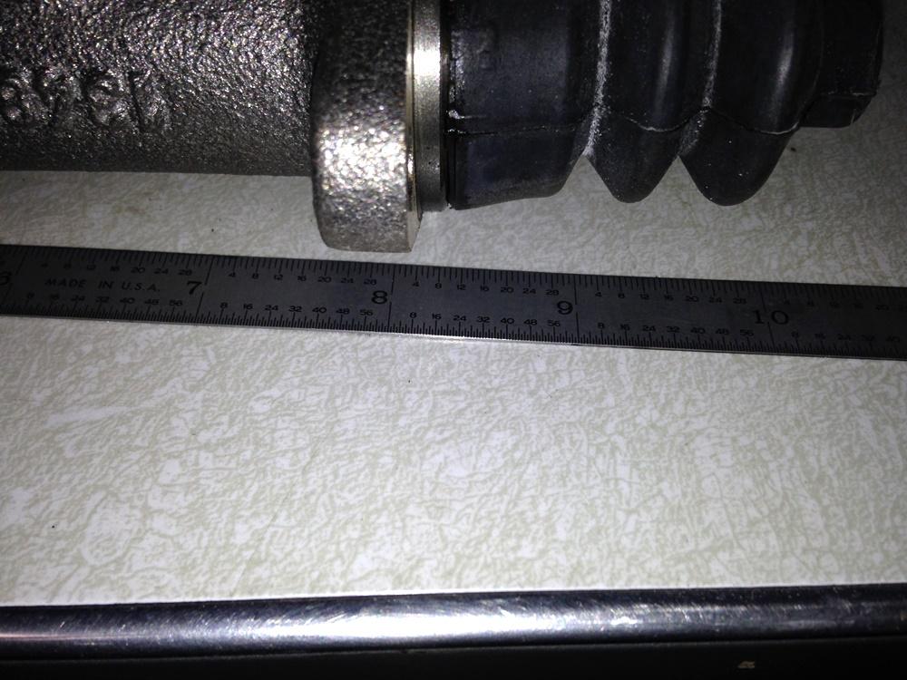

Side by side the quality of the $80 part vs the original German version, none of the typical issues are present. Things often seen like machined surfaces that exhibit shrinkage or cast bosses with distortion resulting in the individual geometry or structure being poor. Drilled or tapped holes that appear off-center within the casting but may be correctly located within the overall geometry. This part had none of these issues.
Finally, here is the original 67 reservoir mounted on the new master cylinder. The seals appear to be good quality as is the brake rod bellows, overall I'm very pleased with this part, especially as this price.
I did bench bleed this cylinder prior to attaching the lines to flush out any preservative lubricant that may have been present. It fit perfectly and worked perfectly as we bleed each wheel circuit. Since it's a dual circuit, we started at the front and it built a strong pedal quickly. This bus had sat for 17 years in a garage before we put it back on the road, so I've replaced all the soft lines and wheel cylinders, brake pads, etc. It stops very well now, straight ahead with no side pull. I'll update this thread from time to time and report back on the longevity of this part. So far I'm very happy with it, hopefully this info helps others considering which cylinder to buy.

Been using the same MC for about 6 months now with nothing bad to report. Stops great (using it with discs on the front, drum rears) with no leaks.

In my experience, some of the Brazilian or Chinese master cylinders last longer than the German ones because they don't sit on the shelf that long and have the seals dry up. I put a German one in my Bug years back and it crapped out quickly. The Brazilian one has been working great.

I installed a chinese 67 only in my 58 last week with a used og german ATE reservoir. I am now experiencing leaks at the seals to reservoir, both of them. When I installed the reservoir it went in the seals a little too easily. It was much tougher to remove it from the german seals on the og master.
Has anyone else experienced these leaks? I am thinking of the pulling the reservoir seals out of the german master and see if they work better.
Otherwise the install was easy and I thought the quality was decent for the price. No problems bleeding and performs well outside of the leak at the reservoir.

PyrOman wrote: So which is the "correct" 67 master or could they have been 2 different ones? Eh?
I suspect the version you pictured with the extra ports isn't exactly right for the application. I don't see the restrictors for drum brakes, it appears the hard lines are connected directly.
Also the two blocked ports using sections of hard line bent over aren't correct, they're dangerous as that system is designed to work up to 1200 psi.
Whoever has that installed with those curled lines needs to swap out the correct master, or at the very least use proper fitting plugs in those unneeded ports.
