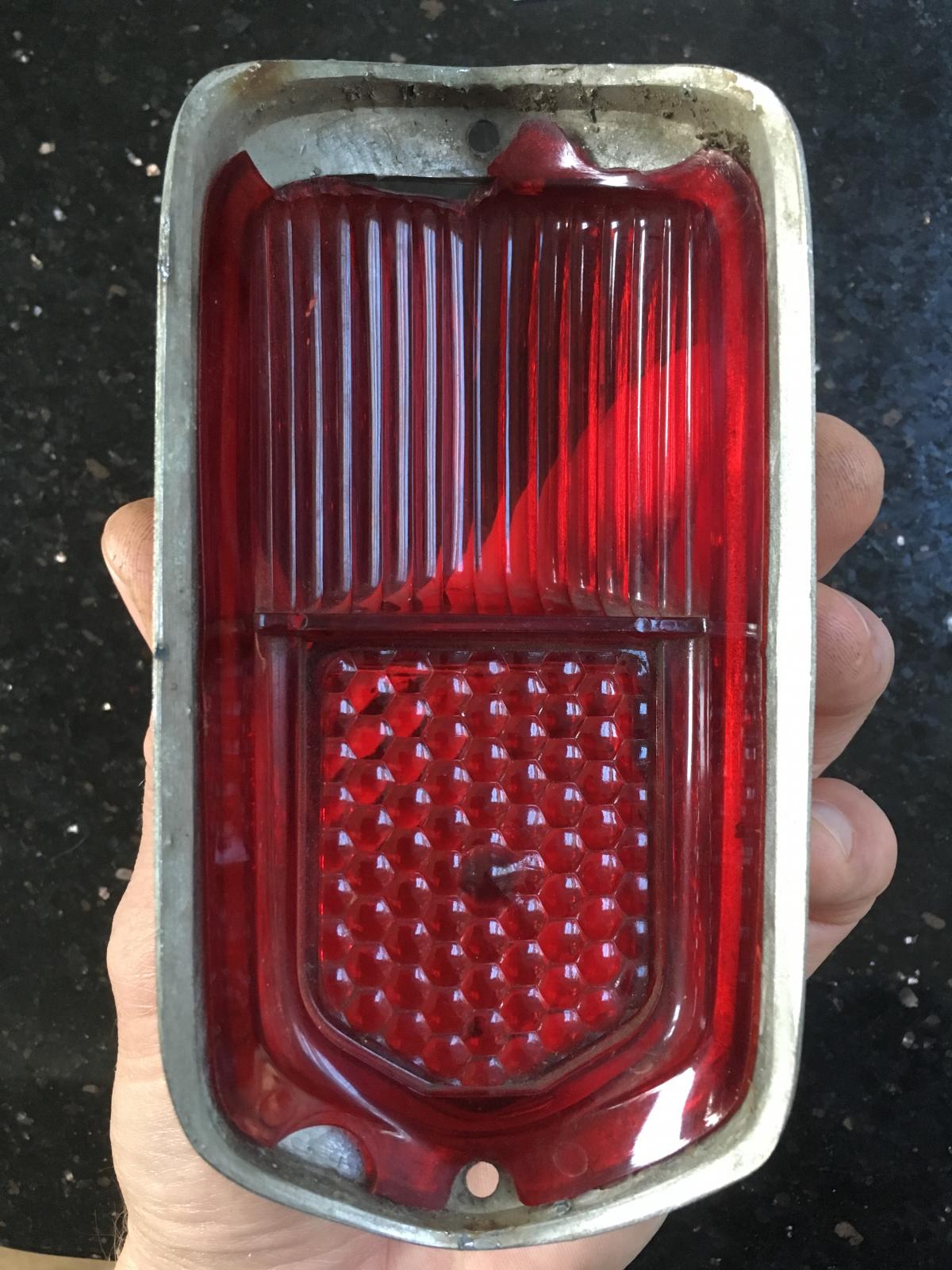

PostPosted: Sat Sep 01, 2018 10:57 pm    Post subject: Re: Difference between lowlight one piece and two tail light bezels? Reply with quote
You need the 2 piece style, which if I read it right your seller has.
Picture of the back of the 2 piece ring/lense.

PostPosted: Sun Sep 02, 2018 9:05 am    Post subject: Re: Difference between lowlight one piece and two tail light bezels? Reply with quote
Never post after enduring a three hour LA commute it does things to you brain.
I edited my post.
Yes, TWO piece as pictured is exactly what I need.
