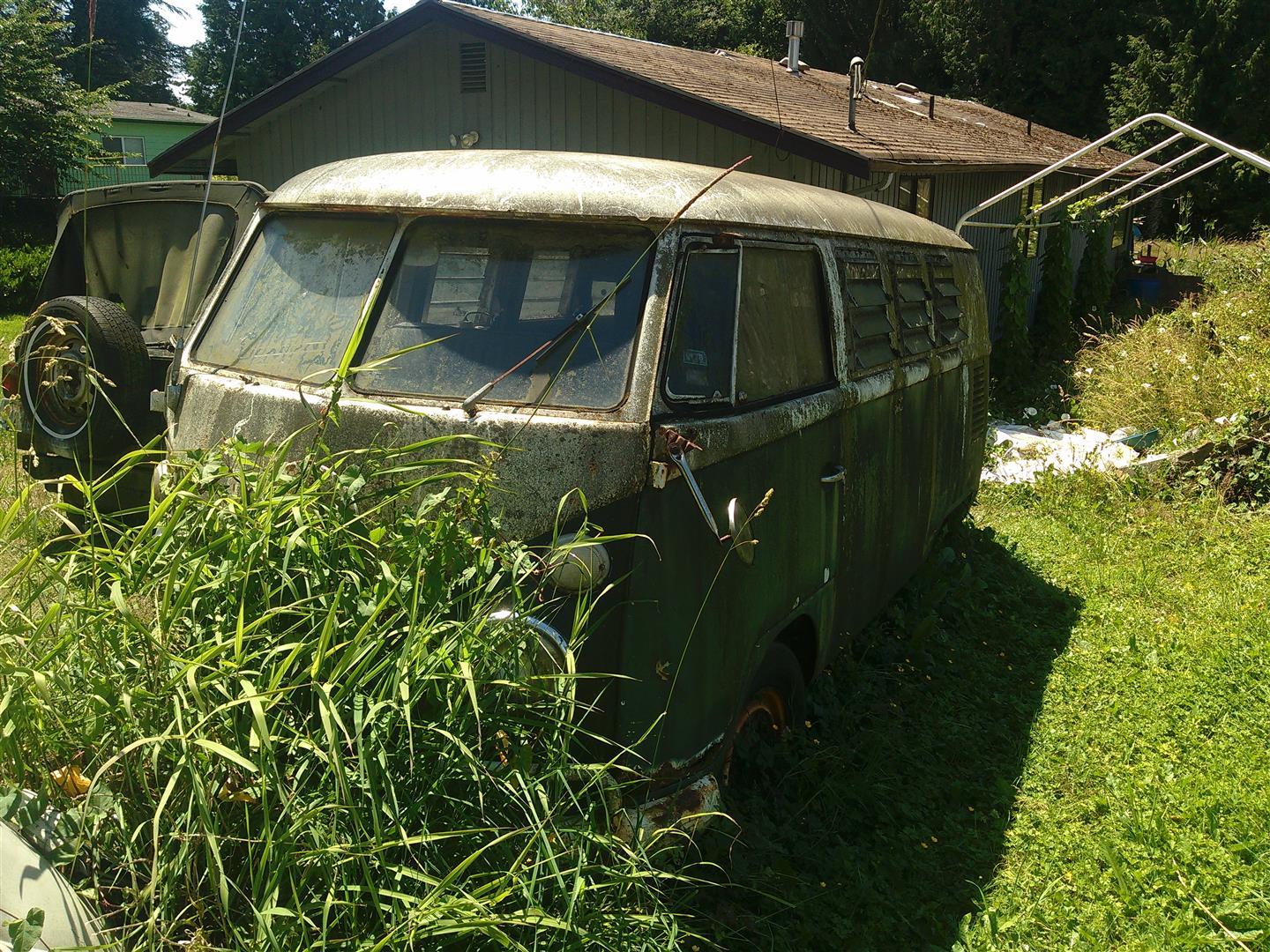

Got word of an "early 60's bus with 3 crank-out windows on the side" in my small town so I had to stop by and take a look. I pulled up in my 59 panel and sure enough, it was actually a split window with nearly 20 years worth of moss growing on it.
The owner came out and let me take photos of the M-plate and VIN plate but I'm a little confused. According to the code, it's listed as a walk through but it's actually a 1/3-2/3 bench and it's listed as a 'Microbus Deluxe" which I assume means it was a standard at one point (was eventually converted to an American camper).

No photos of the bus but it's definitely a bench with six side windows. The owner has been harassed over the years to sell her bus so I didn't want to push it too hard.

Here's what I know about the bus so far. According to the current owner, she and her ex-husband bought the bus in 1979 with the camper kit already installed. They traveled up and down the west coast going to many National Parks. They drove the bus until an accident caused some damage to the front beam so that's when they parked it. Years later, they got divorced and the bus ended up with her (I guess there was a fight over it). It's been parked in the same location since '99.
She still hopes to restore it someday but I got a sense that she may let it go to the right person who will love it as much as she does. I doubt she has the means to put any serious money into it (which it needs). Over the years, she's been low balled by many many people so because of that, she's a bit leery which is understandable.
I'm going to stop by again today to check out the VIN and maybe get some photos so we an clear this mystery up. Though I don't want this bus, I'm curious to resolve this. I'm thinking it's a '66.

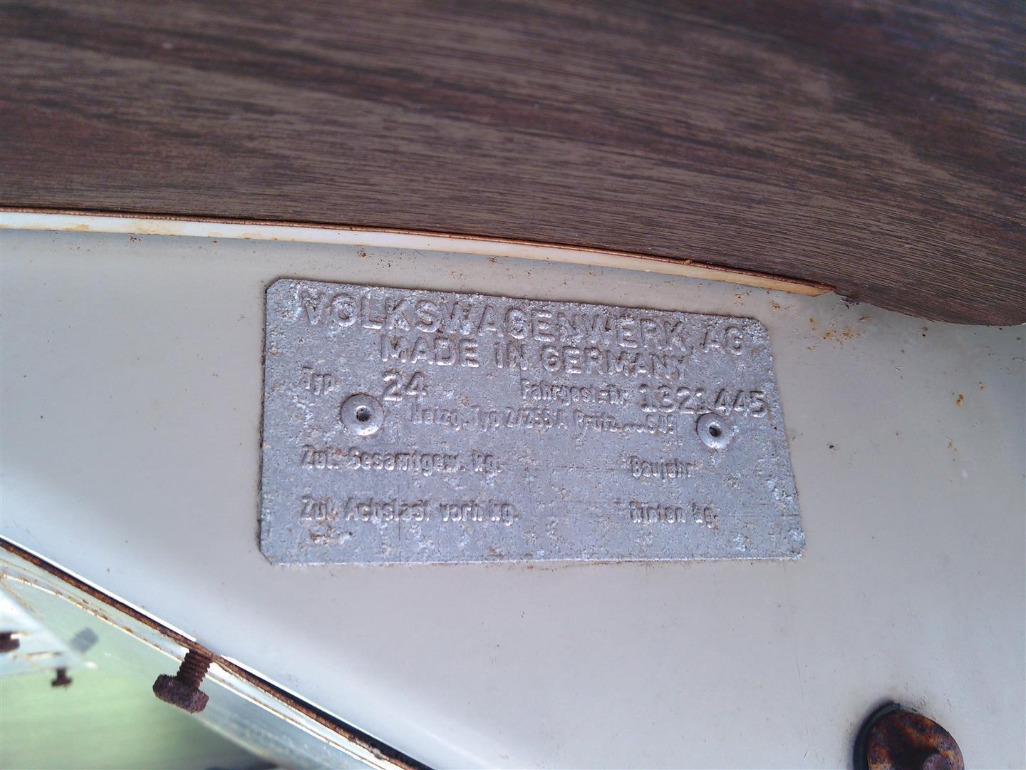

After work, I stopped by again and the owner was kind enough to let me look at the bus and take photos. I explained to her abut the mystery but she had no insight. She's always known it as a 64 (but says she wouldn't be surprised if it was something else).
Crazy enough, the chassis number matches with no obvious signs of hacking (but that doesn't mean sh*t). Sorry for the bad cell phone photos.

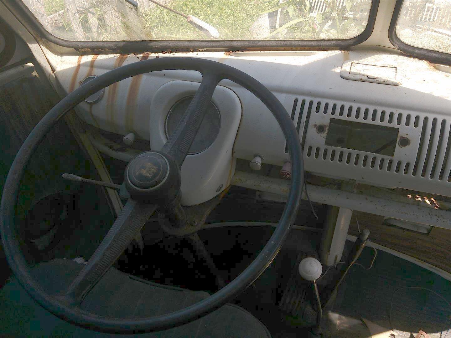

Note late style Emergency Flasher
Why I think it's actually a '66
What saith the experts?

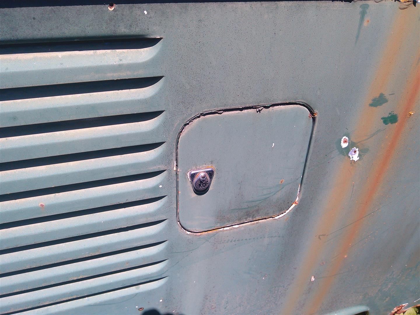

Well, I lost the bet as to the stamped VIN being different Exclamation Still, the bus is clearly not a deluxe as indicated by the VIN tag (type 24) and the m-code plate (241).
The engine lid looks to be a 66 because of the latch, but that could be a change. Does the bus have a floor button for the high beam switch? If not, then it could be a 66. Even if the bus is a 64, it's not a walk-thru nor a deluxe so if all the numbers are matching, I'd look for signs of a rear clip or graft of the engine bay tin.
My feeling is that no one would have a problem titling and registering the bus as it sits, but there would still be that nagging doubt as to why the bus itself doesn't match the assigned numbers.

On the matching numbers... Weird... I don't know what to say here.
It looks like it has a 66-67 style turn signal arm so probably no dipswitch on the floor?
Lightened it up so you can see the arm
No dipper switch on floor, finger hook engine cover latch, washer jets for windshield, no emergency flasher light in dash, my guess this is a 66, not a 64. Swapped tags are most certain. A very close look at the engine compartment may reveal a graft that includes the stamped VIN.

Another nod towards 66- pointed front bumper.
See if it has a 66-67 only front sway bar next time.
Looks like they also nicked the horn button from the 21!
I'd bet the rear vin stamp was grafted in from the 21 along with the plates. Like previously said, M code plates were installed before paint. That's why it's been stripped bare, it wouldn't have matched the new bulkhead and would have been an obvious red flag.
