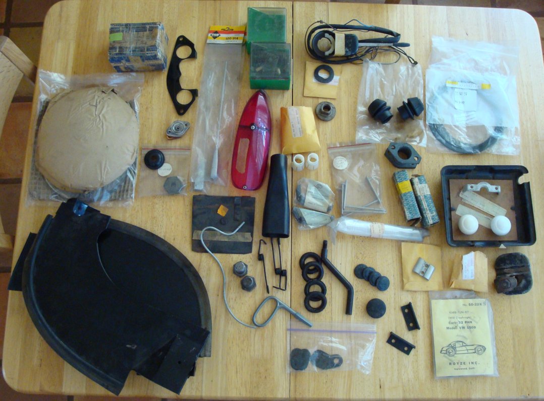

Posts: 71931
PostPosted: Thu Mar 12, 2009 12:22 pm    Post subject: Reply with quote
These black ones are supposedly NOS but I have no proof:
Or NOS grey ones:
