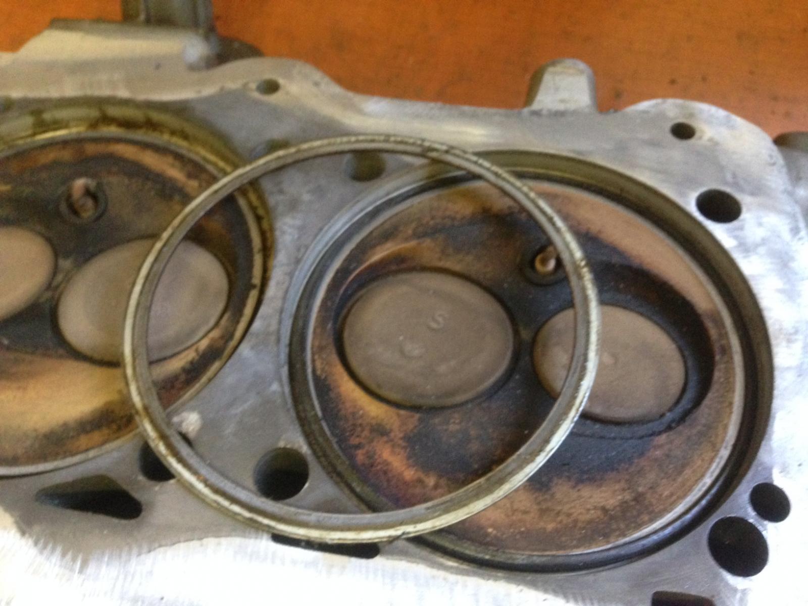

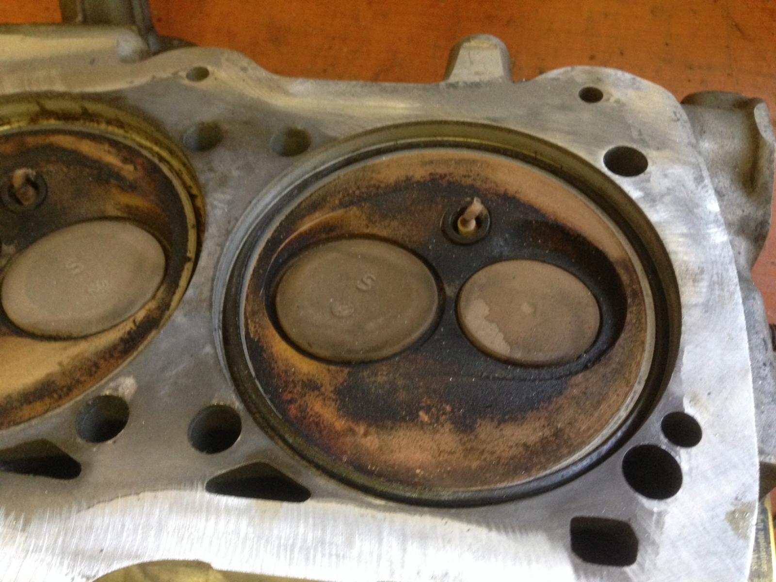

I have my 85 vanagon with a 91 2.1 in the shops for gasket replacement. They sent me pics that confused them of an o-ring in the cylinder head. They are claiming this is not standard and they can't find that part in any part listing. The PO that I bought the van from did the heads himself. Can anyone confirm?
Thanks.

I believe the PO may have made a mistake. There is an O ring listed 025 101 177. It does not go under the gaskest. It should fit around the jug. I found this image here.
[img]
[/img]
O ring part number is 025 101 177 spec is 101 mm x 1.5 thick.

The problem appears to be the groove that appears to be machined into the head that this o-ring is sitting in. The PO said they were AMC heads, so that is that groove normal? The shop my van is at is a very reputable VW shop and done a lot of vanagon head jobs and they haven't seen it before.
Is this the problem?

The article you linked did not mention machining the heads to accommodate an O ring. Looking again at the pictures you posted, I can now see the O ring groove. There are other members that are more versed with the WBX engine than I.
At this point, I don't see how you can use the heads without another O ring. It must have been sized in such a way that you could still get a solid seal and torque. Normally I don't think you'd have a rubber O ring in a compression area.
In high compression inline engines, we'd O ring the block, but utilized a copper wire that stood slightly proud and would compress into the head gasket for a better seal. This will bump your thread. Sorry I can't be of more help.

Orig wbx heads do not have a o ring groove unless some did it themselves. At top of liner, on outside is a groove, it is a small dia, close to 1/16", fits arount top of cyl, supposed to keep water out of area where hd contacts the flat sealing ring (flat one is what seals in compression gasses) All i have seen r a greenish color. This is a troublesome seal, ALL surfaces need to be clean & flat also no scratches pits etc. My2cts, as usual no warranty is available at this time.

Have the machine shop measure the depth of the groove. You might be able to use some copper wire to complete the seal to the factory gasket and it will work better than rubber. It just needs to stand slightly proud, no more than .010".
Other options would be to weld up and flycut back to stock or fly cut without welding up and live with the higher compression and the possible changes in pushrod angles.
Or, step up and spring for another set of heads. I don't believe you mentioned why it was apart.
