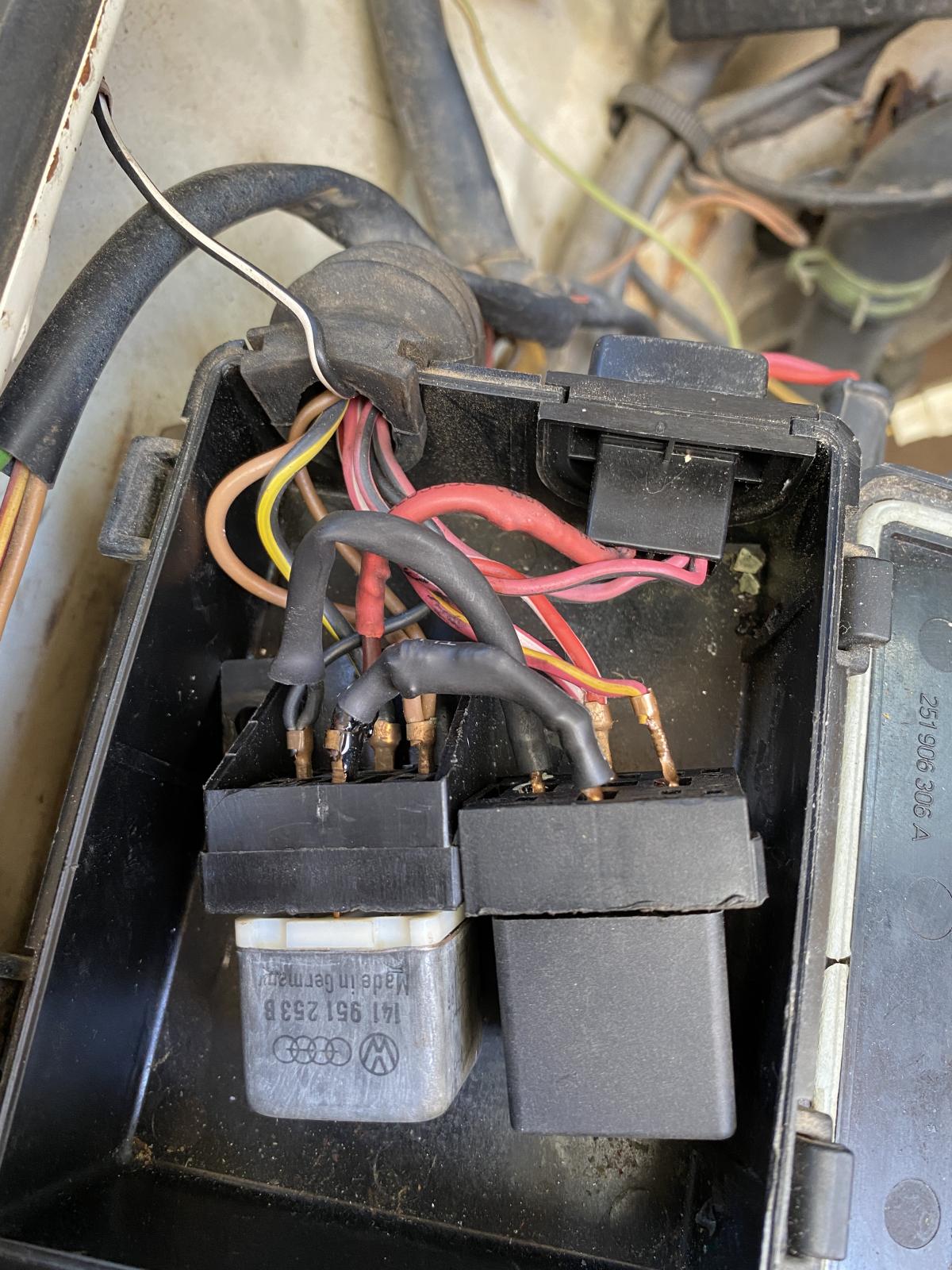

I took some pictures of what is going on in the fuel pump relay box. Previous owner told me he converted from 5 wire to a 4 wire setup removing the expensive relay.
The black and white wire is disconnected. I am going to clean up everything and cover with insulating tape. Just want to see if it was done correctly.
Anyone know the link to the conversion thread?

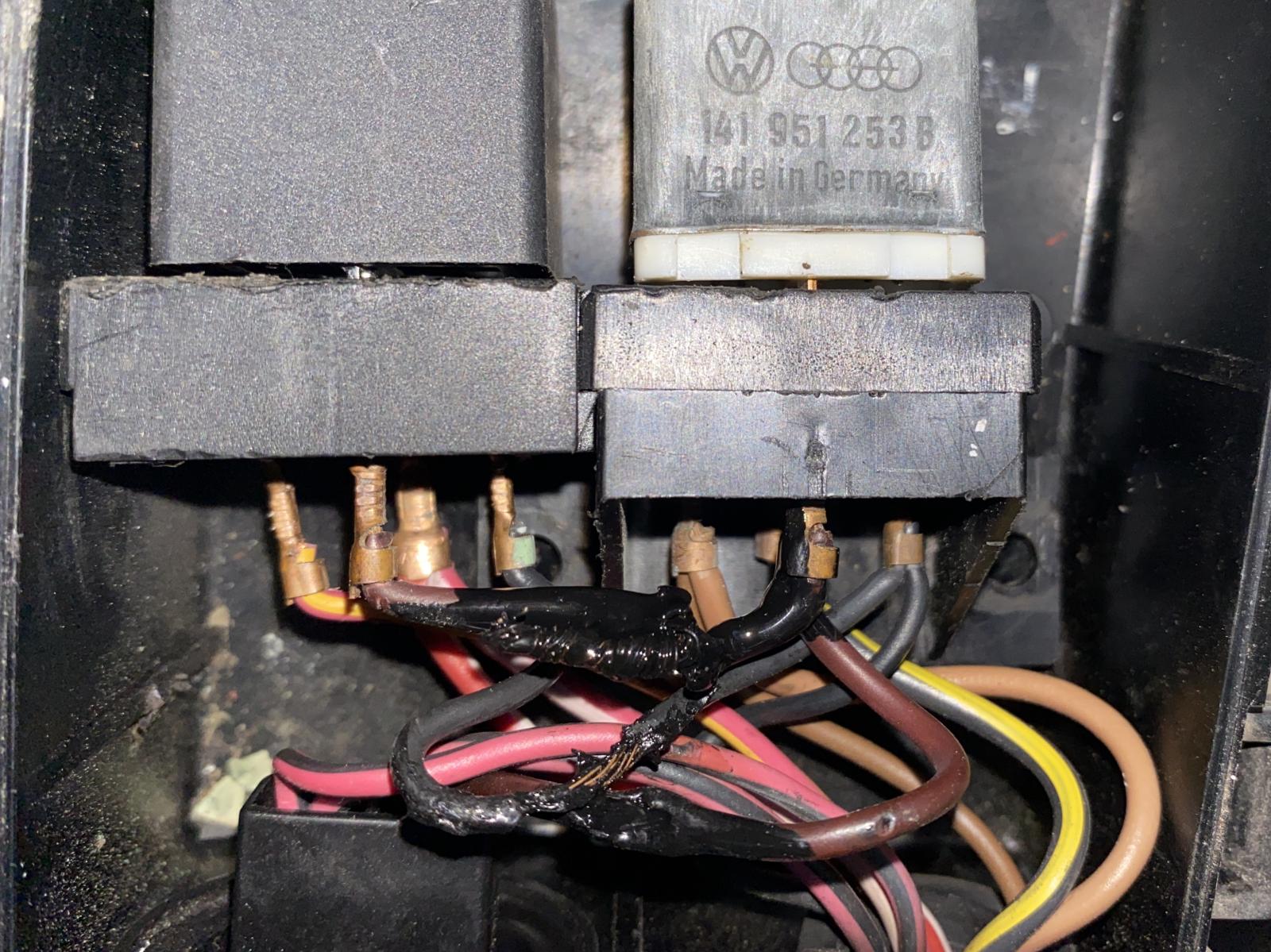

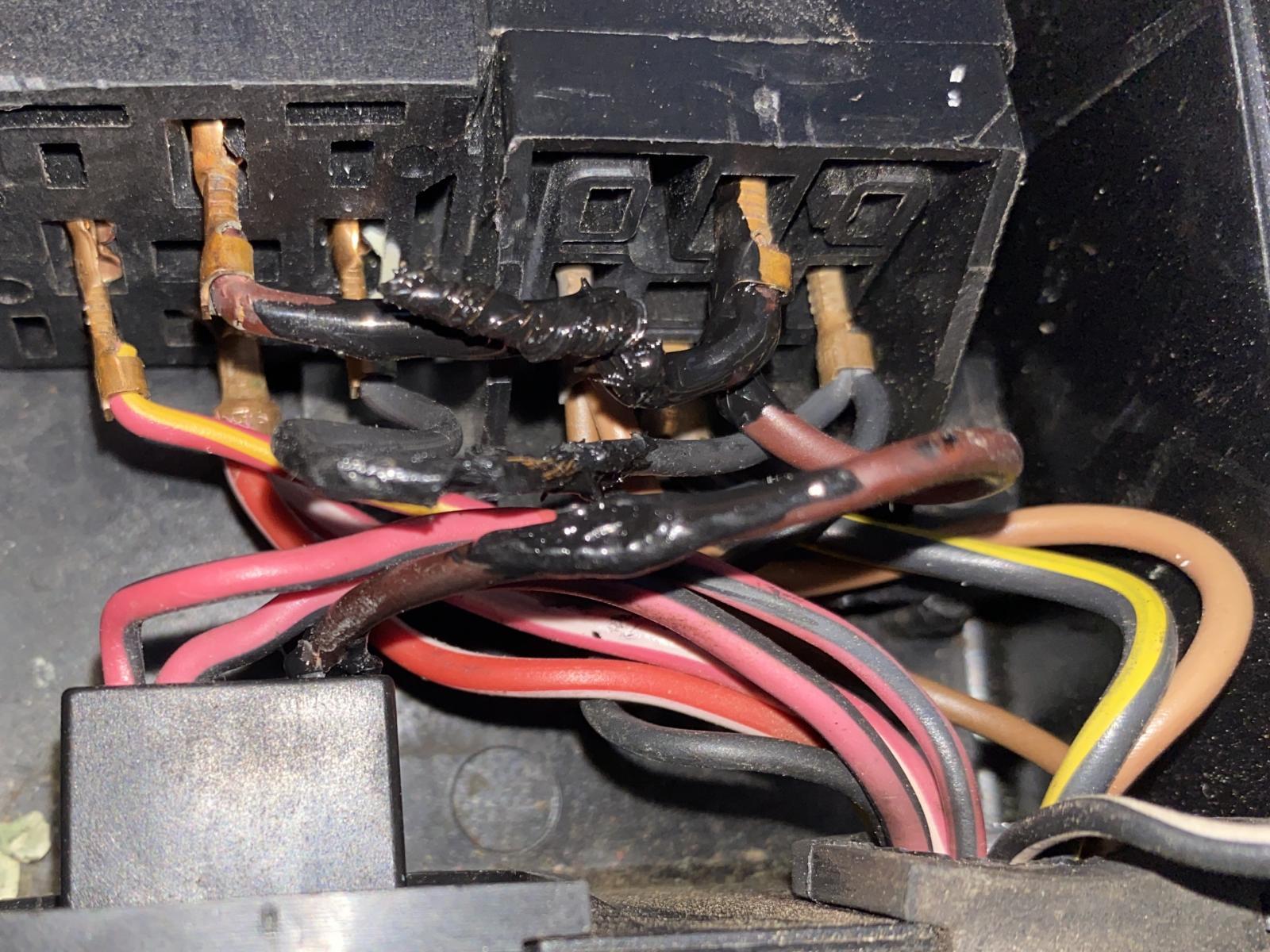

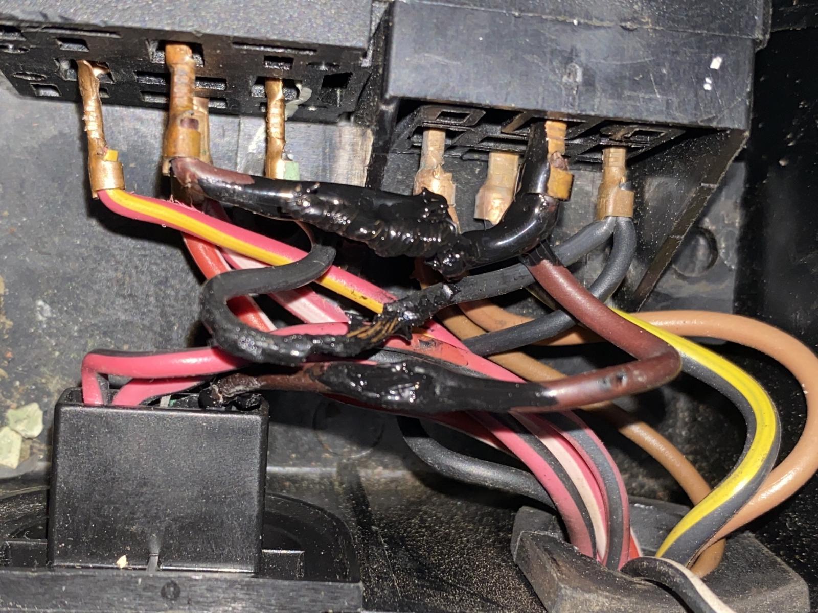

The red/yellow wire contact at fuel pump relay socket looks like it's getting pushed out by insertion of relay; those contacts have a locking tab to keep them in place.

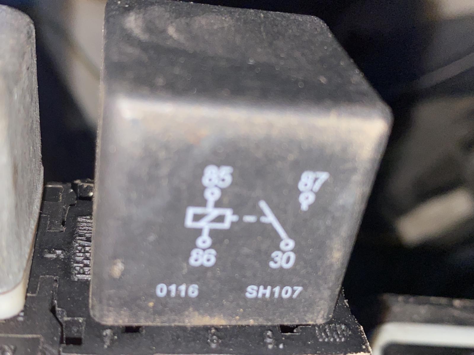

The black sh107 relay looks like it does not have a suppression device. Suggest using a properly Amp rated relay with suppression device. (resistor) The diagram on relay will indicate if it has a resistor across 85/86.
Heat from soldering done on the red 30 wire (why was it cut?) might've damaged the black switched positive wire but the red 30 wire looks like its' also suffered heat damage where it enters the box. But, that clue may be a red herring as I doubt the current limit of it was exceeded but I'd be curious about that.
Comparing wiring to pin 87 of each relay socket, it looks like this harness uses the 1990 year scheme which I find interesting.
Since your fuel pump runs when key is turned to ignition on (engine off), at forward end of engine bay, look for the white 2 pin connector for fuel pump. Maybe someone hacked wiring to that?

The previous owner made some changes and I want to do the 4 pin conversion. By the BK/W wire being disconnected I think he steady did that.
What is the correct relay to get?
I want to repair all the wires and insulate them.

PostPosted: Sun Aug 02, 2020 12:39 pm    Post subject: Re: Digifant fuel pump relay question. Reply with quote
From what I can see, terminal 87a on the fuel pump relay is connected now to terminal 30 on the digifant relay.
The black and white wire was disconnected from the relays and I think the black wire was moved to terminal 86 from terminal 87a.
Is that how it should be? If it is, then I will just Repair the damaged wires.

PostPosted: Sun Aug 02, 2020 1:49 pm    Post subject: Re: Digifant fuel pump relay question. Reply with quote
Got all the wires covered. Much better.

I've never done that conversion but I agree; that conversion appears to have been done.

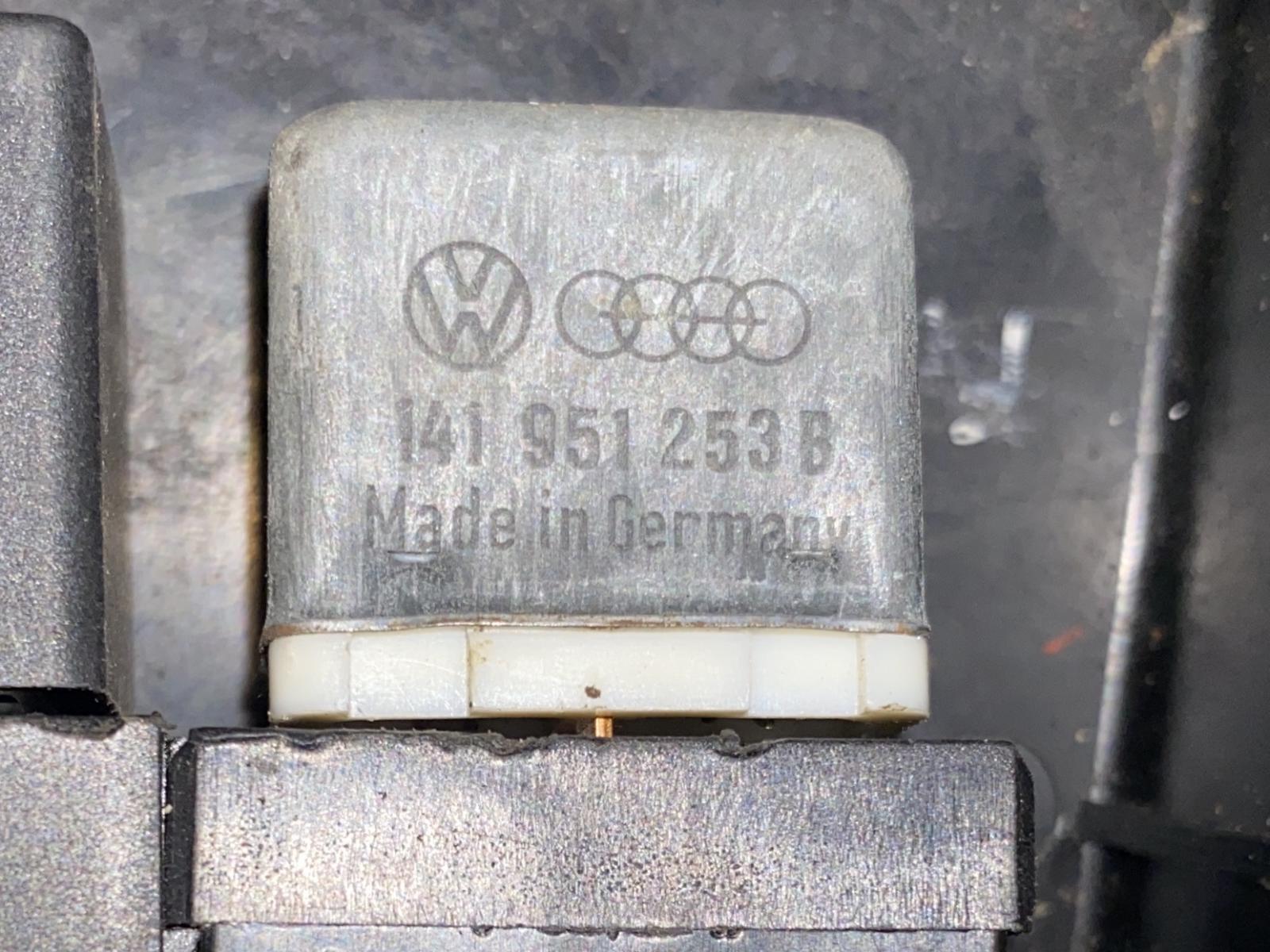

Your "Made in Germany" relay is likely a "53" which is typically used in fuel pump and "Digifant" positions. You could find it online but I'd bring your 53 relay to your FLAPS to help match it to a generic 12 volts properly Amp rated 4 pin relay with suppression device. That black relay should work for now but every time you shut off the engine, it might allow voltage spikes to harm the ECU.
crazyvwvanman comments in link Kamz provided will be accurate and will cover at least part of what I'll try to explain but here goes.....
The black relay has 4 pins so there should be no 87a involved here. And AFAIK, a 30/87 85/86 relay pinout is standardized. So, I doubt that 30 and 87 positions are reversed on that relay.
I don't see a connection between a 30 and 87. If 30 was connected to fuel pump relay 87, the fuel pump would run all the time. I sometimes label the 30/87 85/86 pins on the relay housing so I know what female pin is what at socket. Not easy to see the numbers on the black sockets.
The black switched positive wires originally went to pin 5 of 5 pin relay and 86 of 4 pin relay. To me, they now appear correct: each goes to 86 of each relay. That said, as mentioned, the fuel pump relay is controlled by the ECU.
In your images, it appears that the 30 supply wire from 2 pin connector connects to 30 of each relay which is correct. Below is an image of the harness on my '88. You can see how that red wire originally looked.
A short out event may've caused the damage at red wires from the 2 pin connector. Inspect: red wire from that 2 pin connector back to positive junction stud in the black junction box at driver side of firewall, wires in that box, and wire from that stud to alternator B+ stud.
This has been written about here, but if one of the wires from the power steering switch is not connected and shorts to ground, it could conduct electricity for a relatively long period of time thus do damage to other wires etc. e.g. to wires you show.
Seeing the new image, I'd be prone to replacing the burned wires but to do so, you'd need new used sections of wire with proper contacts or means to make same. In the past I've used wires from new relay sockets for this type of thing but I don't recall if the 2 pin connector has proprietary terminals.
Neil.
This harness has a different wiring design, colours but 30 wires should be the same.

PostPosted: Sun Aug 02, 2020 2:03 pm    Post subject: Re: Digifant fuel pump relay question. Reply with quote
Cool. I was going to suggest using heat shrink tube.
Insulate the black/white wire terminal. Diagrams show it connecting to ECU.

PostPosted: Sun Aug 02, 2020 2:26 pm    Post subject: Re: Digifant fuel pump relay question. Reply with quote
Neil.
Yes. You are correct. The ref wired is connected to 30 on each relay.
I don’t think there was damage due to a short. It looks like when the PO did the conversion, he poured some hot material on the new connection to insulate it. That material ended up on the other 2 wires melting the insulation.
I also insulated the connector on the BK/W wire with some heat shrink.
If I understand correctly, it should all be good now.
