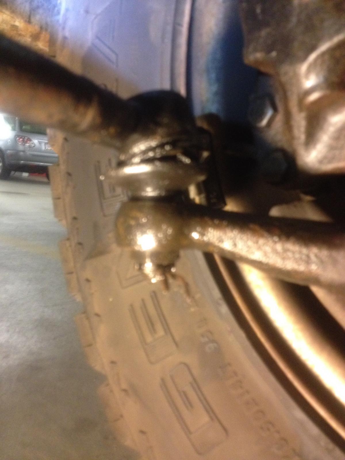

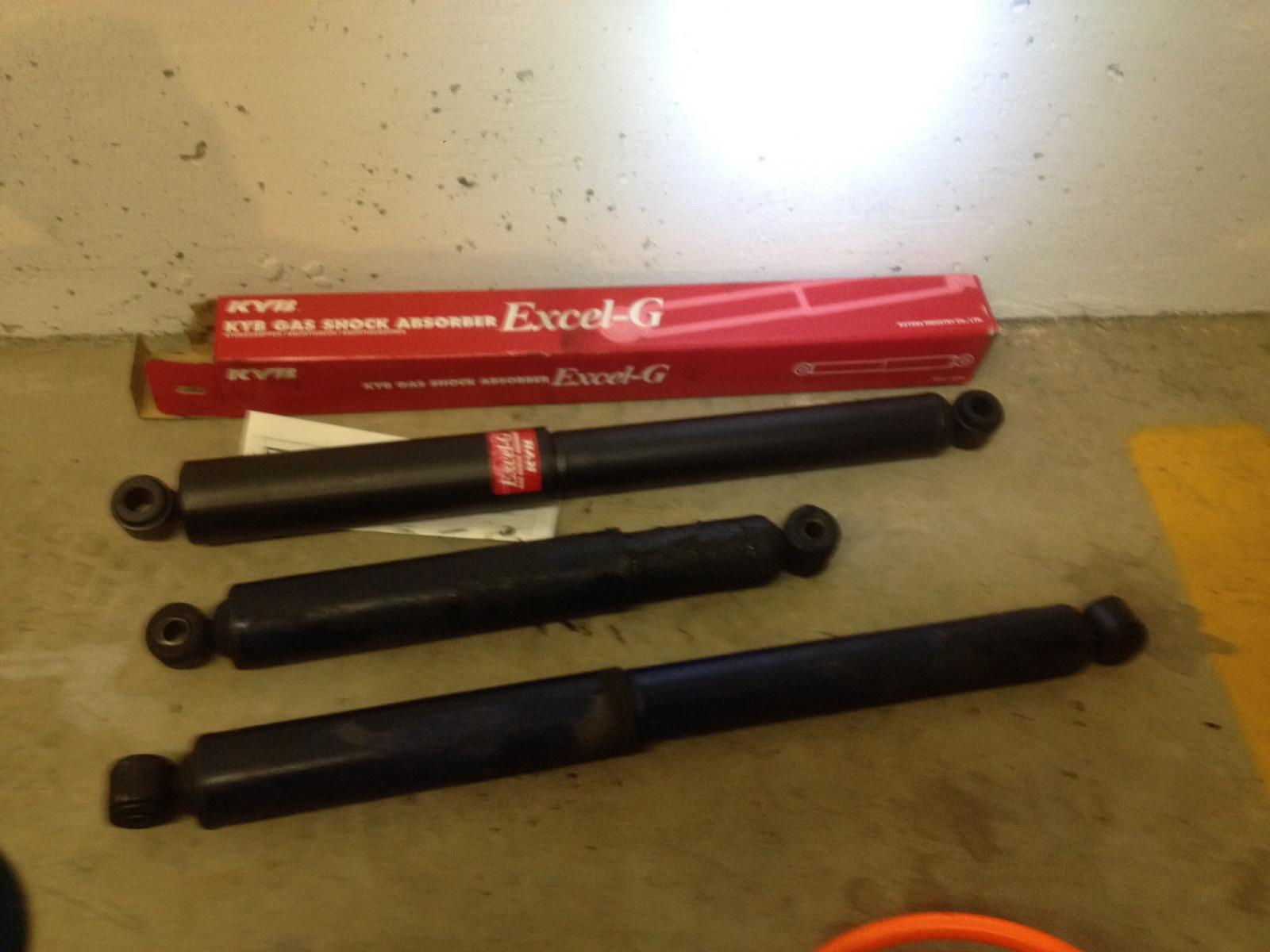

PostPosted: Mon Jul 06, 2015 7:19 pm    Post subject: Repair update! Reply with quote
well,
I've been busy, but have come up short. A few things are just beyond my capacity at home to do.
I've changed the drag link, and tie rods, steering damper. You can see how badly worn the joints were, definitely needed to be replaced.
I made sure to measure the old against the new and keep them the same length. They were relatively easy to do. I used a pickle fork and a hammer and they came right off.
The torsion arms were a little more problematic but not too bad. The sway bar came off easily enough. You first tap the metal keeper off the clamp and then bend the metal off the arm.
The bottom arms came straight out, the uppers took some hammering, but came out. I marked the location just as a matter of good practice and sent them to the shop to press in some new ball joints. I tried and tried at home, but just couldn't create enough force to press them out.
Rear shocks were straight forward, two bolts, in, out done.
It's been lots of fun and rewarding so far. I've got the cv boots and shift bushings to do next, and everything else I need to do is a simple replacement, no stress.
If anyone has any tips on the cv boots, I'd be very appreciative!
Thanks all!
1971 Campmobile
