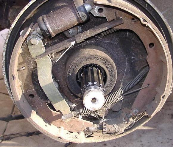

I'm having a similar problem. I replaced both brake cables, cleaned/lubed adjusters, adjusted brakes, adjusted cable tension, but still absolutely no parking brake whatsoever. There is some tension now when I pull the lever, but it does absolutely nothing as far as holding the Bus. The shoes that are on the Bus are old, but still have plenty of lining. Parking brake lever and spreader seem to be in working order. Any thoughts? It's a major PITA since my driveway is on an incline and I have to reach out the driver's door and place a chock behind the wheel while making sure my foot doesn't slip off the brake pedal. I grabbed this photo from one of Aeromech's posts. Is this the correct setup for a '77? I wanted to compare it to mine to make sure everything is installed properly. Thanks, and happy 4th.

That is not a pic of a 77. That would be a 70 or earlier.

That rear hub picture looks like my late-73 bus . Or close enough.
The handbrake cable adjusters are under the front of the bus on later handbrakes.
The trick is to slacken the handbrake cables fully then adjust the star adjusters on the rear drums so the shoes are just touching (procedure in Bentley and other places) and then readjust the handbrake cables so the handle comes out 7 clicks and the handbrake is on.
If the handbrake cables are rusted they may simply lose strands and unwind in a shower of rusty strands of wire when you pull on the handbrake, instead of putting tension on the brake shoes.
It is also possible the brake shoes are glazed and need some sand paper treatment to roughen their surface.

1977 lacks this clip that holds the spring to the bar. The ones available for other years do not fit.

On a side note, the brake assembly shown in the photo posted seems to have Vanagon brake shoes, without the auto-adjuster stuff. Such shoes were (and perhaps are)
being sold mistakenly as late bay brake shoes by many vendors.
