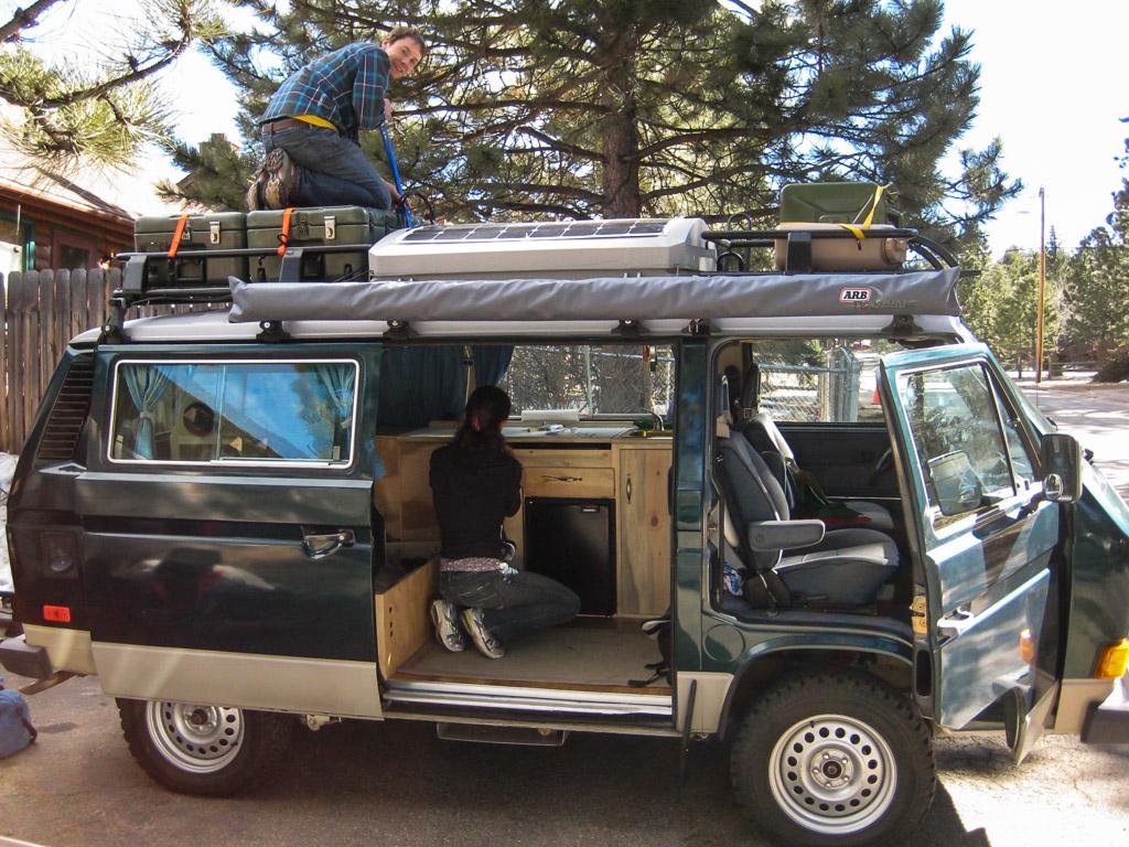

The custom pop-top was amazing. It really made living in the van nice. Even when closed, it provides enough space for me to stand up and when popped it feels spacious and adds some nice ventilation. There are a few modifications to the hinge design that I would like to make, but there is no need to rebuild the entire thing.
Cabinets/Kitchenette…
We love our cabinets. We got incredibly lucky with our first try and got almost everything right. We really like the brass latches that we used. They worked perfectly for our application. The Wedgewood 2 burner drop in stove worked great, and our propane would last us roughly 3 months cooking twice per day with no difficulty at 5000m elevation. The one modification that we want to make is that we want to change our gray water tank set up. It is currently difficult to remove the tank for emptying and got to be annoying to have to empty every 5 days or so. I plan to remove the internal gray water tank, cut a hole in the floor and either drain on the ground or into an external tank situated between the frame rails. Our favorite feature, is the slide out shelves that make great use of the space available. We stole the idea from Brad of Drive Nacho Drive. It is really amazing how much food we are able to fit in it and how easy it to access.
