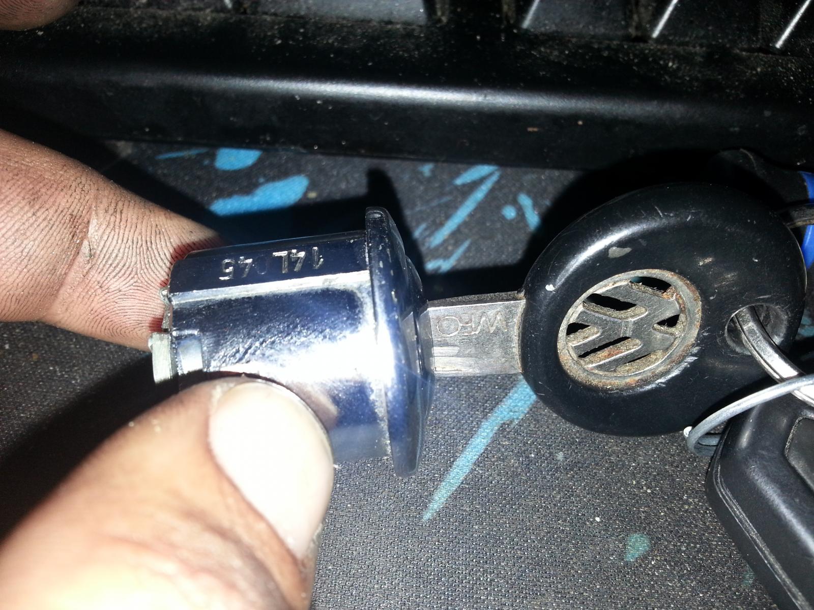

Here's how it's done.

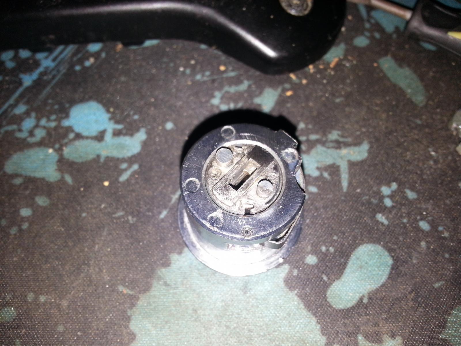

File down the two bronze pins. they've been mushroomed to keep the ignition/cylinder together. May also need to pry a bit with a screwdriver.
Removed.

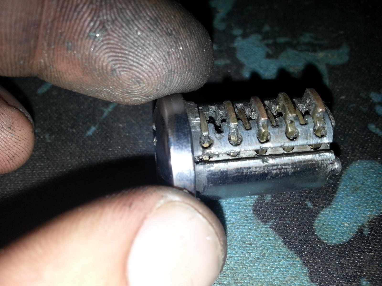

Remove these shims. They keep the wafers from popping out. It's also been peened in. I filled the inner edges of the groove then tapped the under side of each wafer with a small flat head and hammer. Then pushed them backwards with the same flat head.
Once the shims have been removed you can change the wafers.
Reinstall reverse of diss-assembly. Pound the end back on put a dab of JB weld over each bronze pin.
Now my MK2 Golf and T2 Bus share the same key.
