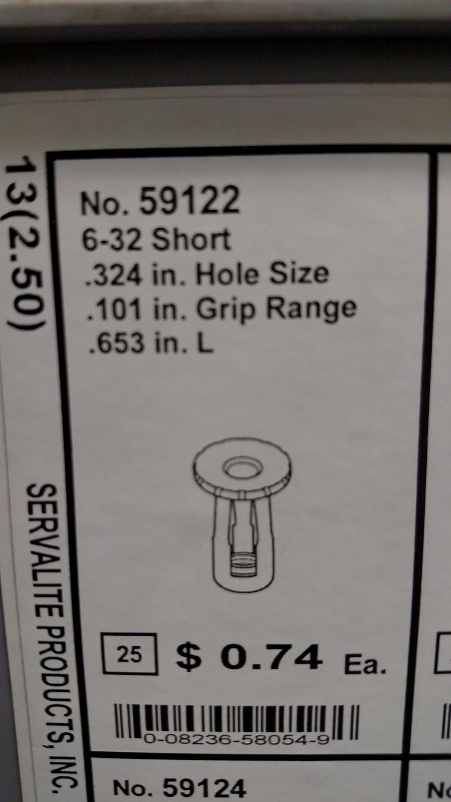

I ended up installing nutserts, then slipping a washer in between the vinyl and trim panel because of the larger panel hole, screwing the panel to the nutsert and then gluing the top of the original clip to the screw head so it matches the rest. The only pics I took at the time are here but conveys the idea.
I'm not home to get a complete "after" picture but it's a permanent solution and aside from the slightly raised area where the washer is under the clip head, looks as it should.
