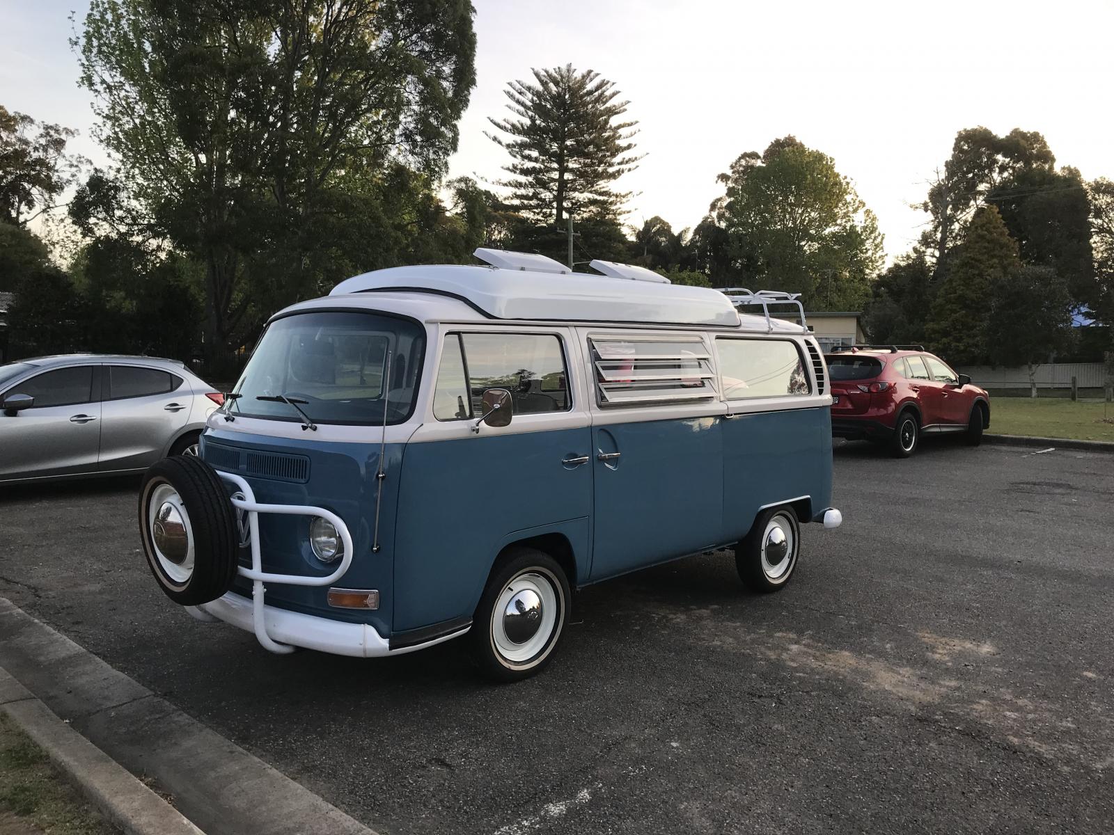

PostPosted: Tue Oct 08, 2019 8:19 pm    Post subject: Re: New to forum. A few questions. Reply with quote
thanks for the feedback. the van will go in for a retune soon and already have raised rthe issues with restorer, howeve just wanted to see about the fuel smell in the short time as i am driving the van around and not overly keen on waiting to fix the smell. as requested a few pics of the van

Itโ€™s a six picture series of the engine, left to right and then two of the bottom that will tell us the tale.
New paint always looks good,itโ€™s 12months later that tells that tale.

Beautiful bus. I imagine itโ€™s probably something small. Good luck
