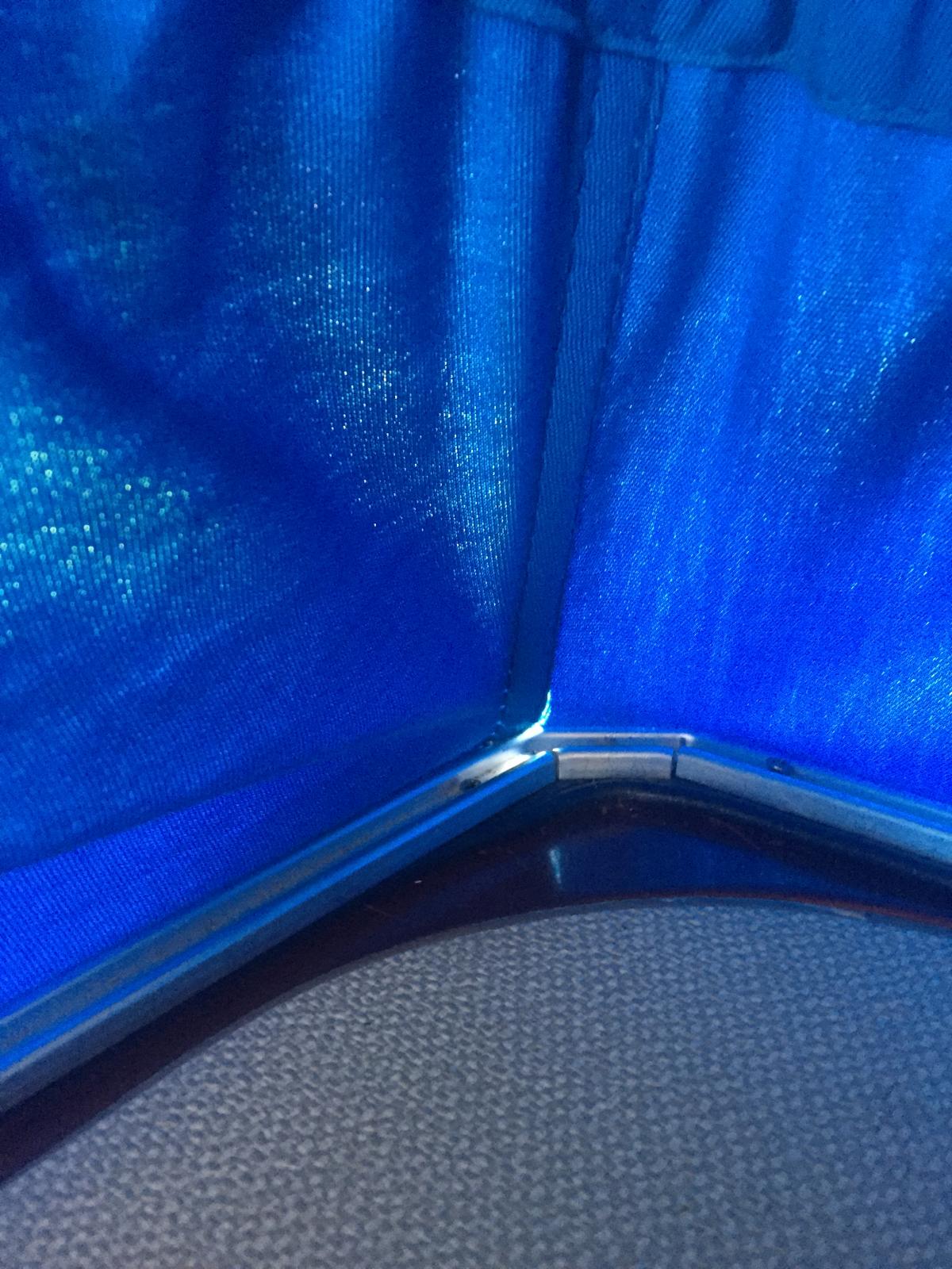

Here is a photo of some corner tearing at a seam. It almost seems (pun) as though the needle used was too large for the thread size on most of the seams.

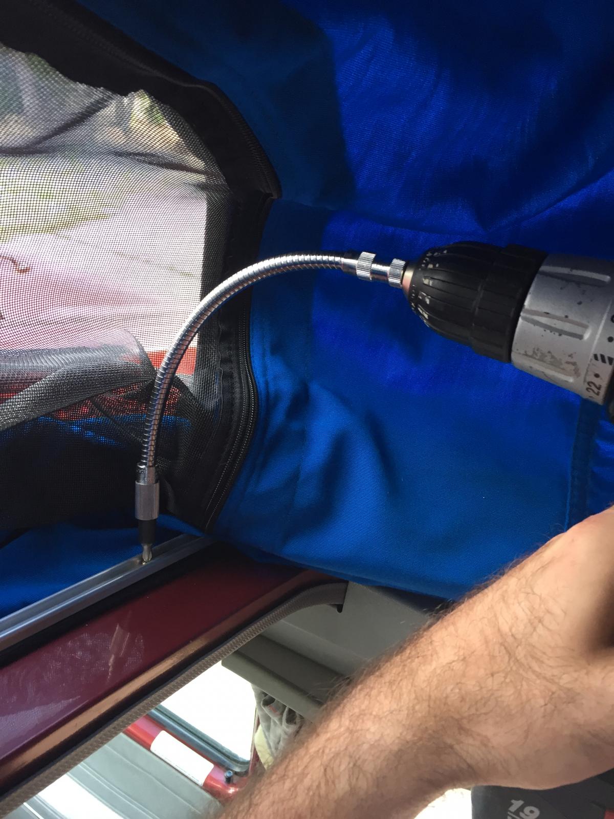

This tool was extremely helpful, despite all the dificulty I had

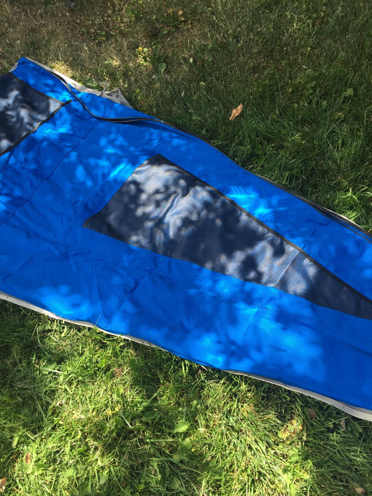

Here's the new tent on top of the old

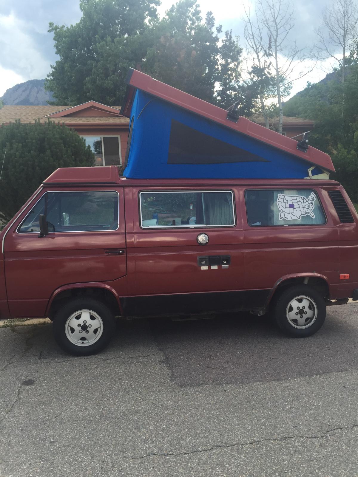

Here's the finished product (it looks great from a far)
I'm leaving it open right now for as long as I can in hopes that it stretches more and won't repull out of the frame.

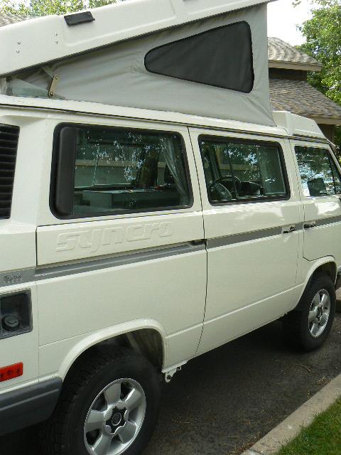

Oh, and yours is not the GW brand. That is a higher quality and I have not heard of any fit issues with it. My pictures are of the last version of the GW in-house brand synthetic canvas.
