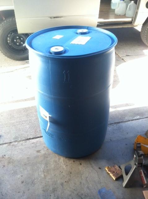

I saw this posted here a while ago on the samba, it was a pretty cool idea and I really liked using the space available and getting smelly parts out of the van.
So, first step was buying the barrel. I found one on craigslist for $20. That seemed about average .

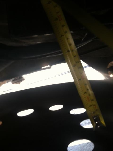

The next was figuring out how tall to cut it. This part got a little tricky
The spare tire measures about 8"
BUT
The clam shell is not flat bottomed. Its middle protrudes higher than normal. The barrel is a little bit small diameter than the tire and will sit on the protruding section and not into the recessed.
(I know the image sucks, but trying to hold a tape measure lying on your side with a cell phone to take a pic is really difficult.
The distance was actually only about 7" and you have to account for the lid height.

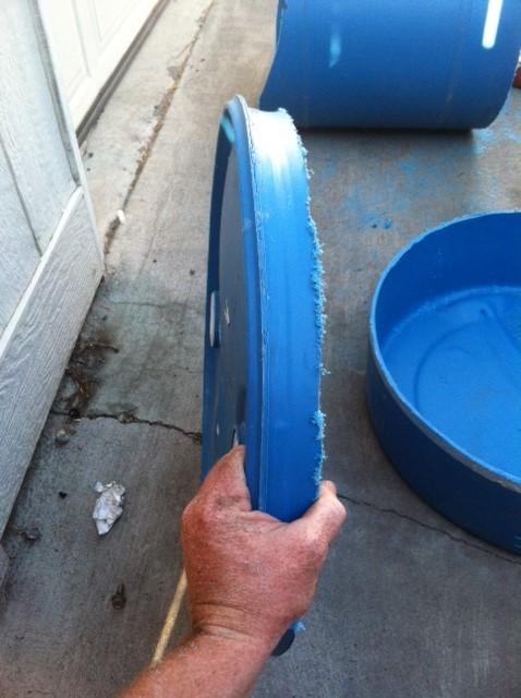

So I went and cut at 6 3/4" I used tape to mark the line for cutting. I used a jigsaw with a wood cutting blade and just simply rolled the barrel as I pushed the saw. Worked like a charm.
For the top, its not nearly as critical. Cut the bottom first because the top has thicker plastic around its support so it wont bend and flex as you cut away from it. The bottom section gets very wobbly as your cutting.
I cant recall the exact length of the top, mostly because I cut right up to the bottom of the inside of the lid, if that makes sense. Its about 1" in thickness all around and you cant cut much deeper than that.

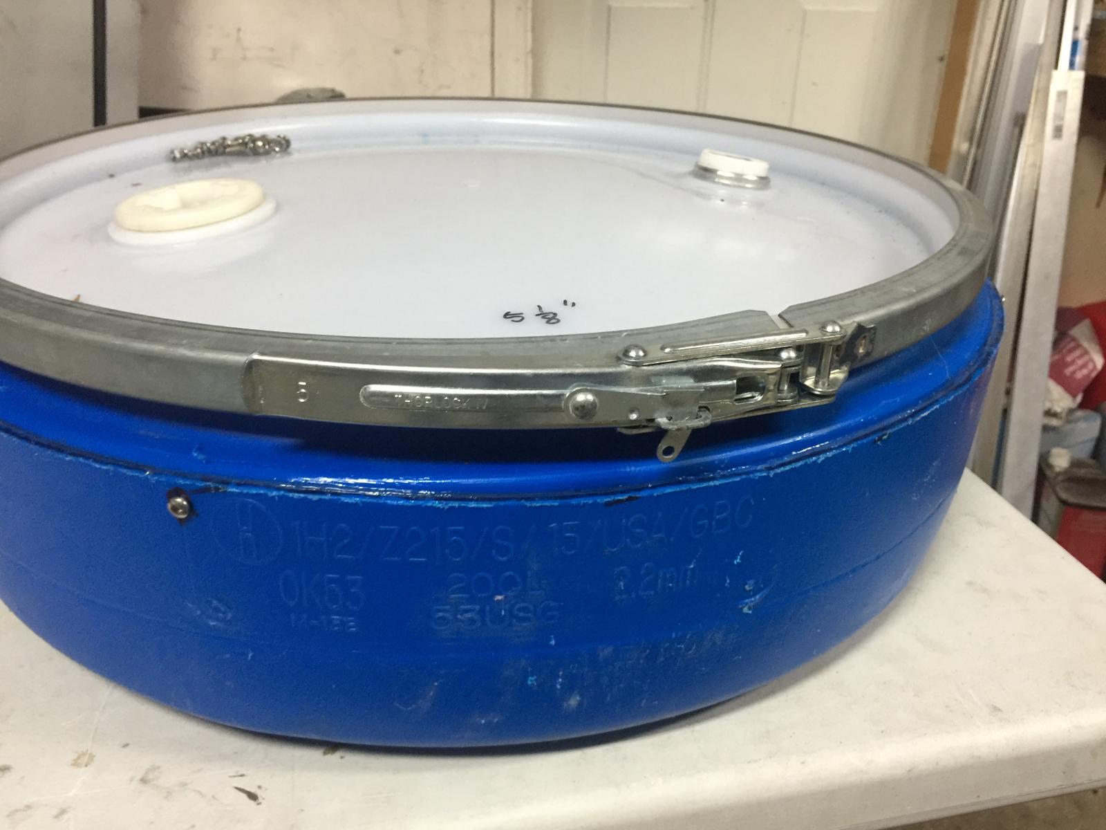

To seal it, I went and picked up some clear vinyl tubing from the hardware store, 7' worth. It was about $1.57 for all of it. I cut it down the middle and stretched it over the lip of the bottom shell. The idea was to keep it nice and water tight. Add some glue or sealant to the inside of the tubing and press it down.
Boy does it ever. I have to stand on the lid now to get it to seat down. I can hear air escaping as I force it down. Getting the lid off takes a little bit of prying to break the air seal. Just what I wanted Cool

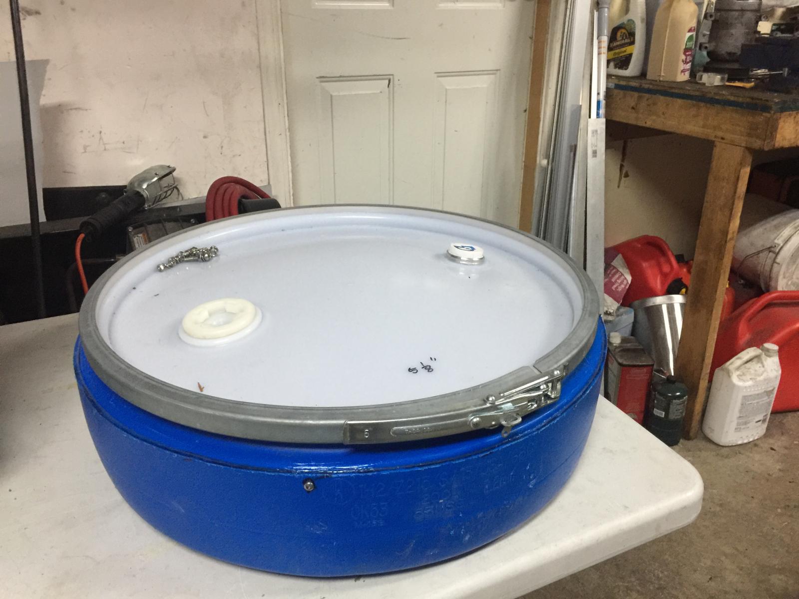

A $4.99 ratchet strap from Harbor freight to hold it all down and VIOLA. Spare tire storage container!
It can hold a good amount of stuff too!
I carry spare CVs and axles, fuel pumps, greases, oils, spare fuel and coolant hoses. The works.
This total job took about 30 mins, not too shabby for an after work project.
