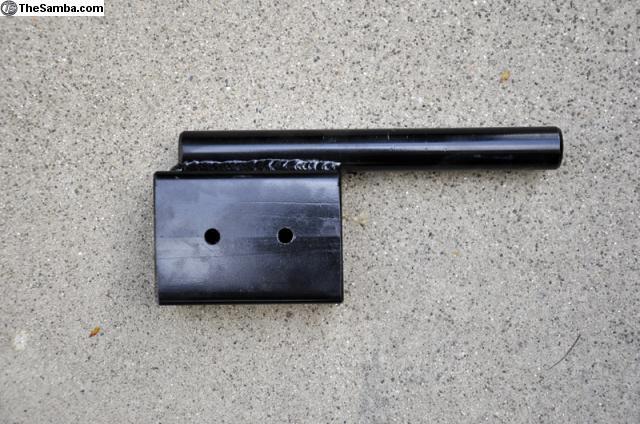

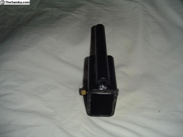

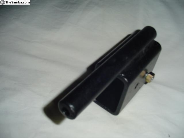

PostPosted: Fri Aug 14, 2015 10:11 am    Post subject: Vanagon High-Lift Jack Extension Reply with quote
Why won't the Vanagon Extension work on a Bay?
Thank you

I actually thought about adding one of these to my bus, on the roof rack, but its crazy heavy. So since your post shows what works for the vanagon, what do people do for the bay?

Kirk, the answer seems to be right there. The idea is simply brilliant. The steel rod needs to be modified or replaced with a section if thick wall square tube bent to conform to the Bay jack point. Could this be something Jeremyrockjock could ad to his wares?

I wouldn't want to be the guy who welds these and then sells them to the general public with the idea of jacking the bus up a substantial distance in the air. All it would take is one crusty bus and one crushed hippy to ruin his day.

BAsically what I was thinking too. And Ditto Jeremy. His roo bar mounts look like those things. I have his towbar and roo bar. If he built one I would buy one.

They work without the adapter on the stock spot, but it's really tight and you'll scratch the shit out of your paint. The one from Gowesty should work, or a tube bumper Cool
