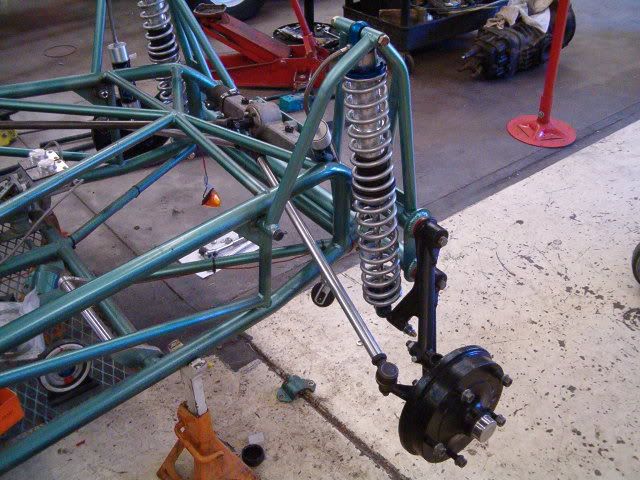

I wonder what would be a good deign for a lower mount?
Here's a setup on a rail that I think could be closely done on a bay beam. Would be tight though.

Brian wrote:
Really it's just about welding some extra junk onto the beam. Making sure that the beam doesn't collapse nor the bottom mount shearing off.
We should throw rear shocks into this mix soon too Wink
I know a lot of the buggy guys do the single-shear mounting point with lightweight rigs but its a big no-no in the Jeep/rock-crawlers/off-road truck world. I would find a way to make the mount double-shear if running coil-overs on a bus that sees any time on the road. Something like this for the lower mount:
Here's the guy making them:
http://woodsbuggy.com/phpBB3/viewtopic.php?t=15970&p=150868#p145506

I just checked and in reality I think you could only fit in some 2.0 shocks. I honestly think that as long as you don't hit it severe extremely often, stock mounts will hold up.

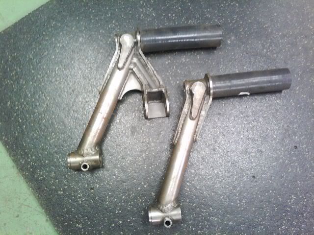

Check out picture #2
