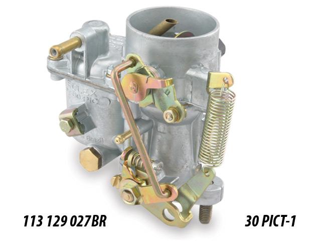

Go with a 30 PICT 1.
Not my photo, sorry. This is.
Eric&Barb
Joined: September 19, 2004
Posts: 26264
Eric&Barb is offline
PostPosted: Mon Feb 02, 2015 7:30 pm    Post subject: Reply with quote
That is a 30-PIC carb in the image.
Agreed a 30-PICT-1 would be better if used in a post-1960 VW.

Eric&Barb wrote:
I use a 30-PICT-1 in my stock 1600 SP - runs great. As a back-up I have a near-new 30-PIC just like the one in the photo (mislabeled 30-PICT-1). But it does run like crap - barely idles... I've read recently that it's for 36 or 40 hp engines and I read here that it's not so good for post-1960. But since I have it... what if anything can be done to modify it for better results??
Eric&Barb
Posts: 26264
PostPosted: Sat Aug 15, 2015 7:08 am    Post subject: Reply with quote
Clean the carb out and jet it for your size of engine. The 30-PIC is more for 1300 and later engines. The reason it is so great for pre-1961 VWs is it has the manual choke which those early VWs had as a standard item.
A 28 PIC or PICT would be better for 36 or 40 HP engine, and a lot easier to find.
