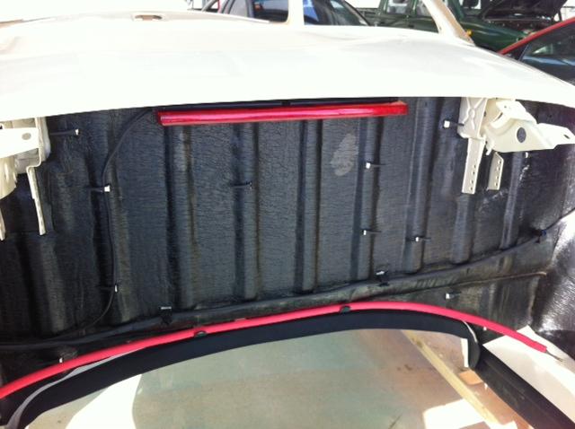

I used the same flexible LED strips with adhesive backing, but I mounted them to a strip of aluminum bar stock and used two beam clamps to fix the bar between the hinge mounting points. I added the tie wraps as a safety measure in case the adhesive breaks down from the heat - I don't know what the fan would do with those LED strips if they came loose!

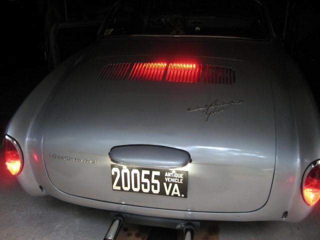

I used just one 19 inch strip for my third light. About $12 bucks from Superbrights. I have the early (no rain tray) decklid. Since my car was freshly painted I just had to wipe down the front edge of the vent. Feed the strip in and start removing the backing. Worked my way across pulling the backing off and pressing the strip down. The elec hook up is directly off the brake light. I used a double spade connector and ran the wire back up the loom and exited in the center of the deck lid. Ground to one of the lid mount bolts. 3 years and the adhesive has held up perfectly.
Wire in center.
Tail light wiring
LED strip
Done

Thank you Darrell! I now understand how you just stuck the adhesive strip directly to the the front edge of the metal rain tray. I'm guessing I have to remove 45 years of dirt, oil, and oxidation before I give it a try but it looks good. I may put one strip on the fire wall as third tail light and the other in the tray as a brake light.

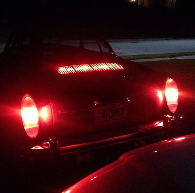

kind of looks like a fire
View user's profile Send private message Send e-mail AIM Address Instagram Gallery Classifieds Feedback
kiwighia68
Joined: October 20, 2013
Posts: 2953
kiwighia68 is offline
PostPosted: Wed Nov 18, 2015 12:55 pm    Post subject: Re: Mounting LED light strips as 3rd brakelight Reply with quote
And still the guy behind you stopped just inches away, eh?
