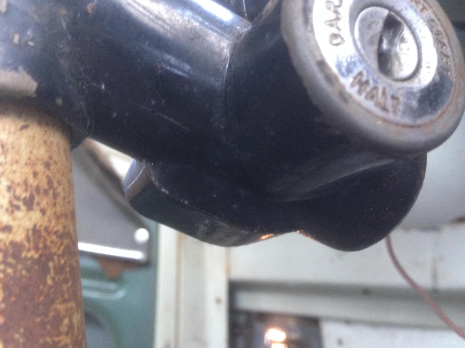

is this the place to get the cylinder out ? Any tool i can use ?
I tried a smal pin to push on it but no luck. In wat stand need the key to be to get it out

PostPosted: Thu May 17, 2018 10:39 am    Post subject: Re: Neiman steering lock - no key Reply with quote
Yes. The pin has to be pulled out most of the way.

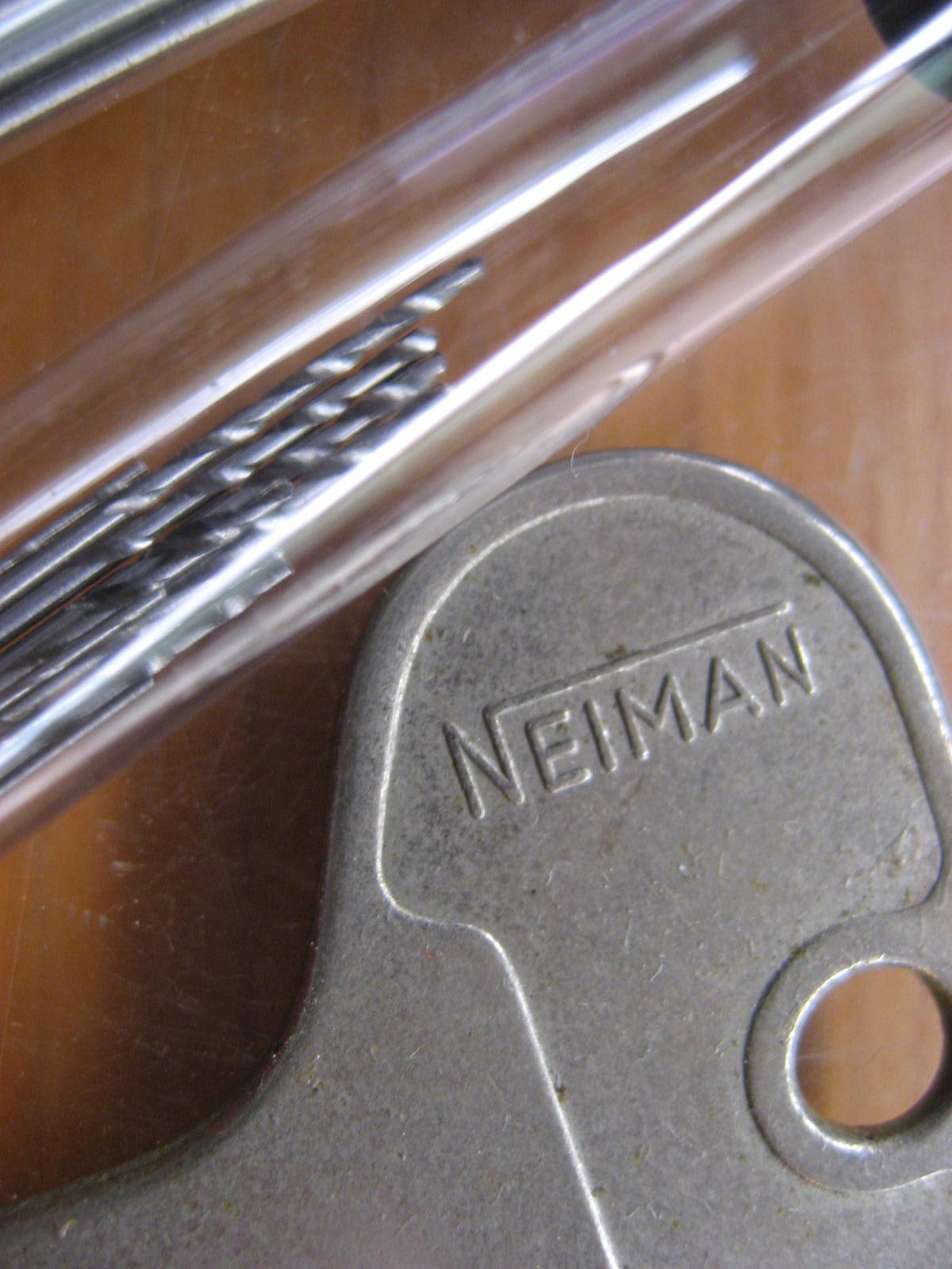

Old locksmiths used to have tiny drills to make a hole in the center of the pin and little screws with a tiny slide-hammer to extract it.
Or you can drill a hole on each side of the pin and use needle-nose pliers or a hemostat. Then when you put it back use a larger screw and grind the slot away after intall.
Vermeulen wrote:
In wat stand need the key to be to get it out[/img]
Put key in and turn before pulling pin then pull out on the barrel with the key in.

Before assuming the key is worn, there are so many more reasons that the barrel won't rotate freely. It could be the steering wheel is turned and holding the tongue. It could be the inside of the lock barrel where it transfers the pins and has springs.
But try this first before you rule in the lock cylinder; on the left side remove the wire cover and take off the two screws then pull away the whole electric mechanism then retest the cylinder. If the cylinder turns free then the problem is in the rotating electric switch.

PostPosted: Thu May 17, 2018 9:25 pm    Post subject: Re: Neiman steering lock - no key Reply with quote
If you mean this thing , problem stays the same , verry difficult to turn , i need to play with the key
there is alot of play on the key in the cilinder , thats why i think a new key would maybe help a little. or alot
I need to play with the key to get it turned , i even got it in lock but it took me like 3 min to get it out again. Really had to wiggle and push and pull the key while turning .

PostPosted: Fri May 18, 2018 11:07 am    Post subject: Re: Neiman steering lock - no key Reply with quote
Get the lock out and post pictures of it. You can remove the two steering column bracket screws then there is a bolt behind the speedometer pod that must come undone. DISCONNECT THE BATTERY before the next step. It is very hard to get to but with a 13mm open end you can loosen it. You almost need a child's hand to unscrew it. Unlock the lock and the whole thing can be lowered to use a drill on it.
I use these little drills and tool to remove one in place or on the workbench.
I have the little hand grip chuck but I put it into my drill motor.
Sometimes just going up one size drill and it will be tight enough to pull on the pin.
These can be used to go down the center of the pin or drill around the pin.
You most likely need to grease your main lock to the column mechanism too.
