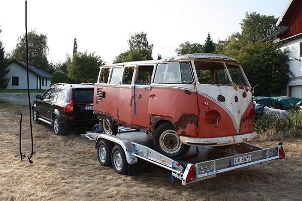

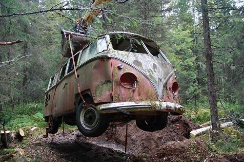

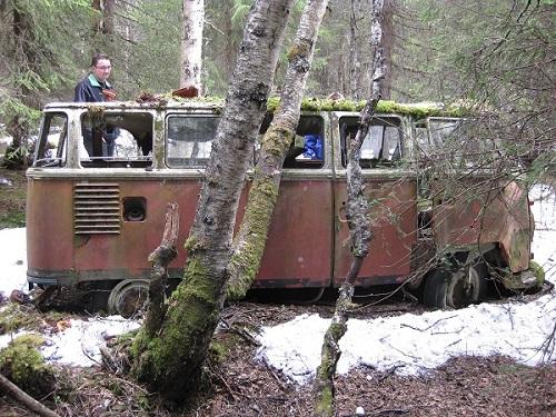

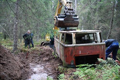

Well, I dont have many exciting pics from the rescue. The big bad yellow machine made it quite easy to remove it from the place where it had been sitting for all those years. Lots of thanks to the gentleman in the drivers cabin for lending us his machine and helping us there.
Got a Picture of it as found.
Another one when we started to lift it.
The last one as it sits now, after washing it With a high pressure steamer.
The idea is to keep the body mostly as it is, and replace the rusted out frame. Received the front floor and some other metal parts today, and I think they were the last pieces of the Puzzle. So, I Guess it is time to start the fun pretty soon....
