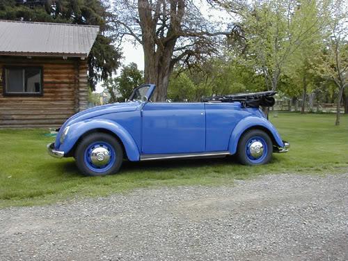

PostPosted: Tue Sep 22, 2015 9:53 pm    Post subject: Reply with quote
OP, you’re going to hear a lot of noise on the Samba about how bad one piece windows are, and they might be right. I’ve never owned the kit type they sell for sedans so I can’t argue how well (or badly) they work.
But if you really like the look don’t let the nay-sayers scare you off, I’m sure they can be made to work well with a little effort… where there’s a will, there’s a way.
I wanted one piece window in my custom vert, I really wanted the look of the chopped windshield alone without the wings. So I built my own, built the tracks, had the windows made and modified a set of later cable type regulators to do the lifting. The door windows are frame-less as are the quarter window. If I can pull that off I’m sure you can make the sedan kit work.

Thanks for posting those Gary!
And . . . nice job on yer convert windows! That must have been several times more difficult than installing one-piece windows in a sedan!

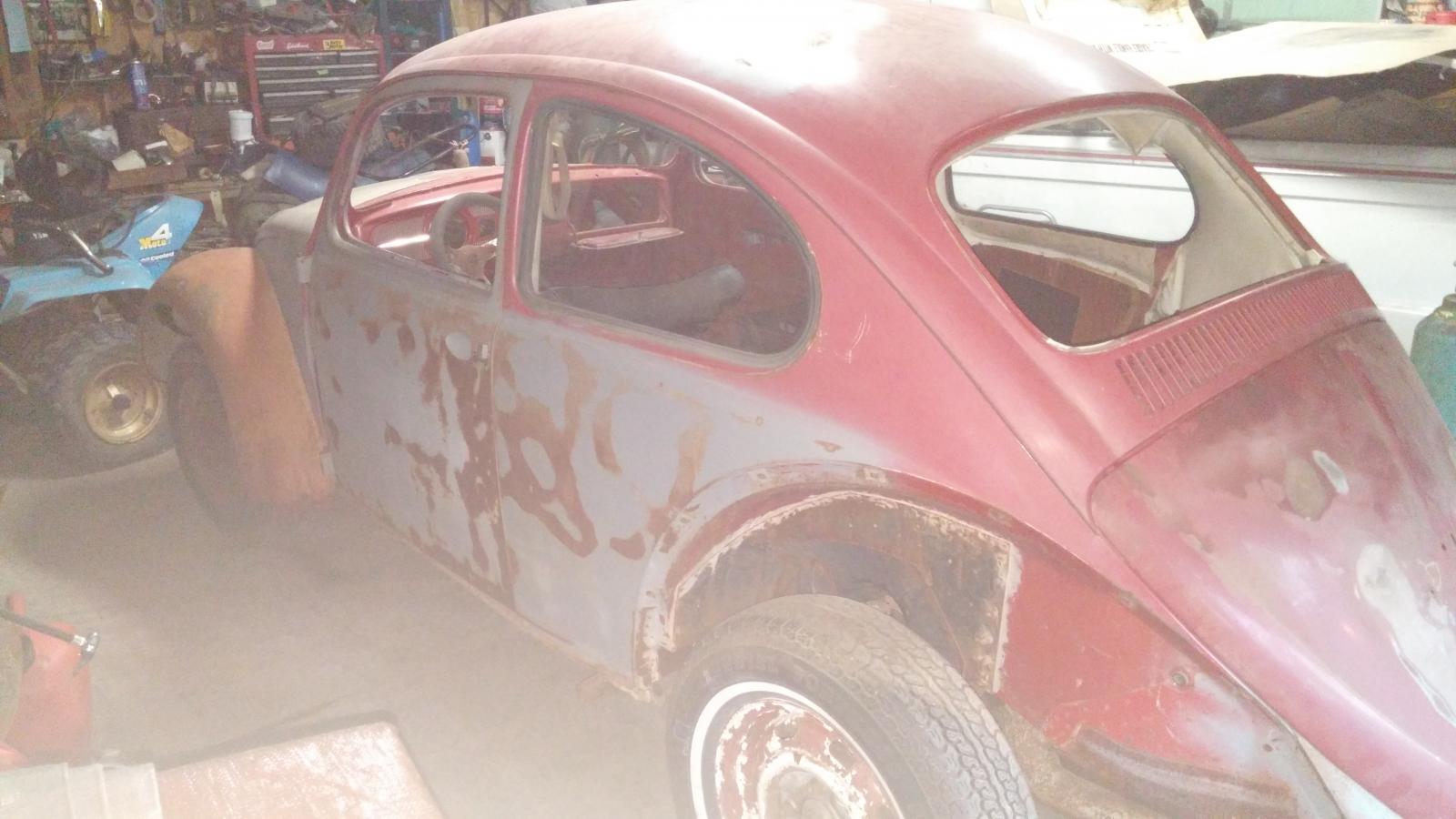

PostPosted: Thu Sep 24, 2015 4:33 am    Post subject: Reply with quote
Here is the other side of the car. The PO did a pretty good job patching the rusted areas with metal and pop rivets. I plan on welding some areas for extra strength, but he did a good job with what he had. I purchased the car for $500 and have added another $250 so far. I am looking local for a parts car to scrounge door handles, gauge cluster, the right steering wheel and etc. 20 years ago there was a bug in every field, not so much anymore.

PostPosted: Thu Sep 24, 2015 10:10 am    Post subject: Reply with quote
teched wrote:
This project car I baught is a 1968, but the doors are earlier. . . . Here is the other side of the car.
What leads you to believe that those are earlier doors? Look like late ones from here!
If you want to, show a photo of the inside of the door and we can help pinpoint the year of the door for you.
