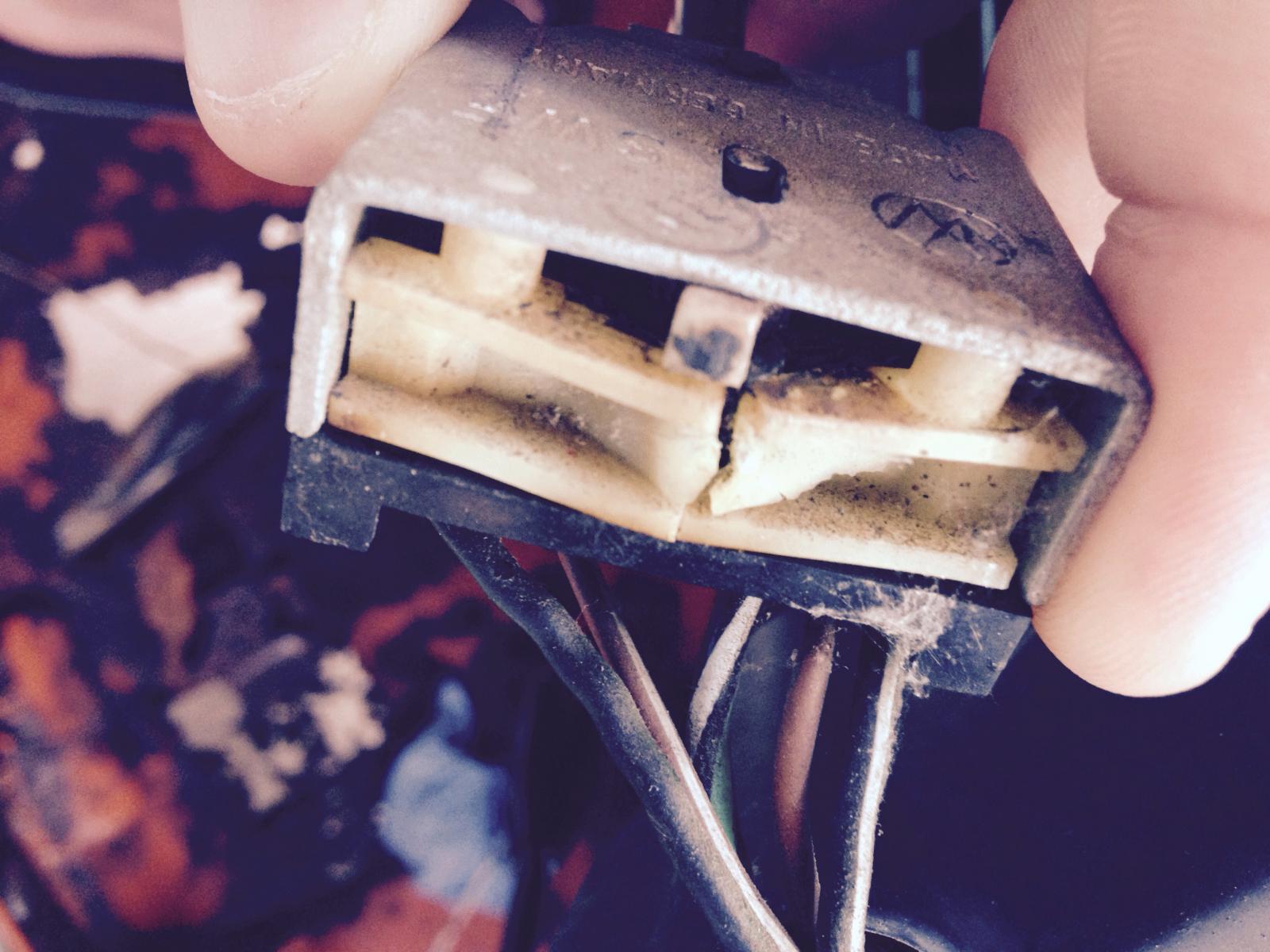

It seems as if this particular setup was only used for the tier end of 73 and a couple months in early 74. Doing electrical inspection and tracing, I noticed the entire plastic casing inside with the Actuator is completely busted, assuming from use. I live in Arkansas, where folks do not use turn signals, but I do have respect for others, and want to protect my bay in every circumstance, so the search for the part continues.

I haven't really torn it apart, my issue is evident without the need of opening up the housing. Removing the steering column housing that goes around it, I noticed looking at the back where the soldered wires are visible that the plastic square part that the arm pivots in has cracked in the center, as you can see in the photo. I feel a little better knowing now, I'm not the only one trouble by this rarity.
Thing is just snapped right in half.

take it apart, take out the broken piece, glue it, and take it to be 3D printed.
OR, maybe, that particular piece is the same in other years.
or is this still available? http://forum.earlybay.com/viewtopic.php?f=11&t=67357&start=0
or this? http://www.evamclassic.com/split-bus/groep-9,-elektra/53.-richting-aanwijzers/p-1/

Or if you could glue the cracked piece and then make a silicone mold and make a replacement piece with some resin. Might cost you $30 and you would have lots left over to make other stuff.

so, does anyone know if that cracked piece is the same in an early or late bay switch? just swap the broken piece? I understand that the switch of the OP is different, but HOW different?

I know its different in my 79 and the parts would not be interchangeable.

This is the exact same one in my 74. Knowing how rare and expensive these are to replace I might have to watch the young kids more carefully as they yank and switch it back and forth while playing in the drivers seat Shocked Shocked

sell the old one as a repairable/parts piece, to get back some of that hard earned money. or, if you a typical bus guy, put in in the parts stash just in case

bad thing about turn signals is they are not really repairable... you can't really do any soldering on the assembly whatsoever or the platic just melts before you can even flow the solder. I ruined an old bug signal switch trying to fix it once and I can't ever really recommend trying to repair one.. Nice to see you've got an NOS headed your way. I'll be passing through LR Sunday night on the way to Texas - do you drive your bus around town?
