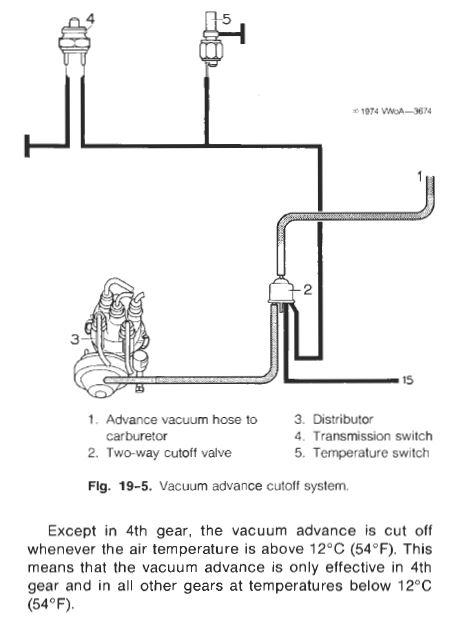

PostPosted: Sat Oct 17, 2015 8:48 pm    Post subject: Vacuum advance cutoff Reply with quote
72-74 Except 74 Manual Trans.

And you don't want that vacuum advance cut-off switch hooked up.

Remarkably that system is one of the few things VW put on that really detracted from performance, it's a way to get around new emission laws that came down that year and it does marginally reduce some sort of combustion byproduct, but the extra gas used to overcome the loss of power likely cancels that out in the big picture. Put it in for decoration if you are building a museum peice, but it'll be a happier bus if it doesn't work.
The vacuum advance cut-out helped to keep the air injection exhaust afterburners hot and active around town. You think I kid . . .
Remember, every VW under full throttle has no vacuum advance, so it wasn't that noticeable of a deterioration in poerformance.
When i think of how many FI buses-with-leaky-EEC-valves are out there with utterly no vacuum advance as a result . . .
Colin
Excellent point!
So if running the complete full meal deal smog system it's useful, aside from that not so much.

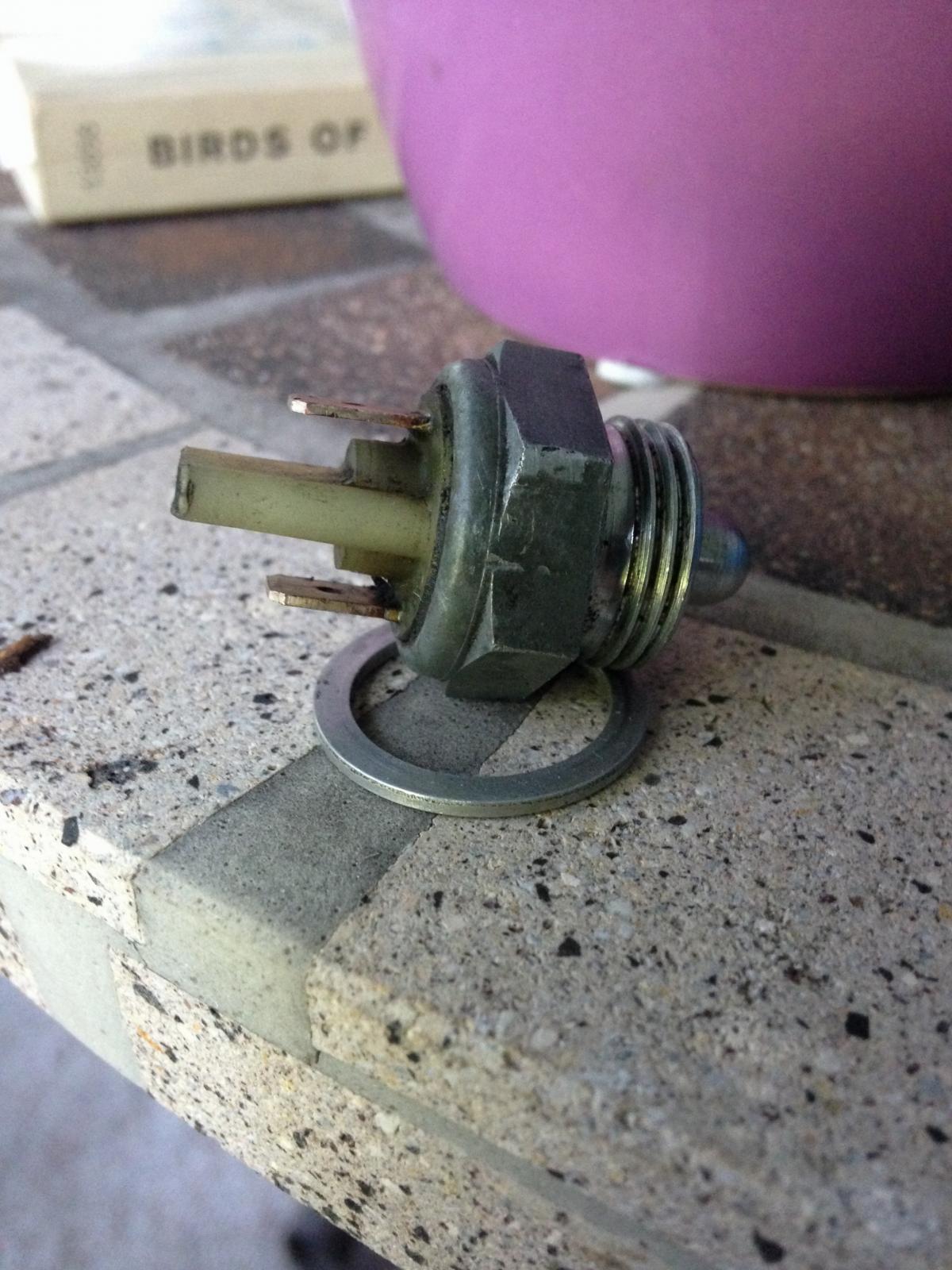

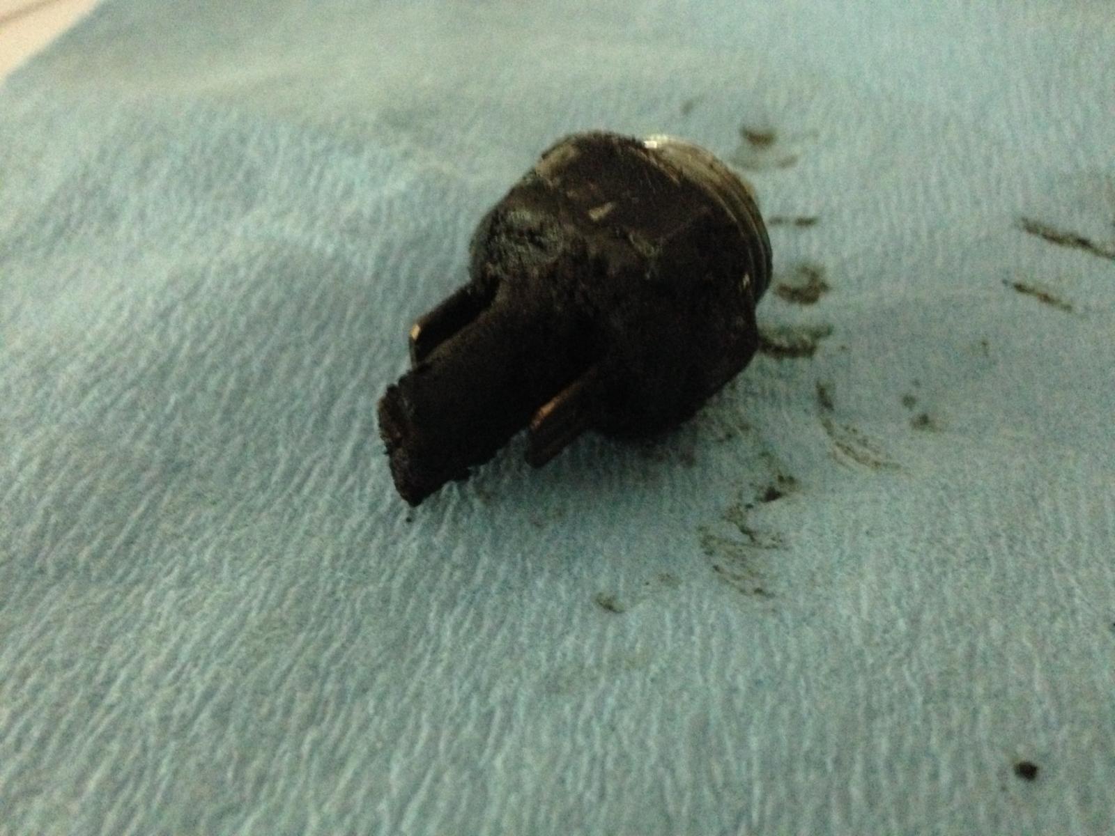

PostPosted: Sun Sep 25, 2016 5:08 pm    Post subject: Re: Reverse lights question 1974 Westy Baywindow Bus Reply with quote
So doing some research on why my reverse switch wasn't working, I came across the issue of incorrect wiring.
Regardless I removed the original VW switch, cleaned it well, and hooked it up. As mentioned, one black wire (with inline fuse) goes to the (15) terminal on the ignition coil. The other black wire coming from the switch goes to the covered spade out of the left rear taillight housing.
Here it is in its 40 year old oily glory:

Cleaned up and installed on the driver-side of the transaxle, you can see the part # of the VW reverse light switch. This is on a 74 manual Westfalia.
