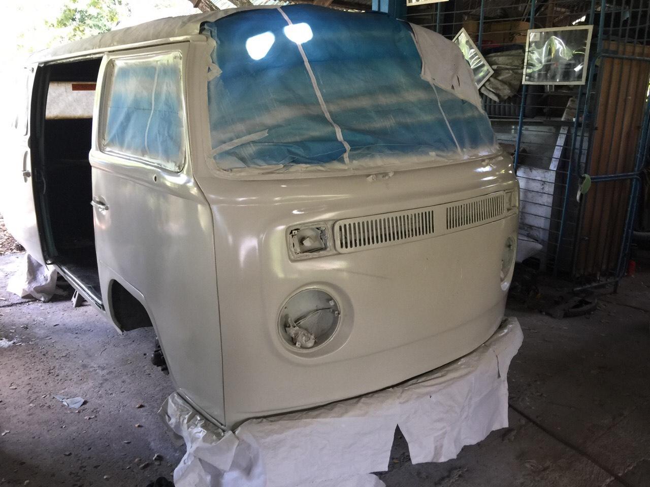

good day to all. i'm from the Philippines. just wanna share my project and seek some advice. Smile
here's the concept idea i made from busselecta.com
let the painting begin
still under rustoration x paintjob
that's all for now. i'll keep you posted for new updates.

DIY painting

here's the question for the model.
1. front signal light up
2. big rear tail light
3. supposed to be square bumpers
4. no walk thru and have bench seat with reserve tires below the seat.
any way's im not a purist but we love our rat bus so much and enjoying building and cruisin. VW's still a VW. Smile

PostPosted: Tue Nov 17, 2015 7:04 pm    Post subject: Re: 1972 rat BUS-tard hoodride project Reply with quote
Weird Bus large taillights-- high front blinkers ( nose replaced ) small rear air intakes (71 down ) no lips on front wheel arches - 72 had them early deck lid

mabuhay kabaBayan. Looks like your bus is a 1973 model. The blade bumpers may have been installed by the previous owner. Or it is a 1972 bus and the signal lights below may have been shaved in lieu of the signal lights grafted on both ends of the fresh air vents. Looking on the pictures it seems like the signal lights were merely grafted. Although your queries will be answered by looking into the VIN number. It may be a 1971 though, the rear air vents tells us so... pretty confusing....
