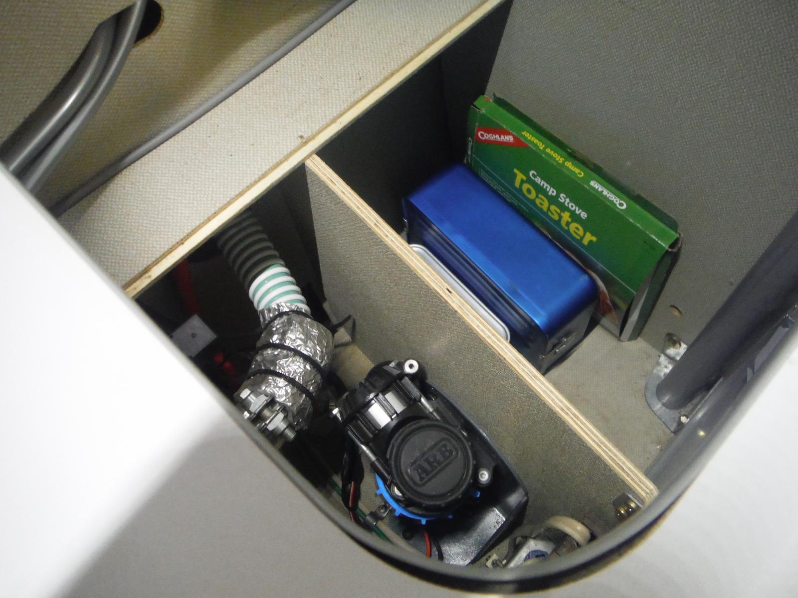

I mounted the compressor in the galley cabinet, just forward of the refrigerator. This provided an indoor location where I had good access to the area needed for the backing plate installation, and ensured low moisture, low dirt, good ventilation (the entire back side of the galley is ventilated through the grating behind the lid) and good noise suppression of the compressor (and this compressor is already very quiet). This is also relatively dead space in the van, so it didn't hurt to add the compressor here, as opposed to under the bench seat, where I am constantly storing items and constantly going in/out of that space. Lastly, this is a relatively solid (1/2" thick) cabinet wall in the van. Since my 12v distribution panel is already in this area, the wiring runs are kept short and easy. The AN hose, terminating in 1/4" NPT male fittings on both ends, connects to the compressor manifold on one end and the 90 degree F-F 1/4" NPT elbow at the hookup box behind the refrigerator. All NPT fittings were wrapped in yellow gas tape, but pipe dope would also work as well, if not better.

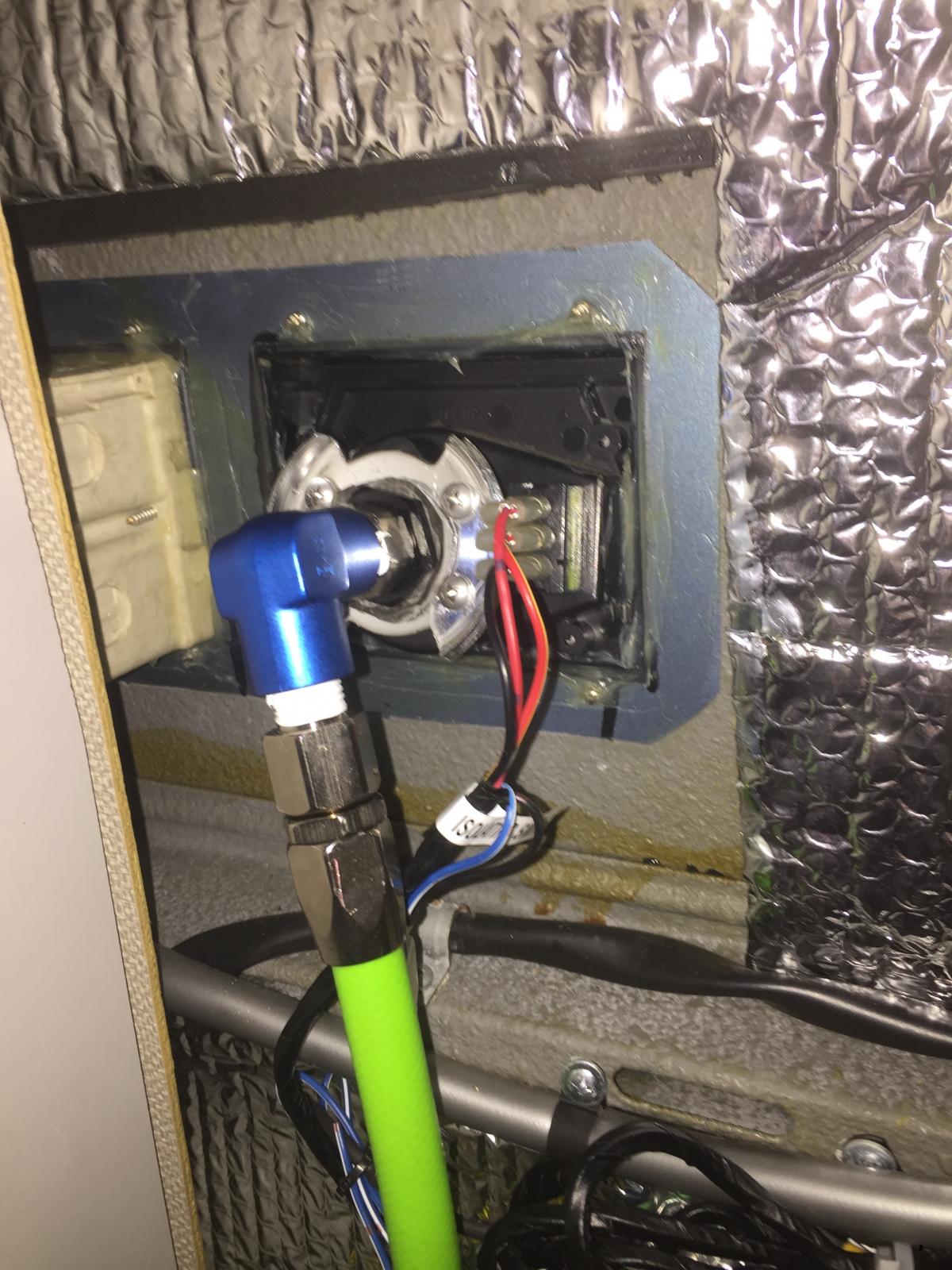

5. assemble AN hose and install with elbow on air hookup box
6. install air hookup box and AN hose on compressor, routing the hose carefully and with consideration of refrigerator, water, and electrical routes

The hookup box connections were made on the bench, not with the box connected to the van, so the assembly was straightforward. Drill the 1/2" switch hole, install switch, install air hookup, install elbow, and install AN hose.
Snake the hose through the sheet metal wall of the van from the outside and install the hookup with four screws. Route the hose to your liking inside the van and connect it to the compressor.

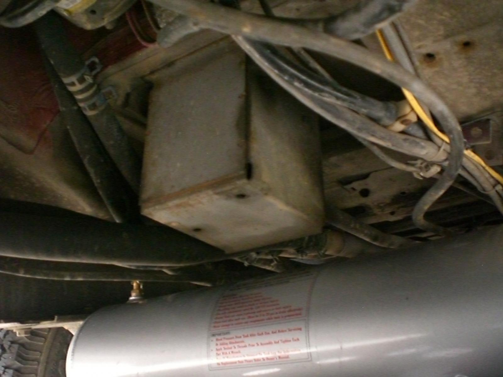

Thats cool. I did a similar install with same ARB compressor on my pickup, and used a 3 gallon tank ( 7" diameter x 20" long ). Some outfit on eBay ($29, Nov2015) seems to have a lot of these 3 gal tanks.
You can make an air tank out of thin-wall pipe that would be easy to stow on a Vanagon. 1 gallon is 231 cubic inches. Using 4" pipe, for example, every 18 inches is one gallon. Or buy a tube-bumper. If you add a tank be sure to add a pressure relief valve, here's one at 150psi .

I like the look of those tanks on eBay... that gives me some ideas for a possible tank. I hope someone else has an idea like that. Great discussion--let's keep it going.

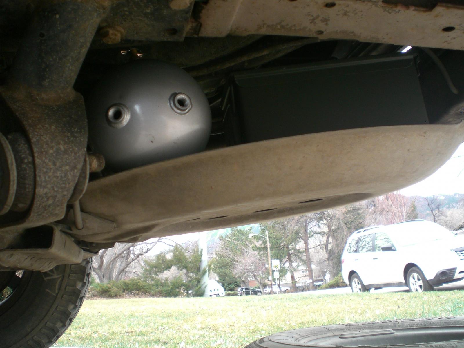

Check out the various air ride vendors for tanks and compressors, pretty compact since they are usually going into Golf sized cars.

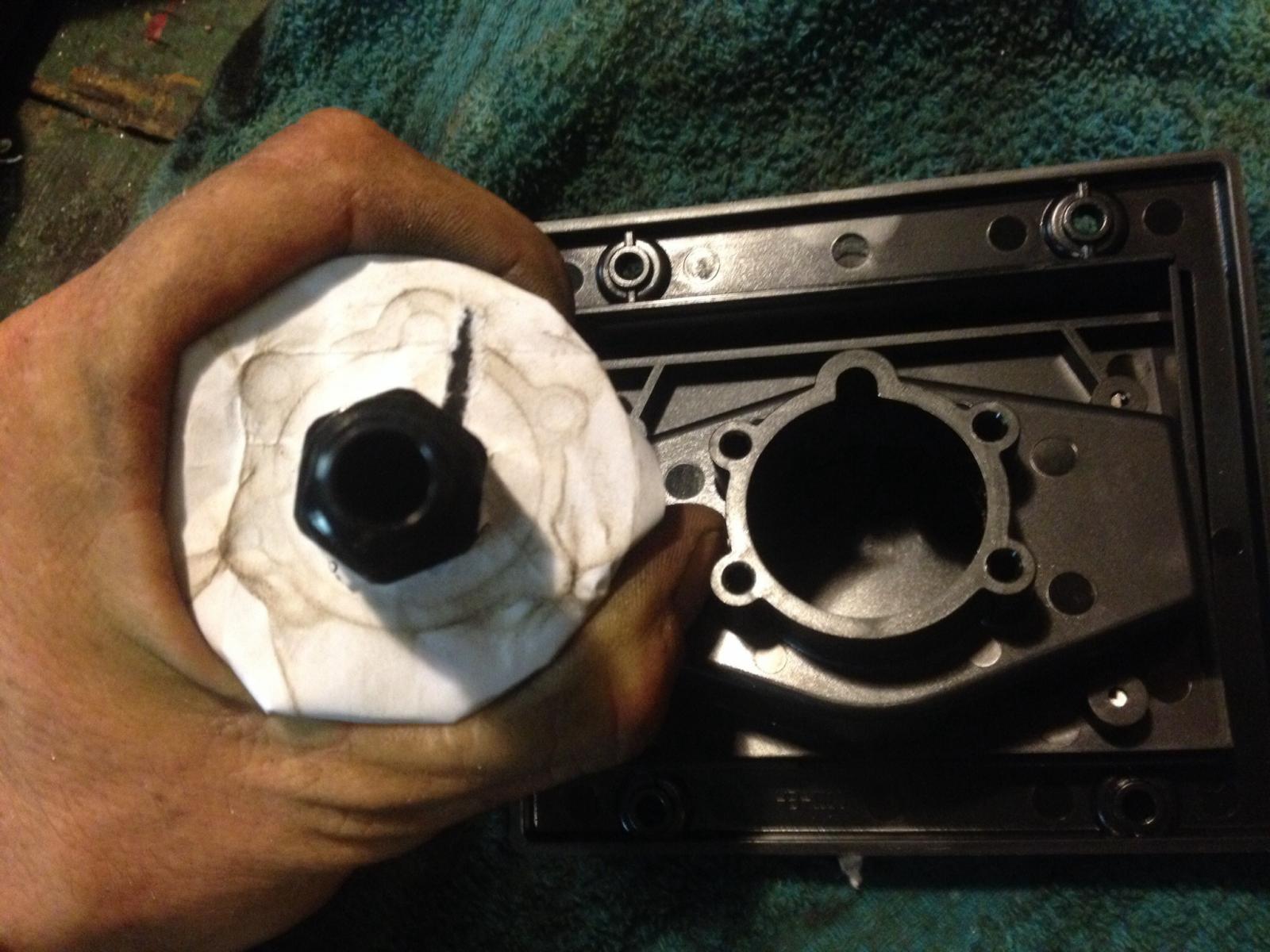

I have the ARB compressor from Das MUle bought last year on sale.
I just bought the Go Westy air hook-up, but I find it annoying that they don't sell the just fitting and mounting plate separately: most people buy a compressor and it comes as a kit with a hose. I didn't want to pay and end up with a second hose and fittings I do not need. Lame to not have the option.
I carefully looked at their pictures and found out plates where also sold for other cars but with slightly different edges.
SO here's what I ended up doing for the air hook up, compressor will be mounted way later on this on going project:
Cheap aluminum air fitting from Home Depot, I cut a notch with a hacksaw around 360° and then opened the notch on 180° for the second overlapping plate
Cut some plates out of aluminum Quick Mount flashings with a hole saw, then cut the notches with a bandsaw and opened them with a stone wheel on the bench grinder (perfect thickness of the wheel). The fit is tight on the fitting:perfect!
Marking the housing holes with a sheet of paper to drill the plates
VoilĂ

Here's where I put my compressor. It takes up no space that we would be using otherwise and I can still access the filter (probably need to every 15 years). It was a major hassle to install it here and I even paid to have a bracket welded up.
I followed the ARB instructions to a "T" and I'm thinking I want to change that. If I recall correctly, the supplied "Compressor" switch triggers the compressor - not the relay. The other wires, that ARB says to connect to switched power (and the relay), I have going to my blue alternator wire under the driver's seat.
That works great but I need to have the engine running if I want to use the compressor. That's exactly what I want if I'm inflating a car tire BUT annoying if I just want to top off a mountain bike tire.
So, I'm considering another place for the "switched power" switch, Having a little switch under the air connection flap looks like a great idea. But where to "T" into power there?
'91 Westfalia GL Automatic (GTA "Turbo" Rebuild w/Peloquin) and 2.3L GoWesty Engine

I finished up my install yesterday and here are a few pics of my location and details on the wiring. It was quite a bit more simple that I originally thought as the wiring harness has so much extra wiring bits for the other switches that if you're using this simply for the single compressor port it's really quite a basic install.
Again I chose to place this right above my propex heater located in the right side "top opening" cabinets where the rear table pole resides as this was my dead space:
I bolted the compressor through the dual wall into cabinet where the refrig used to be, now just a cabinet. You can see the backing here. I had to get longer bolts to get through the wall thickness. I would have preferred having flat bolts on this side to avoid rubbing, hitting anything but I couldn't manage to bolt that direction due to the limited space where the compressor is located. Not enough to get hands and tools in there while holding the compressor up:
The wiring loom and hose easily goes through the hole in the back panel of this space. For the wiring as I mentioned I ran the 3 wires that connect to the battery:
back through under the bench to an aux battery that I have back there. The other part of the wiring that goes from the harness to the compressor switch I routed through the back panel and up to the port the with the hose. There's already a hole back that's quite large. For the wiring I used the red, red-yel and blk wires that were connected to the isolation switch to connect to the 3 prongs on the illuminated switch:
The red-yel wire (that's supposed to go to the ignition wire) I then ran to the cabinet under the sink where I have a fuse panel that connects all aux powered components to a switch that switches my 2 aux batteries. This way I can run the compressor from the outside switch and if for any reason I don't want the compressor to be turned on I can simply pull the fuse on this red-yel wire.
Here's a few pics of the front and back of the hookup box:
Here you can see how I just wrapped the unused bits of wire from the harness and zip tied them to the wall:
Front of hookup box:
Cabinets all sealed back up:
I'll report back on any fun use cases that I run into. The big ones that I foresee are these tires and other car tires Wink as well as bike tires and lastly camping mattresses for tent camping. The 12v camping mattress inflator motors are loud, weak and never get the mattresses inflated well. I'm looking forward to using this new little tool in my adventures.

Looking to install my Viair 325c compressor and this thread is a great resource. I got it off craigslist with a 2.5 gal tank as well. I have seen someone post about mounting a similar system in the clamshell, but can't find that thread now. I find interior space very valuable in the van, so hesitate to use it for the compressor, though the space next to the fridge or behind driver seat battery compartment are candidates. I would like to put the tank in the clamshell, giving up the crumple protection of the spare, since my spare is on the rear anyway. Could also possible put it along the frame rails where a propane tank might go on driver side? The big question is where to put the compressor? I understand that they are splash proof and sort of hearty, but I do cross the occasional deeper stream and it is not submergible.
My current idea is to put the tank in the clamshell, hard mounted. Have two smaller ammo boxes for the compressor and hoses. I will rarely need to air up, so dropping the clamshell won't be a big deal. The ammo boxes could be hard mounted to the clamshell, with some sort of sealant around the bolt holes. Alternatively, I could just strap them down securely, since there are handles on the outside. Hen when I need the compressor to run, I open the clamshell detach the ammobox, connect the compressor to some sort of pigtail that is secured under there (!) and go for it. Just writing it down, it sounds like a pain, however!
Anybody done this kind of thing?
-macjack
87 TDI Syncro Westy
81 Westy (sold)
80 Rabbit Wolfsburg (rolled)
Bike as primary transportation
macjack
Joined: February 26, 2004
Posts: 357
Location: Colorado
macjack is offline
PostPosted: Mon Mar 07, 2016 3:37 pm    Post subject: Re: Air Compressor (on-board compressed air) installation thread Reply with quote

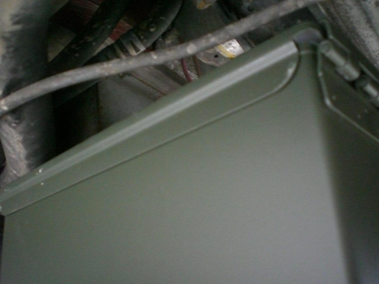

So here are a few photos of my clamshell ideas. The tank and boxes all fit without interference. I found some dust caps for the air quick connects on the tank, so that the tank can have the hose from the compressor disconnected except when using.
now for the mounting methods. . .
-msj
What size ammo cans are those?
