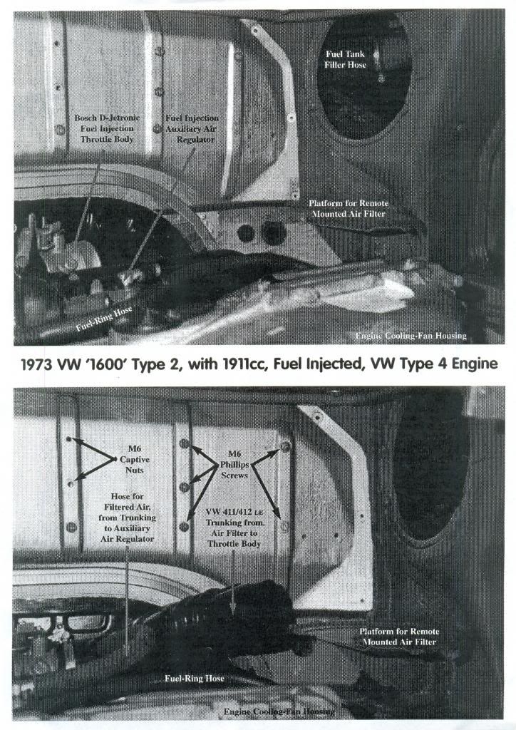

1973 VW “1600” Type 2 Engine Compartment, for VW 1900 Type 4 style engine, with Bosch D-Jetronic fuel injection
