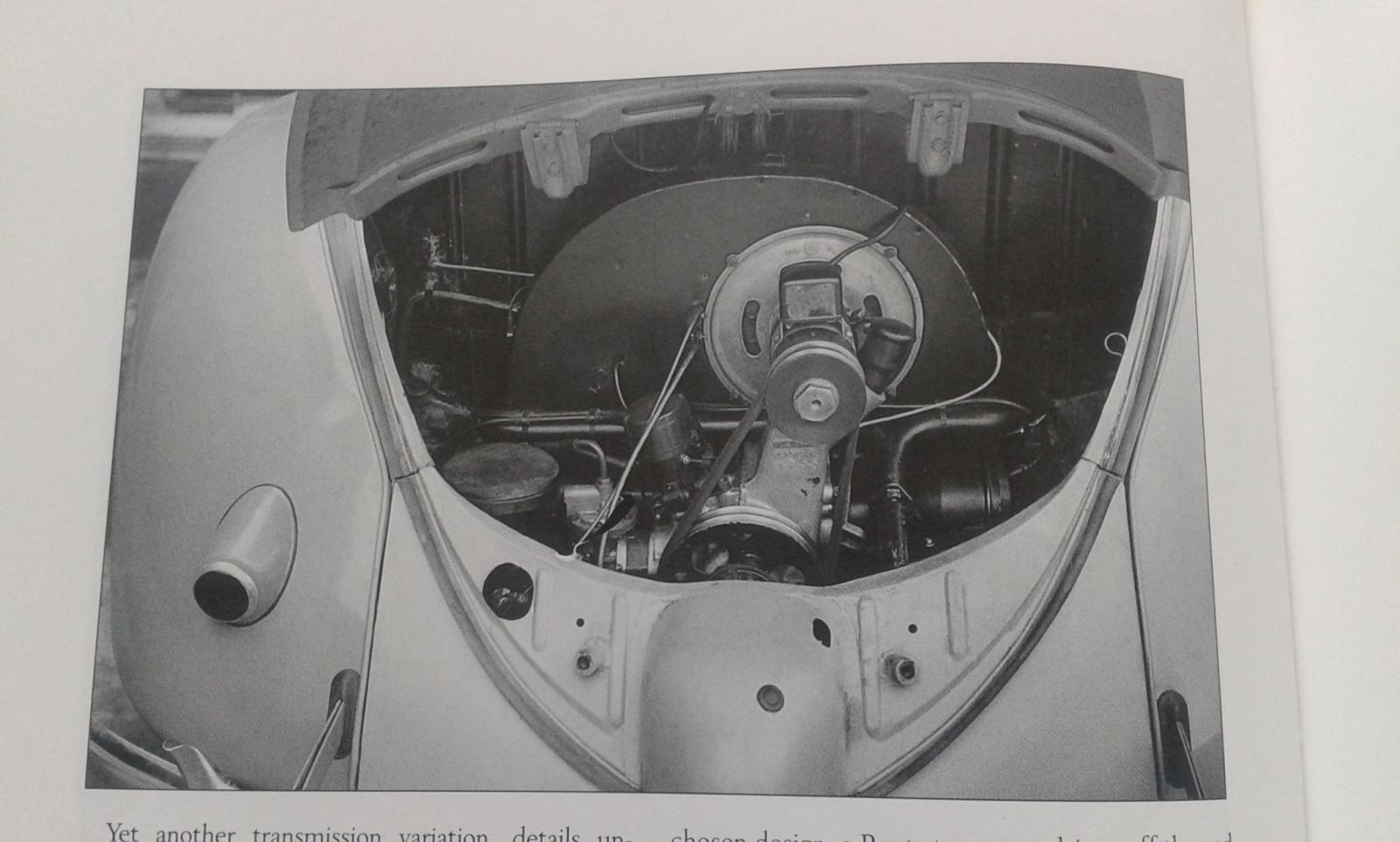

On the type 107 and 115 Barber says:
"Type 107 was antother study, but interestingly it was called 'Turbocharger for Type 60'. As far as is known, this never went beyond the design stage, possibly because a simpler solution to more power was the Type 115 - a supercharger for the VW 1.1 litre engine - wchich was presumably the supercharged engine seen in the photographs."
Here is one of the pics of the typ 115 engine:
The type 164 was indeed based on a Kubel but was never build
Type 177 is not mentioned. Type 179 was only a study according to Barber. Type 309 same story: only a design study. The other types are not mentioned if I am correct.

Barbers book is excellent! But, in this particular case I think he was mistaken. The engine in the kdf Wagen is not a type 115. It is probably a type 170 sturmboot protoype converted for car use. The type 115 was an OHC engine with a centrifugal supercharger. See my blog: http://lowlightkaizen.blogspot.com
