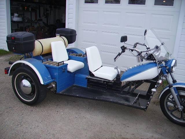

Here's the picture of his trike from his gallery...

After seeing the photos I now understand 1200 lbs of trike. I would stay with single port also. Real simple nice engine with more then enough power. Better exhaust, which allow a bit larger main jet, a good distributor timed to work with that machine and you will be very happy for a long time.
