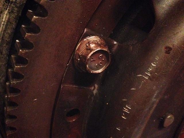

Yes the original bolts may be fine, but how many times have they been reused at this point? How many times have they been either over or under torqued? I am not saying not to reused them but one needs to do so with caution.
One can safely use a torque of around 24 ft*lbs on a 10.9 8M bolt in this application, lessening the chance that the bolt could come loose. If you could find unplated bolts for this application, so much the better.

+1 over here for not using the flange head bolts. I don't know what gorilla over-tightened them on my engine, but they must have used a breaker bar or impact wrench to install them. Eventually I needed 50+ lb/ft of torque to break each one free, and one completely rounded before I had to cut a new head onto it with a grinder in my living room...... Shocked
I think this is one of those areas where "life is too short to over think it" for me, so I always just used whatever VW told me to.
Don't think that I have ever rounded one even though I Loctite them in place and thus see very high removal torques. I do own and regularly use six point sockets which make installing and removing fasteners all the much easier.
