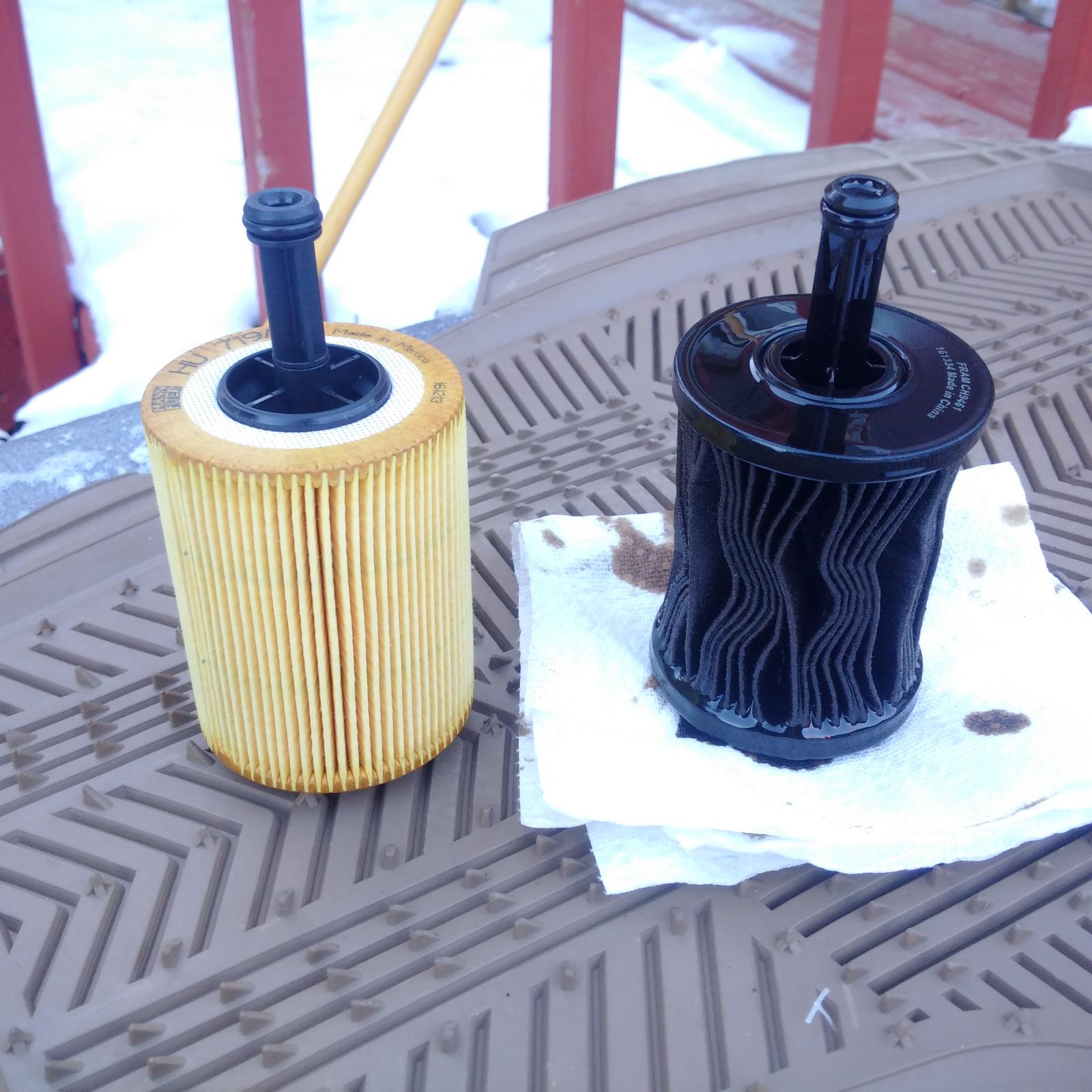

Just did my first oil change on my new to me 2001 Eurovan GLS.
When I opened the filter housing the element was mishapened, distorted and was obviously no longer working as a filter.
Old unknown filter brand (said made in Poland) beside the new Mann filter (made in mexico).
What could have caused this? Cheap filter, overdue oil change, improper installation? The quality of the filter looks to be very poor in comparison to the new Mann but I can't understand that it would deteriorate so badly.
I'm wondering if the oil change place that the previous owner was frequenting ignored changing the filter during each oil change due to the pain of removing the pan....
Yipes...

PostPosted: Sun Dec 06, 2015 4:26 pm    Post subject: Re: First Oil Change 2001 Eurovan What happened to the last Reply with quote
on looks alone I'd say it was a quality issue -- that polish one looks like the butt of a polish joke... (zing!) though the slight accordian-ing of the thing makes me think install issue as well/lazy oil change monkey...eech. glad you got that out of the way.
I guess you'll know more the next time you do an oil change - if the Mann filter is distorted then something is awry...

It kin of looks like the old one is crushed due to improper installation-like it didn't sit properly on the bottom ring?

Both of you might be right on improper installation with the crushed look of it.
Plastic caps at top and bottom were also distorted. Yipes
So strange to see when changing it is so simple....

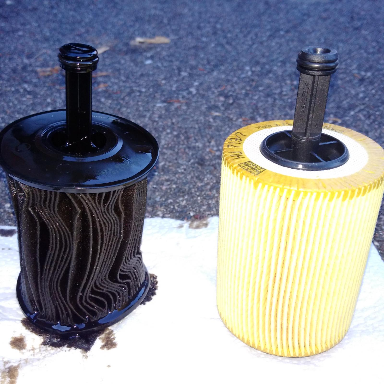

Another year, another vehicle purchase (don't worry I still have the 2001 GLS)
First Oil change on my new to me 2002 Eurovan.
Another nearly collapsed filter element. This time the filter is Fram China lol..
The filter housing was so stuck, I don't think it was opened in a long while.
Strange the next oil change sticker hadn't even reached the odometer change km..
If you are having someone change the oil on your Eurovan at least provide the proper Mann filter to them and confirm that the filter gets changed.

That snout must be removed before the oil filter is installed. The snout is only there to hold the o ring. I have no idea why VW would be this stupid, but if you don't remove that snout the filter will be crushed like that.
It's not a manufacturing problem, it's a freaking VW design stupidity.
Holy crap, I thought I was doing well using Mann filters when I didn't even do the job properly...
http://www.rialtainfo.com/vw/oil_change.htm
Special Note:On the filter for the AXK, 24 valve engine, the picture on the left below shows how the filter looks out of the box.Β  The "snout" may be removed before installation, as shown on the right, otherwise the filter may get deformed when installed.Β  Some of the cheap filters copied this wrong and the stem isn't removeable, so it has to be cut off.Β  It's only there to hold the small o-ring for the drain plug on the filter cap.Β  (Click on photo for larger version.)
I've never experienced anything wrong with the Mann filters but starting next change I'll make sure I do the filter change properly.
Thanks Copper!

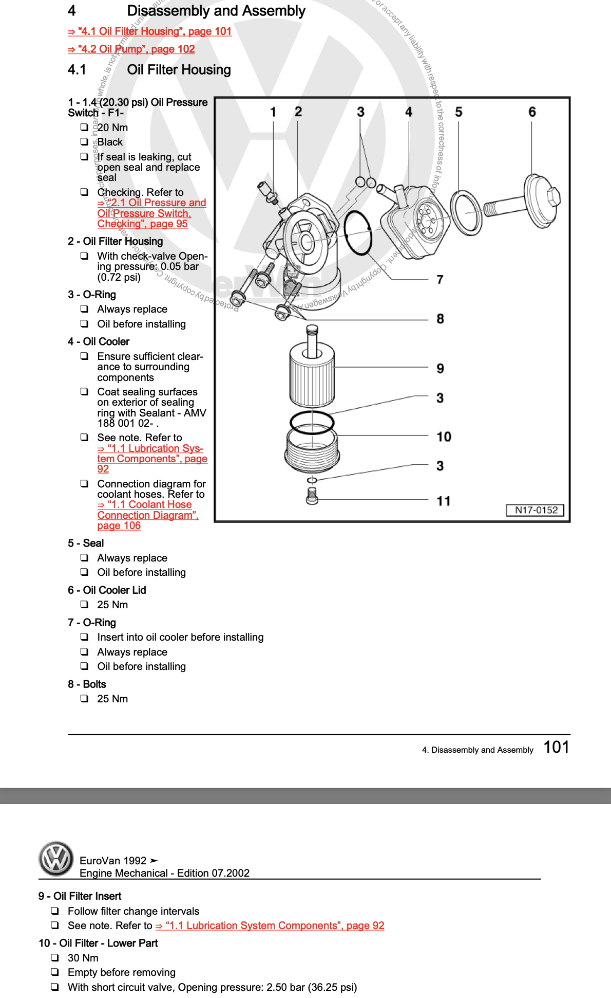

I've installed every single oil filter on my T4 with the snout, and it came from the factory with the snout. Is there any doc on this from VW?
This is what I have

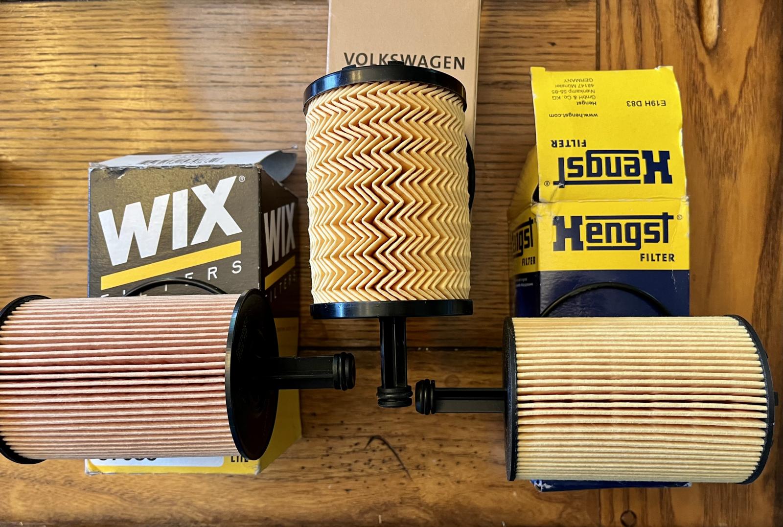

Just performed an oil change on my 2001 weekender and I reviewed this thread after pulling a slightly squashed filter (that I installed previously) from my housing.
I've installed a new Mann HU719/7X filter, and compared it with the old one. Looks different and the snout on the old filter isn't removable. In my vehicle log, I wrote a comment that the prior filter was also a Mann filter but can't find my receipt for it and it's definitely "the same" filter in overall appearance but is constructed differently.
Without attaching the new filter to the bottom cap, I inspected the filter housing and then pushed the new filter into it -- with snout on and snout removed. The depth that the filter could fit into the housing was not limited by the snout. So me thinks this is a non-issue as long as you order the correct filter!

Apologies for the slight digression - in Abscate's diagram above, what is that rectangular housing above the number 7? Is there anything there that needs maintenance during the course of an oil change?
67rustavenger
Joined: February 24, 2015
Posts: 10987
Location: Oregon
67rustavenger is offline
PostPosted: Thu May 29, 2025 9:31 am    Post subject: Re: First Oil Change '01 EV: What happened to the last filter? Reply with quote
If it's the bit with the two hose connections, it's an oil cooler.
