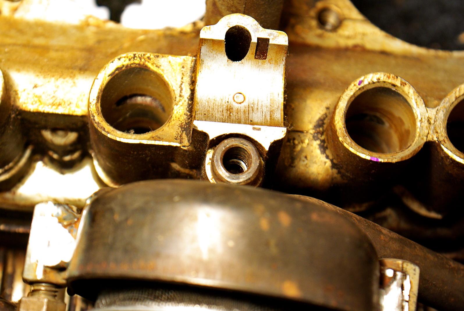

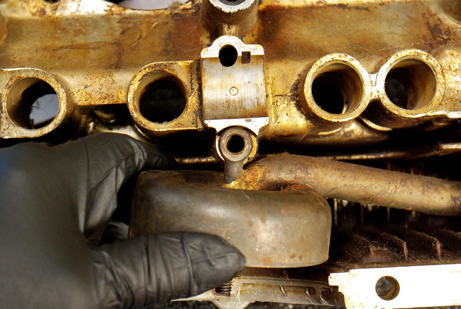

Just fitting the pickup tube in the case half and making sure the loop can exactly center on the thread bore
I used a 15mm long 8mm x 1.25 bolt to lock the pickup tube to the case half so there is no side loading on the bolt. Perfectly centered.
In this picture I am using a flat razor saw to mark the case parting line location on the oil pickup bell. Do it to both sides. You can use a razor blade or a needle file as well. Just dont screw up the case edge.
Notice these flat land areas all around the bell that you can make use of.

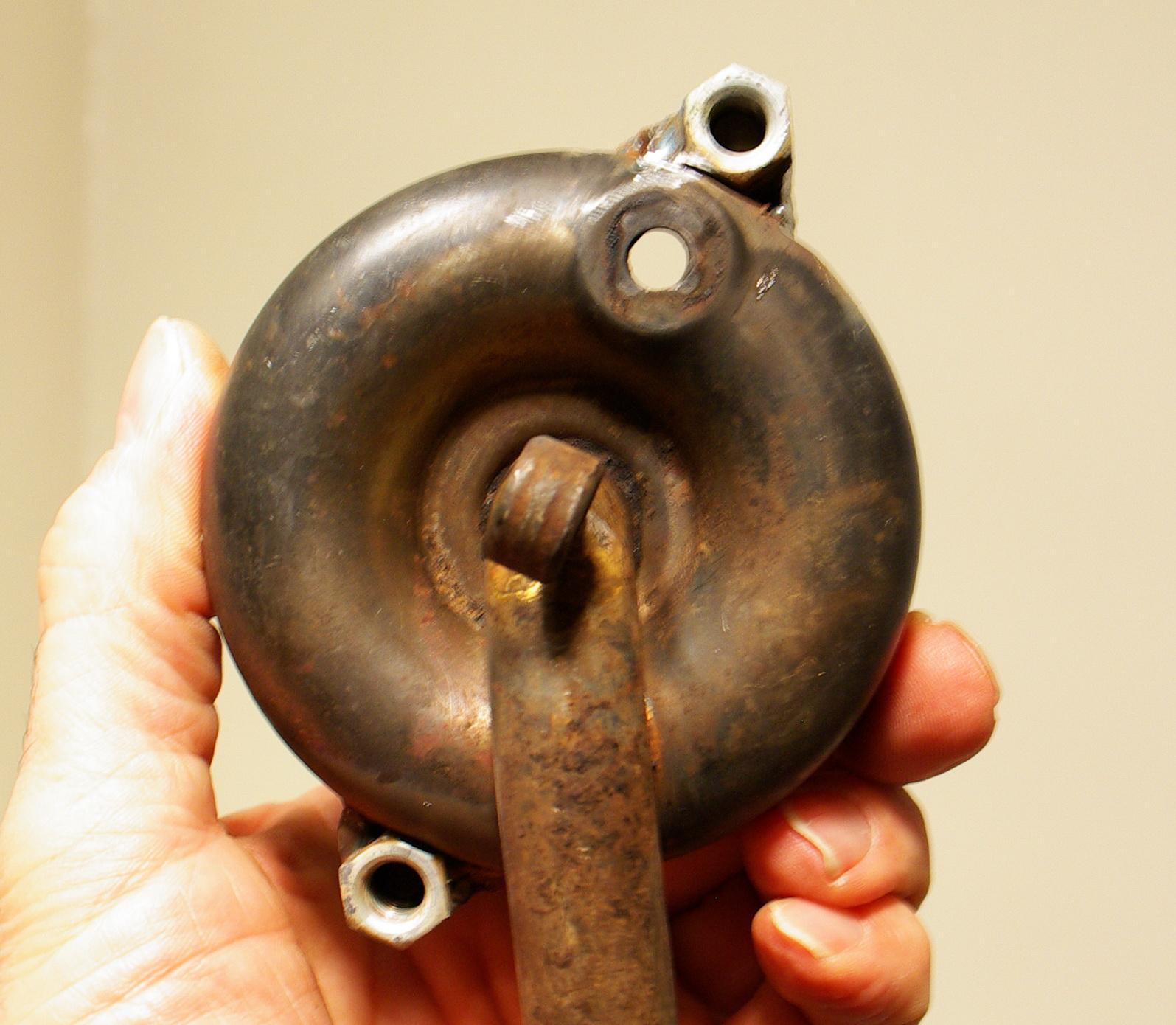

Simply put...I am going to weld support feet to the bell to hold it in such a position that the steel support loop cannot misalign and side load the support bolt no matter how much torque you apply to the strainer nut.
Ideally....one would think that four support feet at 90* intervals or even three support feet at 120* intervals would be great. But I want to block as little oil flow as possible (not that I think this will impede oil flow at all)....and because during this process I discovered how much the bell itself flexes......and because of what I saw in the picture below.....
....the fact that the bell when suspended perfectly centered on its bolt is not dead level (whether its a design feature or an oddity of factory brazing)....led me to the fact that its simpler to put two support feet on the bell right on the centerline. Much easier for reach of adjustment during the fitting process.

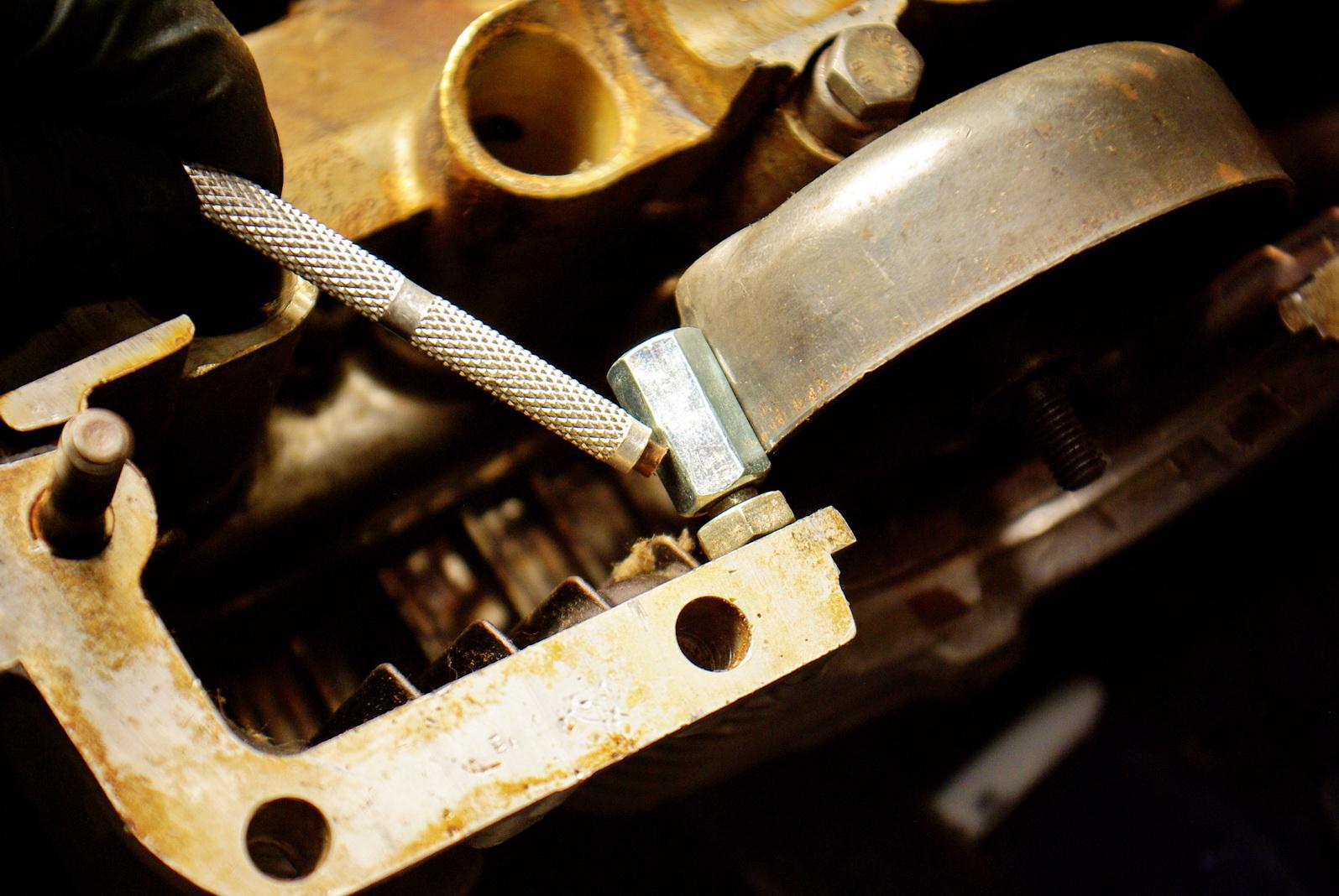

So...I am using two 8mm x 1.25 ID (13mm outer hex) coupling nuts with bolts screwed into them. You can see from the pictures where I am fitting them up...just to one side of the case parting line to make sure I know what the exact adjustment level is before I weld them on.
First clean away any zinc or cad plating with FRESH grinding or sanding rolls on three sides of each hex...one side for contact two for welding on.
And also sand the surface of the bell where you need to weld. Clean both surfaces with acetone.
Here is what the coupling nuts look like welded...the welds though they look ugly....are quite strong. I will be grinding them smooth though it does not really matter. These were a bit tricky to weld.
The bolts/feet are NOT yet welded to lock them yet. You first need to install the pickup tube in the case......install and tighten the plate and strainer ....while making sure the suspending bolt hoop stays centered exactly around the thread bore and bolt ....by adjusting the bolts/feet with a wrench. Then mark the bolt position and take the pickup tube out so you can spot weld the bolts so the adjustment does not change.

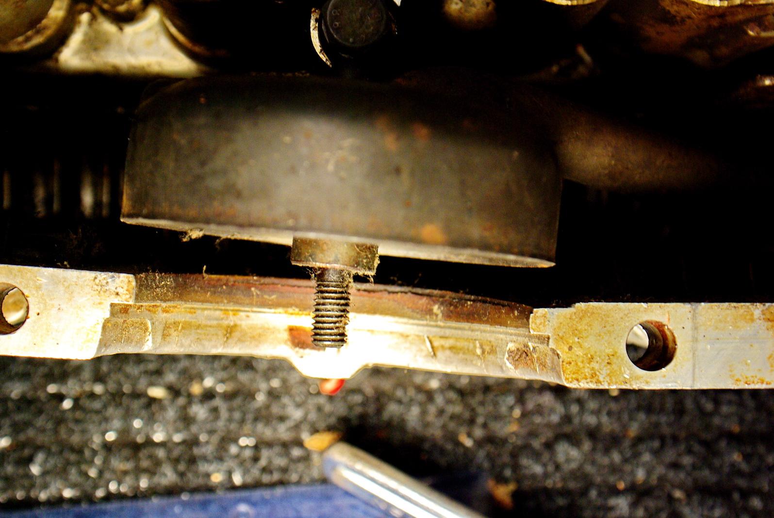

Install and center the hanger bolt and do basic adjustment of feet to make sure the hanger hoop stays centered around the hanger bolt. If the hanger bolt is nice and tight in the hoop....just bring the feet down until they touch and give about 1/5th turn more.
Its hard to see in the picture...my USB scope is elsewhere at the moment or I would have done an in-bore shot....but the "hoop" is exactly centered around the cross bore at this foot adjustment level.....giving the same amount of silver/aluminum showing all around and the cross bolt is not physically touching the hoop. You can see a little bit of silver in the bore of the hoop in the picture.
Mount the plate, strainer and gaskets..tighten...and recheck, readjust the feet BEFORE YOU SPOT WELD THEM LIKE IN THIS PICTURE....sorry...out of sequence but you get the gist..
CAUTION: do not adjust the feet much. With application of torque...and you will see this...the bell itself is stretching and defecting slightly. You want to make sure that with the strainer and plate removed....that the hoop is aligned enough with the bore hole that you do not have issues installing the case bolt during engine assembly

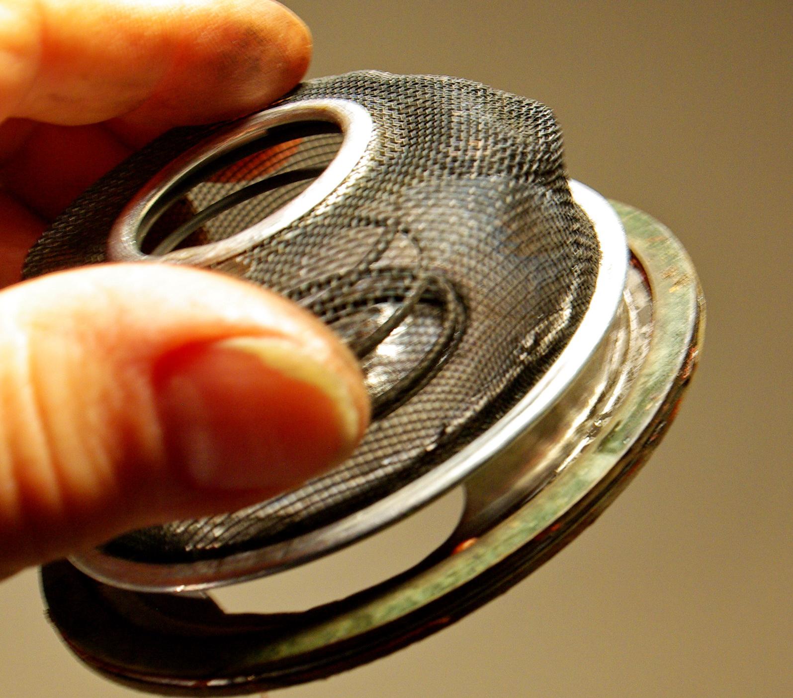

By the way...a side note. I typically RTV my gaskets on each side of the strainer. This strainer and gasket set has over 85K miles on it...never leaks and has had oil changes every 3k miles. makes installation so much easier. Its very easy to strip off and reapply if needed.
You will notice in these pictures that I have 20 ft lbs on the stack up. i just did this for giggles and grins....you physically cannot put any more than 20 ft lbs on this stack up...as the sealing washer on the nut turned to mush and you can feel the bell deflecting and see it through the case openings from the top....but the cross bolt though it has some side load on it from the deflection of the bell...is still removable but is tight.
AND.....in NO WAY DOES THIS PLATE ASSEMBLY REQUIRE MORE THAN 10-12 LBS. TORQUING TO 20 FT BS WAS JUST A DEMONSTRATION TO NOTE THAT OVER TORQUE WILL NO LONGER WRECK THE CASE.

Hi, I have a rebuild in at the moment, it has a cracked boss, The sump nut must have been torqued too much which has pulled the boss down and cracked it both sides, question is can it be welded without causing the cam journal and follower boss to move out of place.
raygreenwood
Joined: November 24, 2008
Posts: 23480
Location: Oklahoma City
raygreenwood is offline
PostPosted: Thu Jul 30, 2020 12:35 pm    Post subject: Re: Type 4 case "syndrome" safety modification Reply with quote
Its a crap shoot...50/50 in my experiece.
This is precisely one of the uses of the modification in this thread. If when the case is bolted together...you have no light/gap between case halves at the cam bearing boss...you do not even need this bolt....so no point in repairing it.
The cross bolt is "mainly" the suspending and locating point for the pick up bell. Being as long as it is and with the milled gap for the loop on the bell....how much compression/clamping it is lending to the case is a question.
The mod in the thread turns that cross bolt into just a centering and locating point and takes all of the load off the bolt. Ray

We'll. I'm welding legs to the oil pick up. Using the original pick up pipe boss as a locator with a counter sunk screw to bolt in to the boss with very little torque, and then drill and tap for a 1/4 plug the opposite case half cross bolt hole so I can plug it. They often leak oil from those cross bolts
