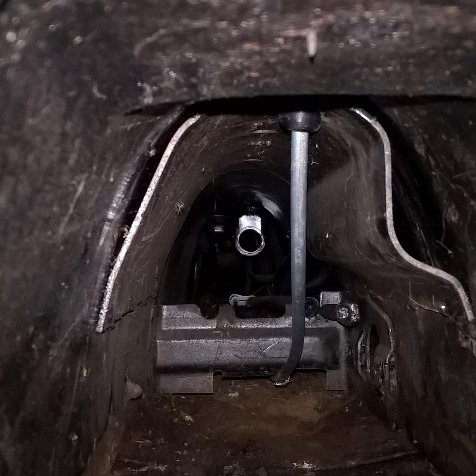

While I have the gas tank out, to install a new VW Thing front beam, I opened the front inspection cover and found the fuel line is wet/shiny around the front retaining clip.
I bought the car back in November, and when I got it home I could smell gas. It may have been coming from the carburetor, but after seeing a wet/shiny spot on the fuel line, I have to replace it. I already cleaned out some sand and grit, and installed a new outlet pipe and plastic strainer on the gas tank.
After reading a bunch of threads on gas line replacement, I decided to take the advice of "clrrer"' ... " I took a 4 ft long piece of 1/4 inch square steel tube, from Home Depot, and hammered the end flat. I reached through the front access hole and bent the strap open with it. Be patient."
Since I have a pry bar, I decided to try it before going out and buying the square tube. It worked !!!!!
I'm gonna take this job slow and methodically, but will try to take pictures (Sorry, It's a cell phone camera) along the way since this is an intimidating job (At least, to me it is)

Photo looks like somebody been in tunnel before, whole top section looks like a new/fabricated (non-stock) piece....

Yeah, I didn't expect to see the "extra" metal inside the tunnel either.

The front beam frame head looks normal from the outside.
Not sure what the extra iron is for.

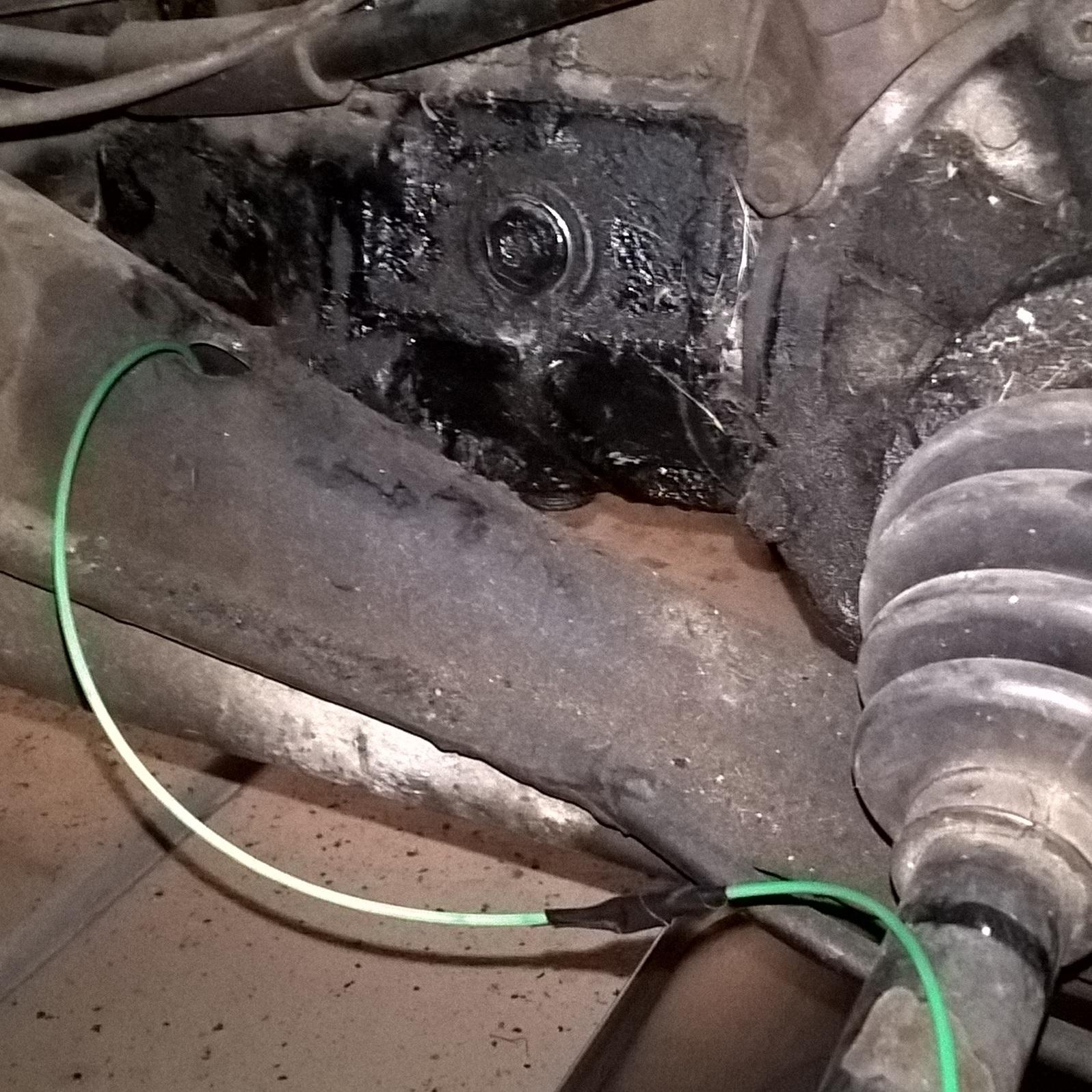

I took a picture through the rear shifter coupler inspection window. It's pointing toward the left rear of the car below the torsion tube.
I believe that's the emergency brake cable tube on the left, and my front to rear fuel line on the right.

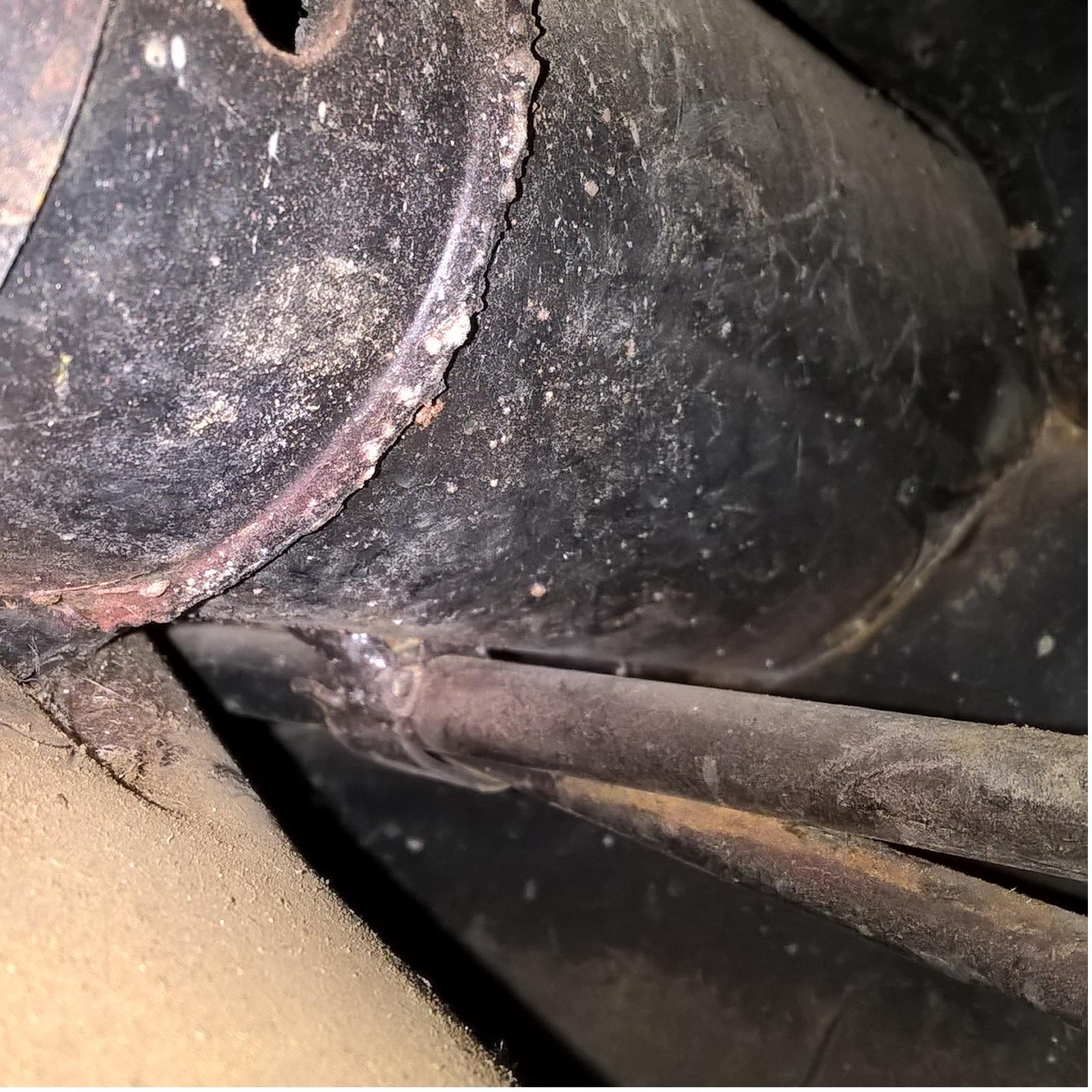

It looks like the emergency brake cable and fuel line are both captured by a continuous loop tacked to the pan. I can't really see or get a picture of the back side, but it feels like one continuous piece.
I believe I have two options ...
1) Die grind or saw the loop in two, just below the weld, pry the loop apart, and replace the line inside the loop (like the original). Then tack the loop back together
Or ...
2) Leave the original fuel line together with the e-brake, cutting the majority of the fuel line out leaving as little as possible to stay clamped in the loop keeping the clamped e-brake cable in place. Then just tie the new fuel line to this original e-brake/fuel line assembly.
I'm gonna try to pry the rear loop open, hoping it has a split on the side I can't see or feel. Otherwise, I might just go for option two, since I can't even see the weld. I could use a mirror to die grind and weld, but I'm not so sure it's even worth it.

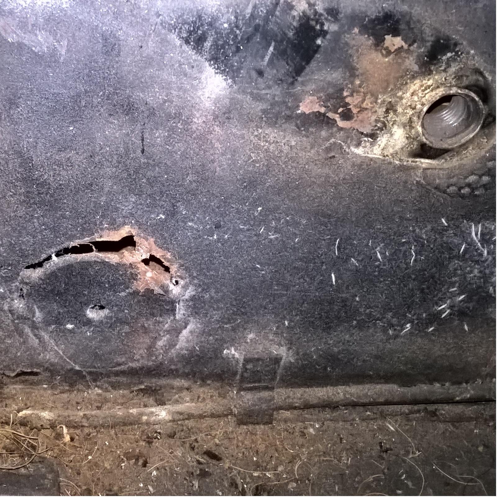

Me thinks your pan has been worked over in past as some of what you show (weld on torsion bar tube) does not look like what I have encountered opening up pans to shorten chassis for dune buggy bodies....

Thanks Dale. I think you're right. I just found a hole-saw cut-out on the drivers side tunnel between the e-brake and the seat belt mount near the floor, that's been welded back in. I'm guessing there's another clip around there. I'm gonna remove the circle they welded back in and have a look inside. I want to make a more solid cover for the hole since they blew holes trying to weld the gap up. Every time I start looking around, I see stuff I need to fix. I better stop looking around Lol

I guess there's more than two options ...
I just cut off the line at the rear frame horn and pushed it through the horn, and cut the line off at the rear shifter coupler opening and pulled the short piece of line right through the loop, cutting short pieces off as more came out. I'm not sure I'll be able to get the new line through the loop so easily, but I'm happy I got a small piece of the entire line out.

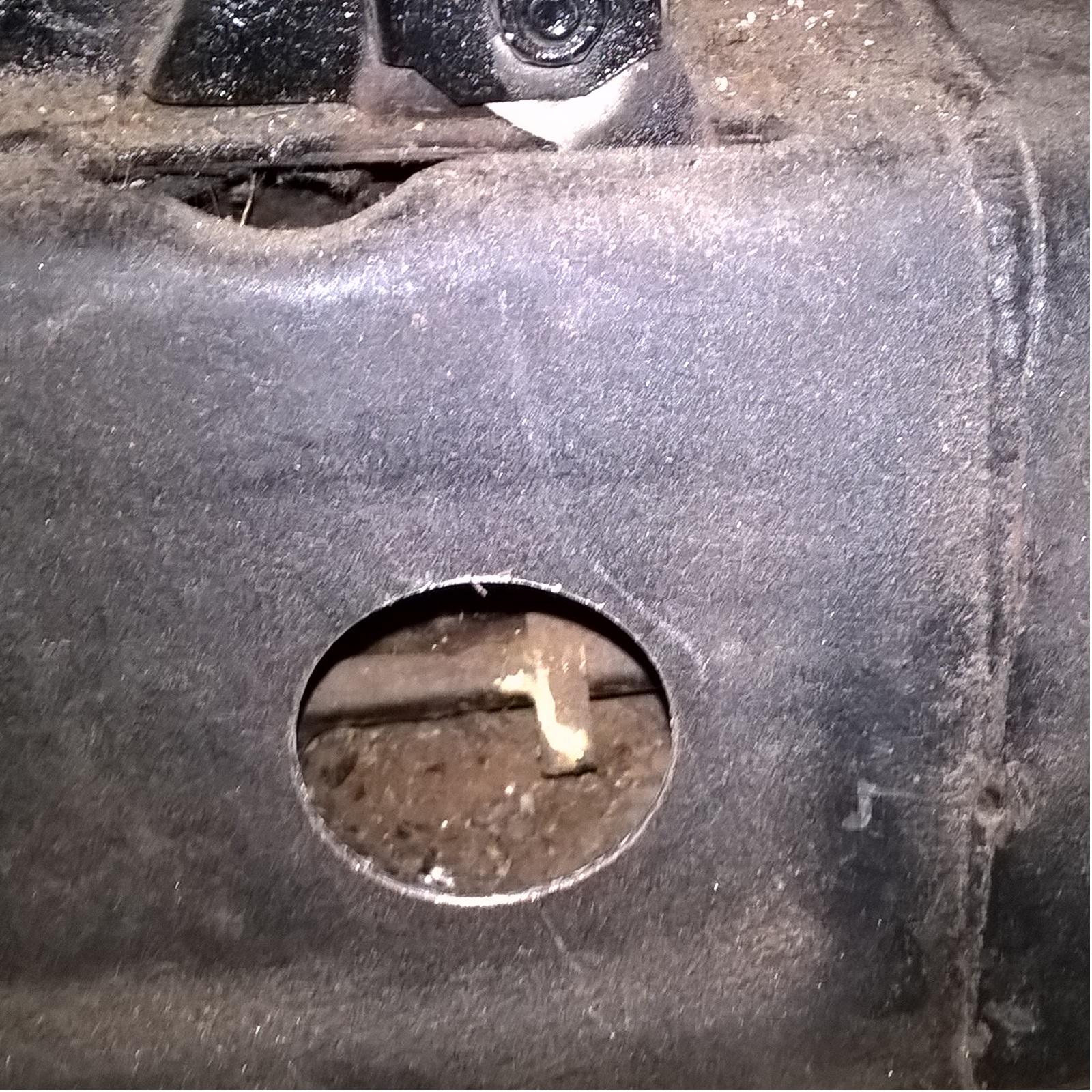

Here's a picture of the hole previously cut and welded in the drivers side tunnel.
I'm gonna re-cut the hole with a hole saw, poke around with a telescoping mirror to find out what's holding the rest of the fuel line from being pulled out through the front access hole, and eventually make a tighter fitting hole patch to weld back in. I'll grind it flush and paint it since I don't plan on doing the fuel line again anytime soon.

So, I got a hole saw to match the hole the PO cut in the tunnel.
It didn't reveal anything except a clutch cable tube repair made previously. The original bracket broke, so the PO made another bracket and welded the tube to it.
Curiosity got the best of me, and at the risk of being called a butcher, I opted to make another hole saw cut on the passenger side. ( I'm gonna weld the holes back up )
I was able to see my fuel line clamped/brazed to the clutch cable tube.
I wanted to cut a dozen more holes in my tunnel (I'm kidding), but decided to just stop right here. I just cut the line off as short as possible through the PO hole saw cut.
And, through the shifter hole, and called it good.

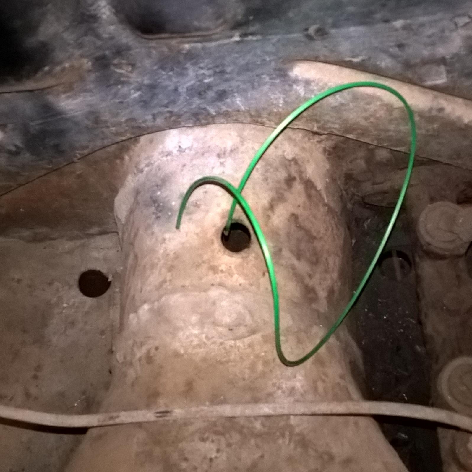

I started at the rear frame horn and fed trimmer line in.
I made sure the trimmer line went outside of the welded together clamp at the rear torsion tube.
I pulled it through the shifter coupler access hole.
I then pushed the trimmer line forward until I fed it through the front frame head.

I then taped the trimmer line to mark how long I want the fuel line to be.
I then pulled the trimmer line through the front access hole until I got to the taped trimmer line mark. I measured the trimmer line in front of the tape and got about a ten foot measurement. I straightened out about eleven feet of fuel line and cut it from the 25 foot roll. I used this tool to straighten the line out.
I now have about 11 feet of trimmer line inside the tunnel and 11 feet of trimmer line outside of the tunnel. I fed the 11 feet of straightened out fuel line over the trimmer line and folded the trimmer line over the front end of the fuel line and taped it.
I taped the end going into the tunnel also. Now I just started pulling the line through, using the trimmer line and kinda guiding it by hand through the different access holes I have.
Soon, I had it at the frame horn.
I checked it at the rear torsion tube.
I cut the excess off and fed the fuel line through the frame head.
