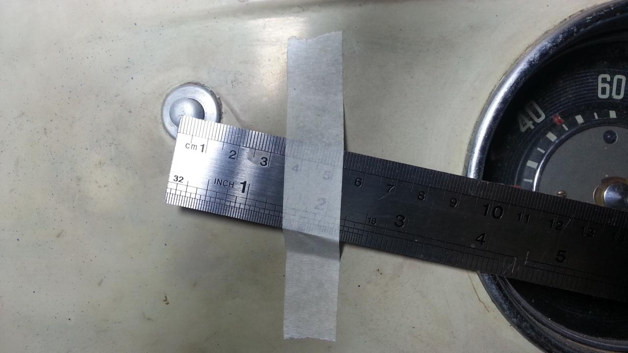

PostPosted: Fri Jan 22, 2016 7:06 pm    Post subject: Re: Zwitter starter button location Reply with quote
Important notes:
- look that the speedometer is installed;
- for the first pics, the starter button is installed, too;
- so, the rule was slightly arched, touching the starter button, the trim ring of the speedometer and near the speaker grill hole:

PostPosted: Sat Jan 23, 2016 9:34 am    Post subject: Re: Zwitter starter button location Reply with quote
Perfect,thanks Capriacci really appreciated . Smile
These measurements will be useful in many cases where a larger starter button or gauge meter was fitted in that place.
It may take a while until I do the repair to my car and post some photos but the basic idea is to use a thin wire bend at point A and the sides A to B and A to C of the wire at the lengths kindly supplied by Capriacci and then hook the two edges of the wire to points B and C respectively,eventually point A of the wire will saw the center of the starter button \ hole.

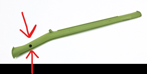

PostPosted: Wed Aug 23, 2023 8:39 am    Post subject: Re: Zwitter starter button location Reply with quote
v6-star wrote:
Does anyone know how big the Heater Channel hole is on a Zwitter and a few measurments on where its centered? I just replaced my heater channels and they were rotted out before hand so I dont know the measurments. I also used different ones then the ones in this picture. Opps. Thanks in advance.....
