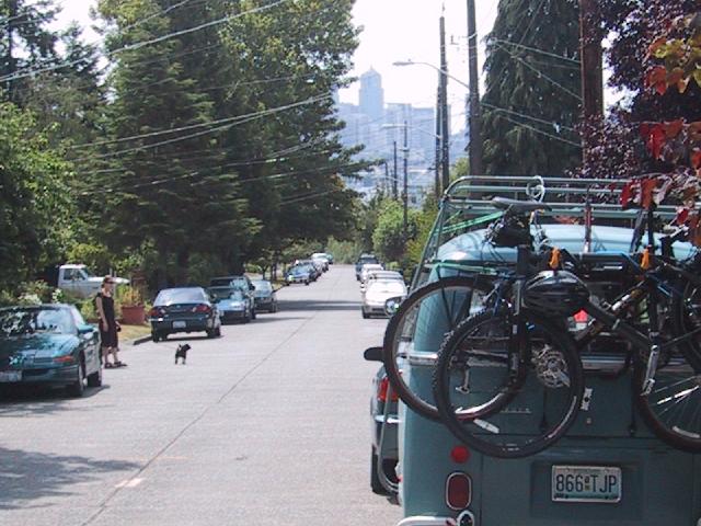

I use Yakima racks for my bikes, canoe, surfboards etc.... Expensive but definitely secure and utilitarian. I'll look for a pic...

another pic from kevinMc:

The rack to have in the hatchback style is the Hollywood. Runs about $60 at your local bike shop. I have used both it and the Yakima roofrack. Yak was great when I lived in the city and had to worry about what happened when I parked (theft, parking by Braille) but an absolute bitch to get them on and off when on top of a Bus. You may be taller than 5'8" and have less trouble.
The Hollywood will hold three bikes if you're careful getting them on and they're not all beach cruisers. They will get some dings from each other.
The bikes (or surfboards) only go on a rack if there's too much stuff or people inside the Bus. I've gotten five guys and their mountain bikes inside if that was all that was going in.

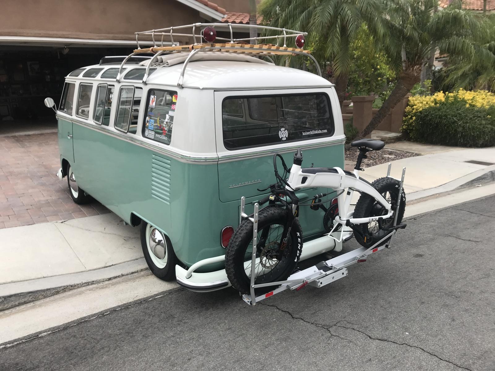

I move my bike around a lot. Many racks later I found an American made Mega strong rack made by 1UP. This is the heavy Duty rack. You can carry 2 heavies or 3 lighter bikes, they even have a Cargo box "add-on". The rack steps Up as you add more rails so bikes will not rub another. This one is RV ok also, and few are that good. Very mechanical looking and just the best built Hitch rack any where. Very nice anti wobble too

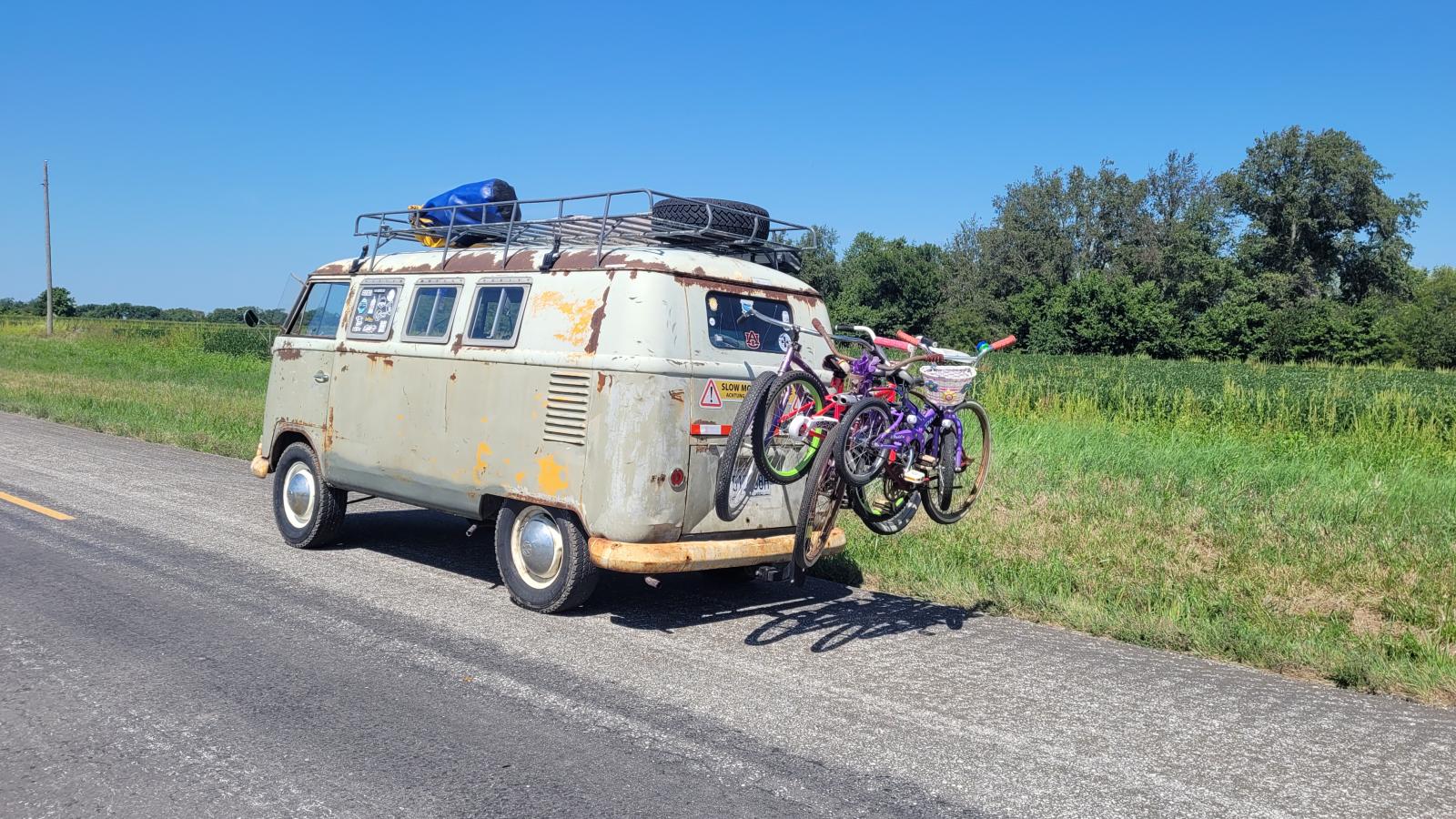

A standard bike rack has worked well for me for a single mountain bike over long distances. Multiple bikes make such an arrangement less secure so I switch to alternatives. In our recent trip, the two mountain bikes lived inside and had to be extracted at each stop. It was a hassle at times.
You can see a single bike on my bus in this busy picture.

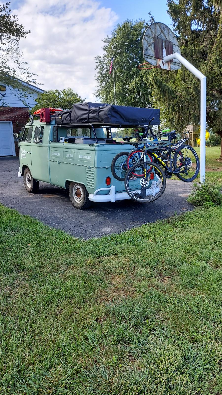

I purchased one of the excellent receiver hitch,bumper bracket set ups from user:jeremyrockjock....a very nice sturdy product.
I then scored a like new 4 bike hitch mount bike rack locally. Her it is holding our 4 bikes on the rear of the old '59 mango trailer bus on our way home from this year BNNTA campout
